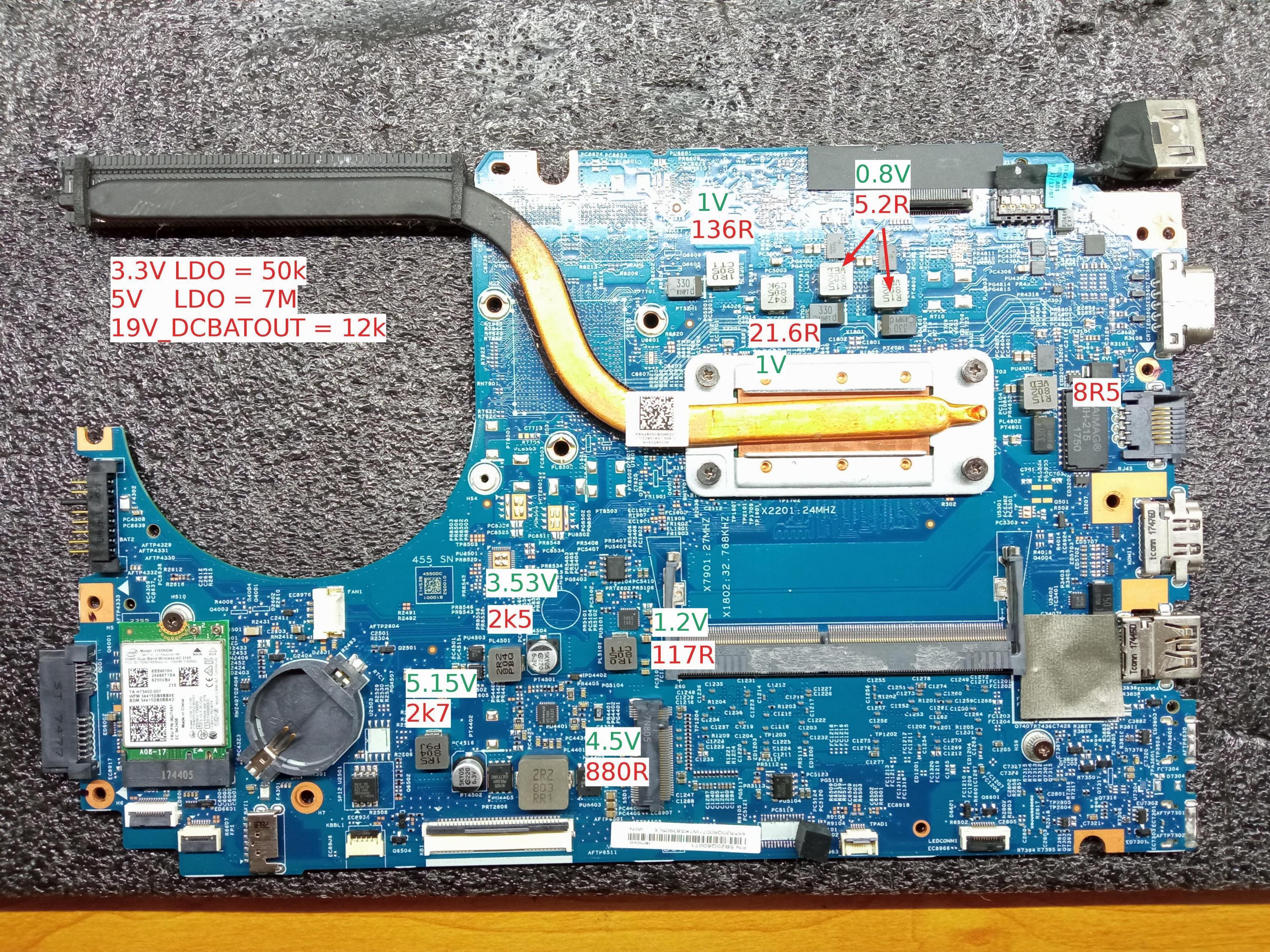

    Greetings badcaps community,
    I would ask for little help with diagnosing Lenovo V330-15IKB, which I got as dead - after pressing the power button there was no reaction, just dead.
    Model: V330-15IKB
    Board number: LV315KB ; 17807-3 ; 448.0DC04.0031
    Serial number: R90Q6BW3
    (Schematic, boardview and resistances/voltages attached)
    When I got it, battery had 0V, so I am diagnosing it without battery, with original lenovo charger. After some searching, I managed to make it run by reflashing the bios - but I have no picture ( even on attached monitor ) and no reaction to caps lock/num lock on external keyboard. On the laptop keyboard, there is capslock diode ON all the time. I tried many bios dumps, but the result was still the same. I am using this one at the moment --> https://www.badcaps.net/forum/showth...p+%28Lenovo%29 ( post #2 ).
    Next, I tried to disable onboard RAM, by moving resistor R2010 to position R2009 - datasheet page 20, and this post helped me too --> https://www.badcaps.net/forum/showthread.php?t=100557 ( post #8 ). Still same result.
    So I am out of ideas, and I would like to ask you guys, with more experience, how can I figure out, why it is stuck? Is there anything, I can try? Or it is dead cpu/pch ( bad solder joint maybe )? If it helps, I was able to measure these signals:
    PLTRST# = 3.5V
    DDR4_DRAMRST# = 1.2V
    THERMTRIP# = 1V
    There is no voltage at one coil ( PL4803 ), with power rail 1V_VCCGT, I believe, its not necessary, since its igpu, right?
    Thank you very much for any hint.

      CORRECTION in the picture: the coil for main power rail is not 4.5V, but 9.6V ( 4.5V was before flashing bios, when the laptop was dead ).
      Still, is it enough to be 9.6V at 19V_DCBATOUT power rail? I mean yeah, if there is battery connected without charger, there will be only ~8.7V here, but still, I am not sure ( datasheet, page 44 ).
      @reformatt - sadly, I am not able to measure current. I was trying to do it with an oscilloscope, across current sensing resistor PR4401, but I can't read any value. RAM connector is indeed clean and intact.

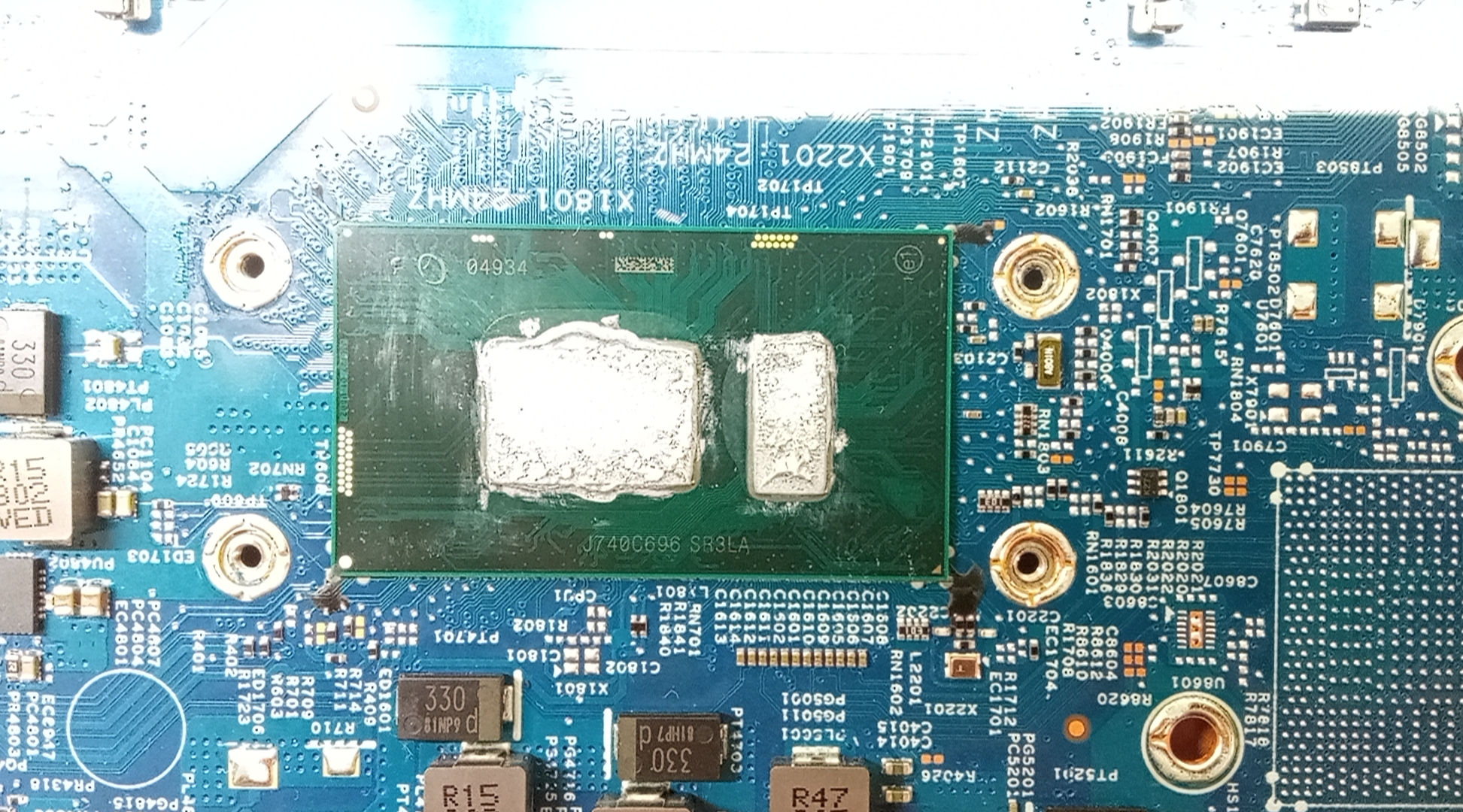

              Could you post a picture without heat sink please.
              • YellowJacket
                • Dec 2020
                • 105
                • Slovakia
                Re: Lenovo V330-15IKB - no picture
                Attached. ( I was trying another stuff, so I decided to allow onboard RAM again, since it behaved the same. Just saying that, because on the photo you can see resistor strap on that place ).
