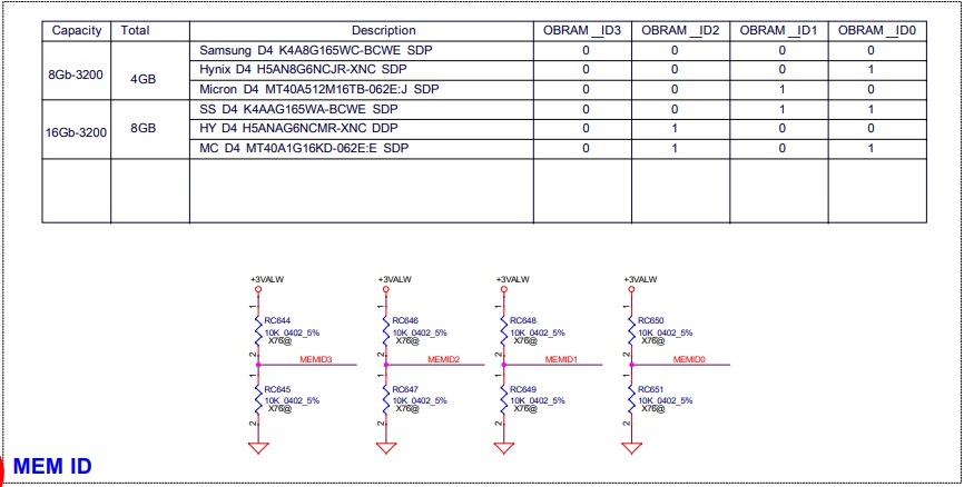

    Hi all
    I have an Lenovo Thinkbook 14 G2 laptop with no picture
    when pressing the power bottom the ESC and Caps lock led are on then the Caps lock goes off and ESC stays on but with no picture
    earlier it startup but freeze at Lenovo logo
    All voltages are present so I suspect the onboard ram
    I flashed a disabled onboard ram Bios but with no success
    There is a memid section on the schematic which I believe it concerns about the onboard ram
    but I don't understand it
    Anyone could help me with this issue is appreciated
    (attached the memid part)

    No one has any info ??
