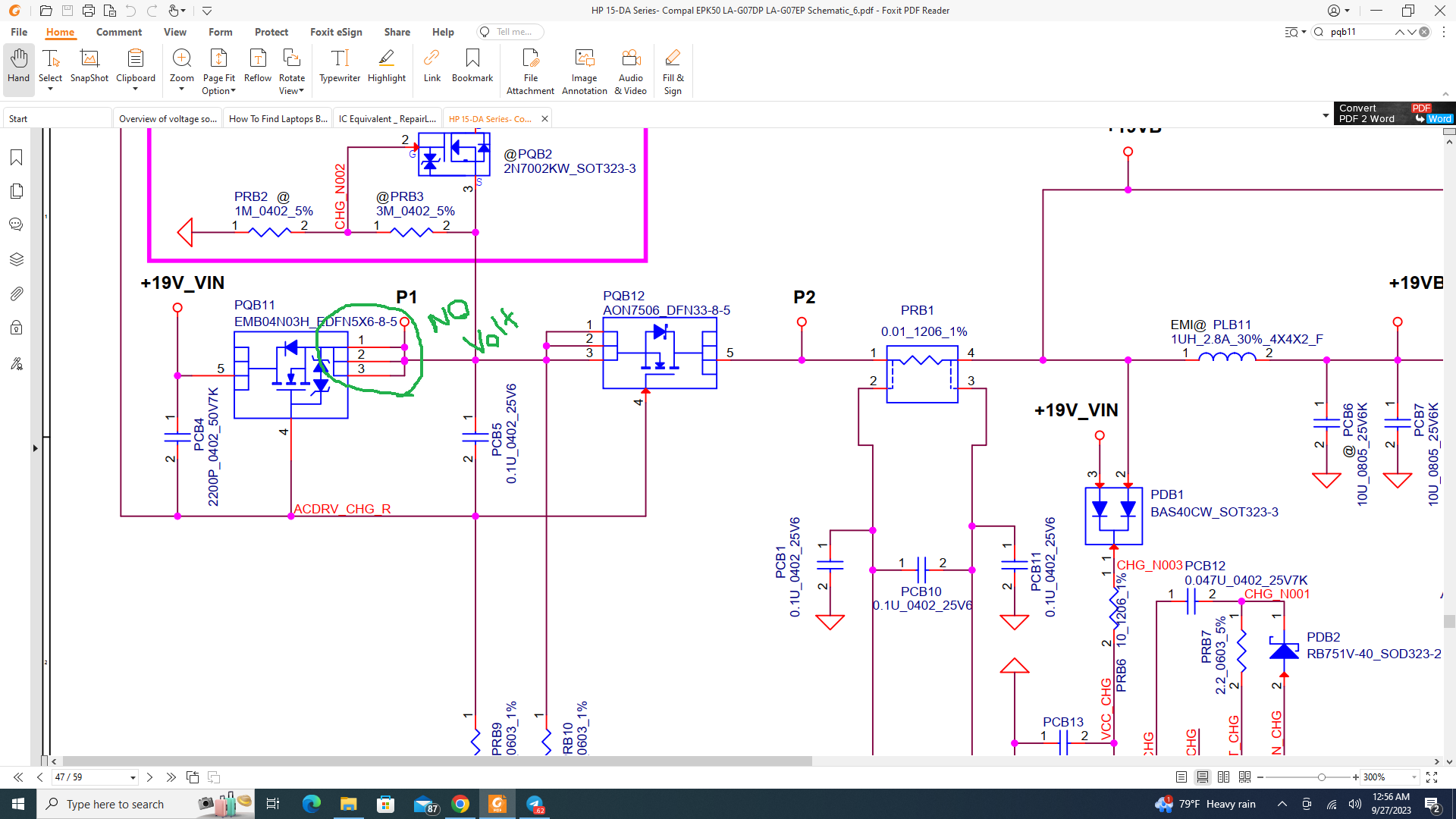

Help me 19V is missing on mosfet on LA-G07JP rev 2.0
  • kotar
    • Feb 2017
    • 19
    • MYANMAR
    I change the same N ch mosfet nothing happen and i also change Charger ic nothing happen when i jumper Pin 5 to pin 1 19v Comes out and also 3V and 5V comes out power switch can on but 0.044 amp on DC Supply where can i check please

    Your ACDRV is missing GATE voltage must be high 22-28V+
    Check resistance ACDRV CHARGING IC
    Check resistance Diode mode
    Source-Gate
    Source-Drain
    Gate-Drain
    of both the dc-in fets
    Voltage on PDB1 3 pins
    Uploaded the schematic in Schematic section

      Besides following the suggestions by @techtiger, report back on status of ACOK/ACDET

        replace both mosfets. if one is bad power will not pass first mosfet
        and as it is HP u will need to check function of PS ID circuit
        as u r using PSU that way it will not work if u dont have right resitance custom power cable

          Hello sir, PDB1 Pin no.1 has 19v Pin2 has 1.2v ?? Pin 3has 19v Sir

            Thanks Sir now i check as you say sir, PDB1 Pin1 has 19v pin2 has 1.2v pin3 has 19v sir ( the coil PLZ3 has shock to ground sir )
            ACDRV resistor (PRB9) has 4.1K sir
            DC IN Fets PQB11 and PQB12 were good
            Where do i check sir

              ACOK=0V
              ACDET=2.6V sir

                  test the PQB13 SDG diode modes and PRB1 diode mode, and upload the measurements. Also, check the voltage of PUB1 pin 16
                  • kotar
                    • Feb 2017
                    • 19
                    • MYANMAR
                    Re: Help me 19V is missing on mosfet on LA-G07JP rev 2.0
                    pqb13 S to D = open, S to G = open, S to D = open
                    when remove fet and test S to D = open , S to G = open , S to D = short with 0 (Buzzing sound)
                    PRB1 with diode mode = 0.00 and (buzzing sound)
                    PUB1 pin 16 = 5.92 V
                    what should i do sir
                    Thanks for helping me sir
