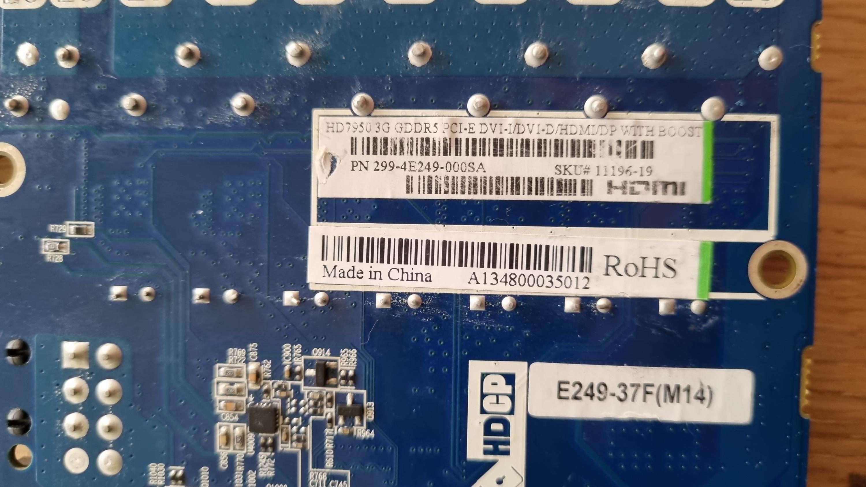

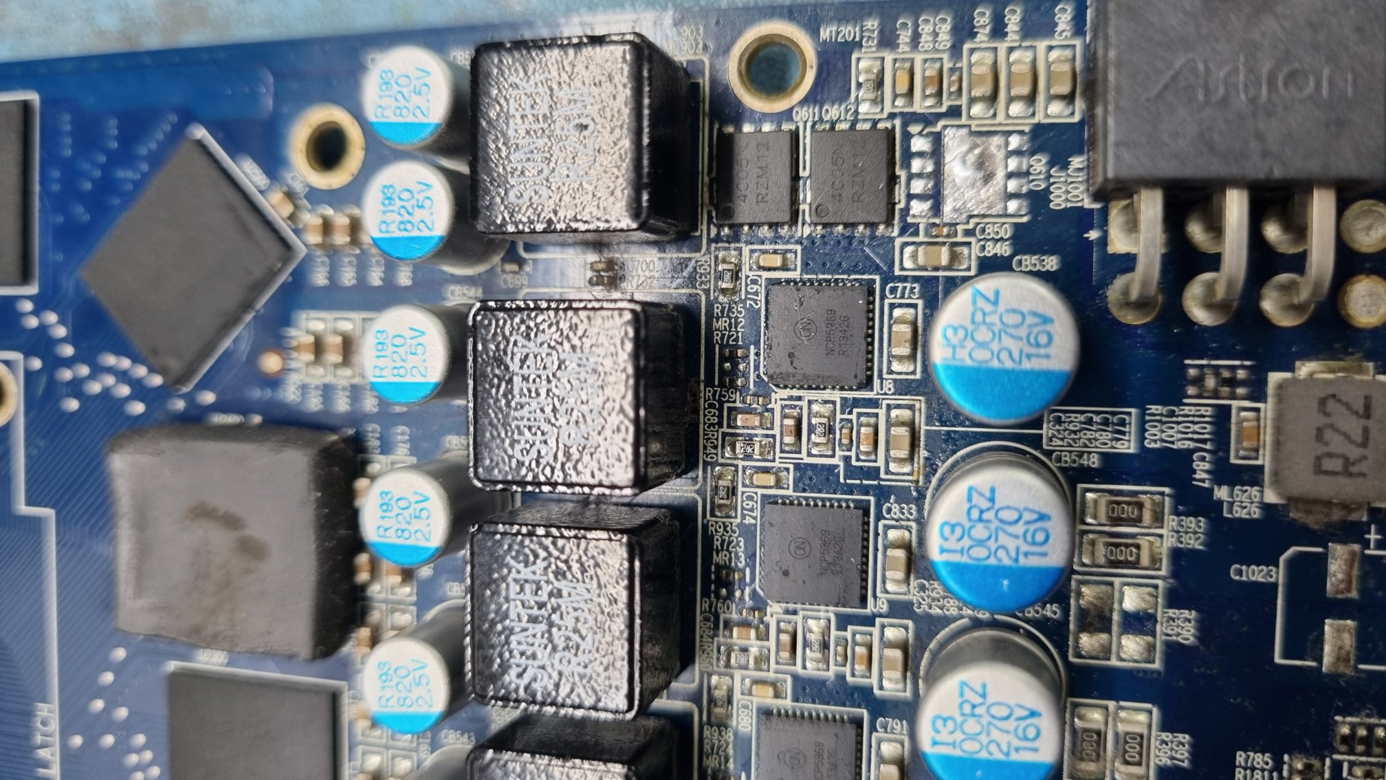

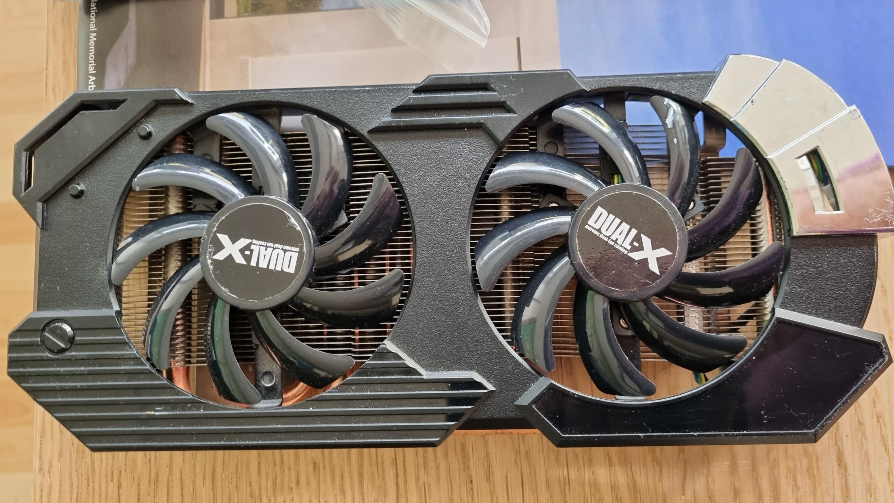

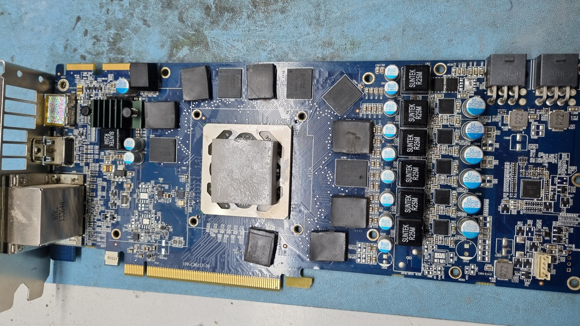

    i guys I have this Dual X Radeon HD7950
    All the resistances check OK (and all other voltage rails are up) but I have a missing High side mosfet on the Vram VRM so that rail is down of course. Resistance on Vram is 60 ohm which is just fine.
    Does anyone know what the missing component should be?
    See pics - and thanks

    Re: HD7950 missing mosfet
    Is there a specific manufacturer for that card? I may know someone with that card but I'd like to be able to give all info available when asking.
        I didn't see as brand on it but hopefully these pics help?
          Maybe this Sapphire Radeon HD 7950 3GB GDDR5 PCI-E
            • 20855
            There`s a Sapphire sticker and a part number on the pcb 109-C38137-00 .Had a look for a schematic,can`t find one.
            • dicky96
              Sun Seeker
              • Mar 2017
              • 1825
              • Spain
              Well spotted - yes it's that one for sure
                Textolite with number 109-C38137-00 is the same as for SAPPHIRE DUAL-X R9 280 3GB GDDR5 OC WITH BOOST.
                  • 20855
                  Thanks for the info lotas .
                  NTMFS4C10N https://cdn.badcaps-static.com/pdfs/...3addefcd72.pdf
                  https://i2hard.ru/wp-content/uploads...0Dual-X/31.JPG
                  https://i2hard.ru/publications/21271/
                      @lotas @SMDFlea
                      Thanks guys, nice work. Parts ordered.
                      @pixcelart
                      No it's definitely as single channel mosfet
