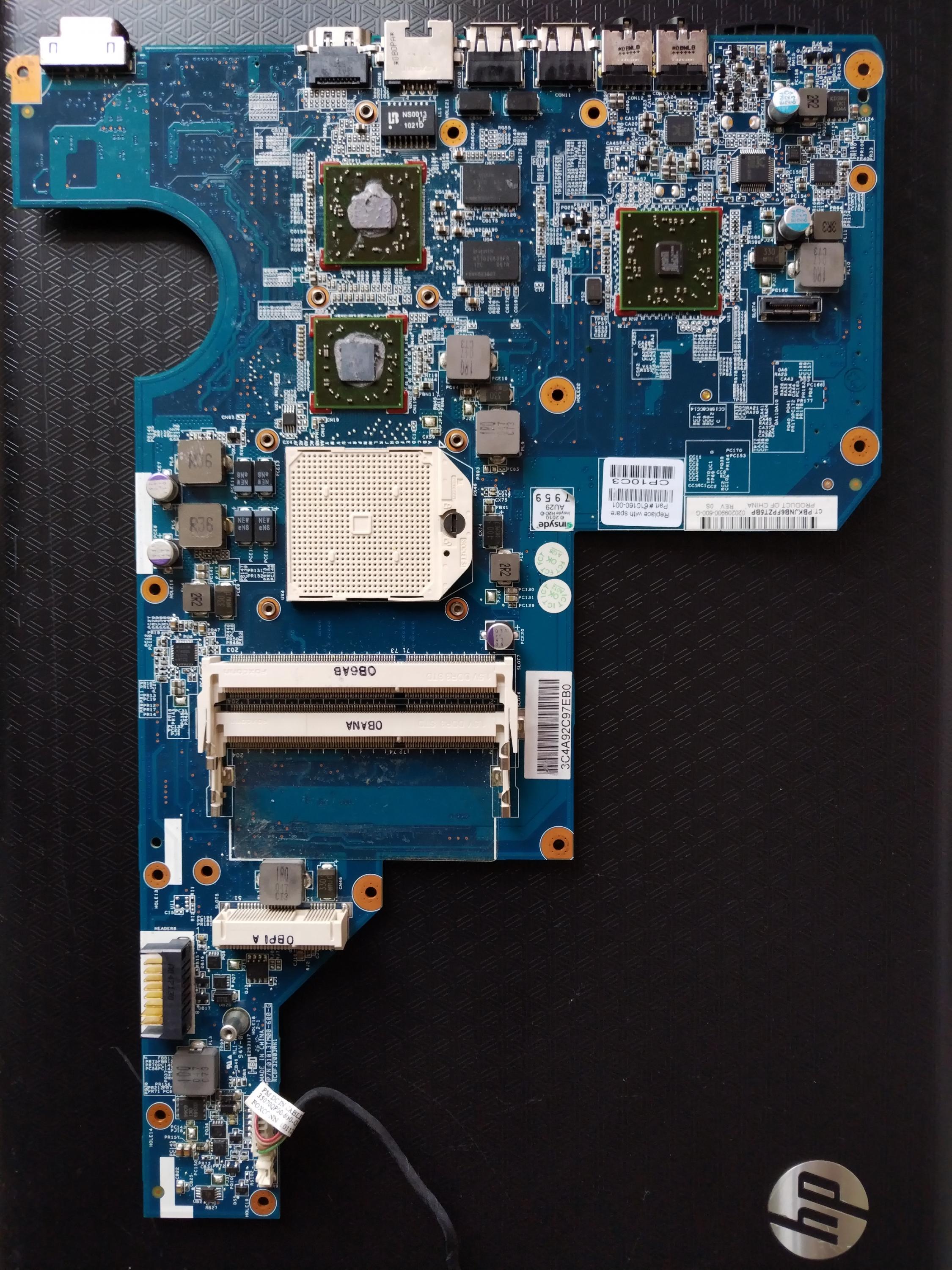

    Hello
    You can see some voltages as 3.3V, but 19V is not stabilized and rises and falls with each blink
    The Power LED button will flash and you can hear a TIC sound with each flash.
    where does the TIC sound come from?
    Thank you

    Re: HP G62 Model G62-b50SG TIC sound
    There is some short on your motherboard. measure resistance to GND on all coils as well as CLR.
      I found the problem
      PQ55 Mosfet replaced now turns on but turns off again after 10 or 20 seconds later
      PQ55
      D=9.80V
      G=19V
      S=19V

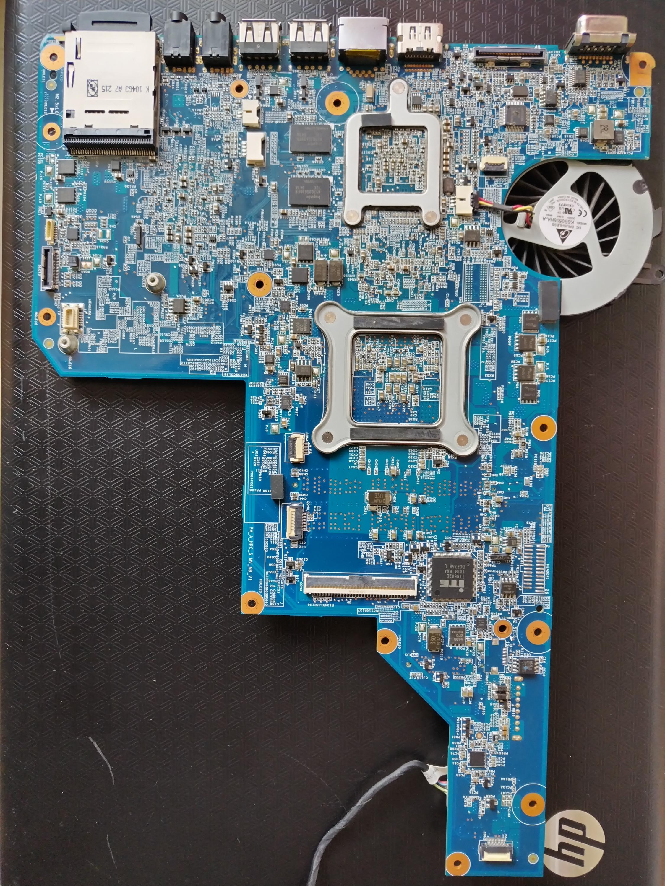

                This is the motherboard pictures
                here 3 coils beep and the values from both sides
                75,8 75,8
                13,8 13,8
                12,6 12,6
                      This board is too old to waste your time. It has a discrete amd graphics as well which invariably fails after so many years.
                          Northbridge is also well known for being unreliable.
                          Best solution is to replace motherboard (+CPU and heatsink) with an Intel platform without dGPU. There are a few Intel boards for G62 but not sure which one would fit exactly your chassis, possibly the PM_I_HPC_S MV_MB_V3.
                          Also gives better performance, battery life and less heat.
