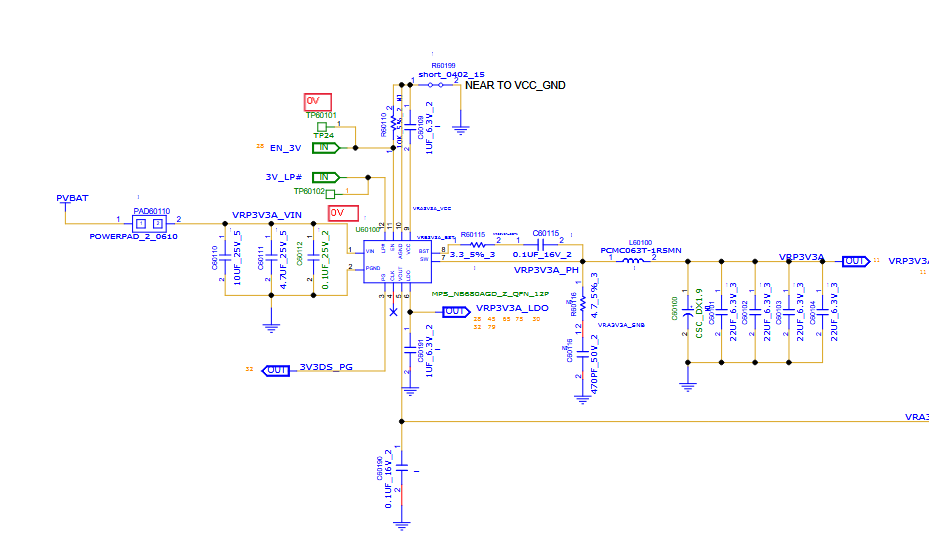

Zbook 15u G6 (PR/ID 4YW47AV) not charging

        Re: Zbook 15u G6 (PR/ID 4YW47AV) not charging
        New measurement taken
        Motherboard removed and connected to Power supply without battery
        It seems that P3V3DS is missing.
        How to trigger?
            Remove all power. Meter in resistance mode.
            Measure the resistance to ground of P3V3DS. Checking if there is a short on this power rail that may have stopped this rail from operating. If the resistance is ok then check the voltage to ground at the input of the voltage regulator that creates this rail from PVBAT (U60100). Also check if the enable for the same regulator is present to enable the power rail. Inspect this regulator for possible damage.
            • alfanikos
              • Jul 2013
              • 39
              • Greece
              The IN to the regulator are both
              1. EN_3V = 0 Volts
              2. #V_LP =0 Volts
              No in
                1. EN_3V = 0 Volts
                2. #V_LP =0 Volts
                No in
                See attached

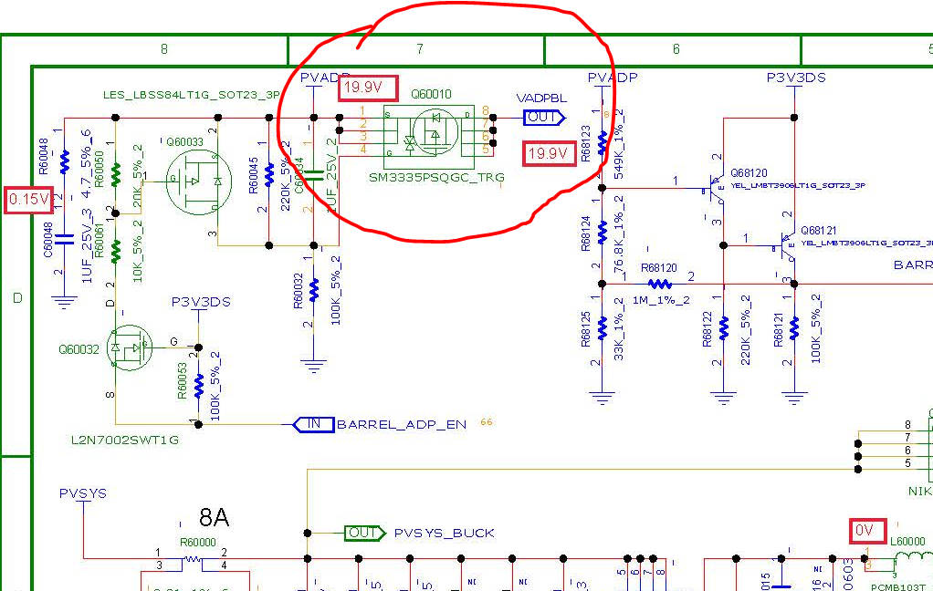

                    #29
                    @mon2
                    I have checked all the Mosfets and I found here below short circuited
                    Actually I have measured with Ohmmeter the resistance between (scale 200K)
                    1. ----1,2,3 (S) and 5,6,7 (D) 0.00 Ohm
                    2. ----4(G) and 5,6,7,8 (D) 0.00 Ohm
                    3. ----1,2,3 (S) and 4 (G) 0.00 Ohm
                    Furthermore it is a little discolored (overheated)
                    This is a SM3335PSQGC_TRG
                    Attached the Datasheet from Internet
                    Is there any equivalent or I shall to order that from Aliexpress.
                    • mcplslg123
                      • Jun 2015
                      • 7262
                      • india
                      #30
                      This is a P channel mosfet. You can use AON7403 as replacement.
