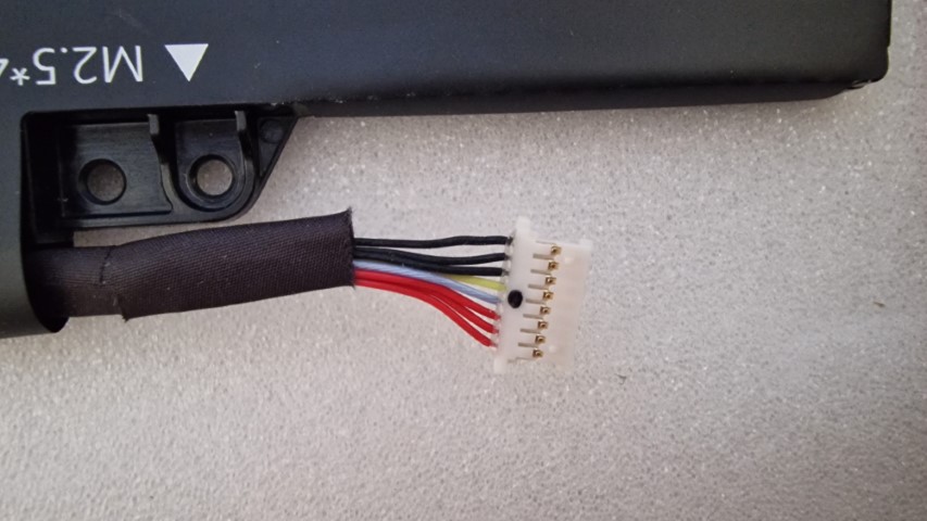

    A. Is there any way to charge the battery independently Has connector with 7 cables.

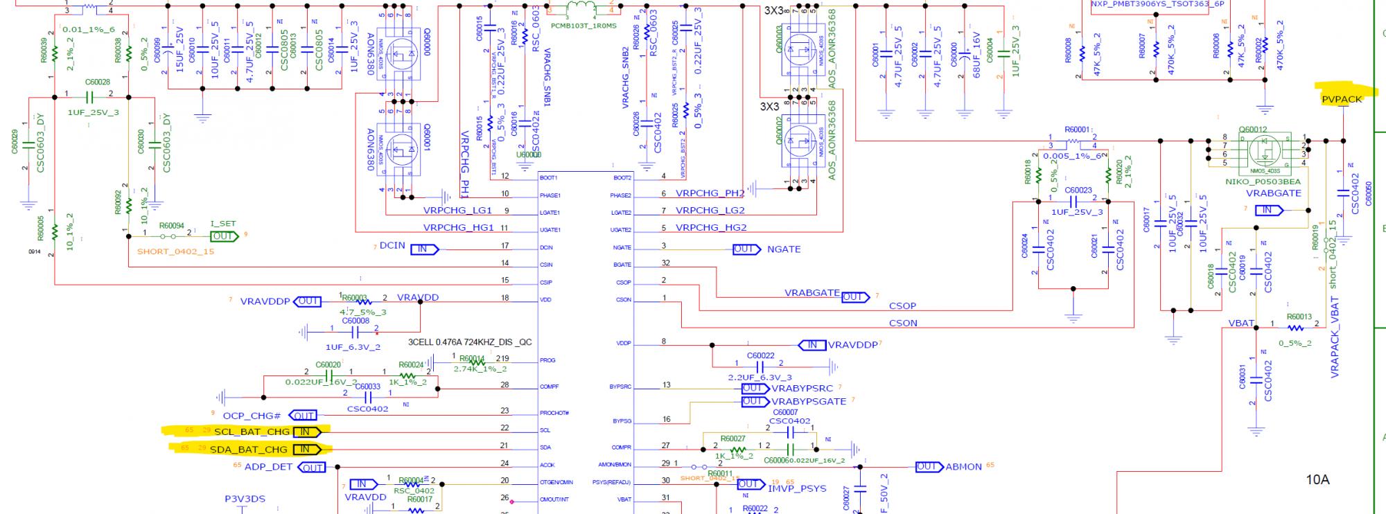

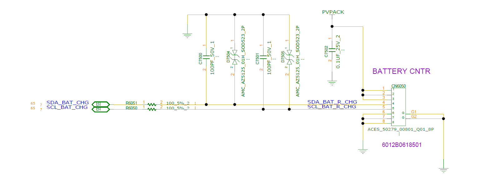

    I have an issue with the charging section of the said Laptop (another thread) and I can only operate the laptop with the battery.
    But once the battery is discharged the Laptop is not switching on nor is charged.
    Problem is investigated
    Now the question is:
    1. if there is a way to charge the battery outside the Laptop (Externally) with a standard charger/power supply. (not recommended) but I have to try so as to operate the Laptop and get the data.
    Connector is coming with 8 cables (three red, three black and two intermediate blue yellow)
    2. What is the Voltage i have to supply (black cable are in Parallel, red cables are in parallel)
    Attached the details from the schematical diagram of the motherboard which I managed to find/bought
    Any help will be highly appreciated

        1) do post the schematic in the schematic forum and link it here. It will assist future techs.

        3) a dedicated battery charger tool is often used to charge the battery pack. There is a popular one out of Romania but may not be practical to purchase for this single laptop repair.

          I bought it from online but here it is schematic. https://www.badcaps.net/forum/showthread.php?p=1266840
          Elitebook 840 850 G6 and Zbook 15u share the same schematic

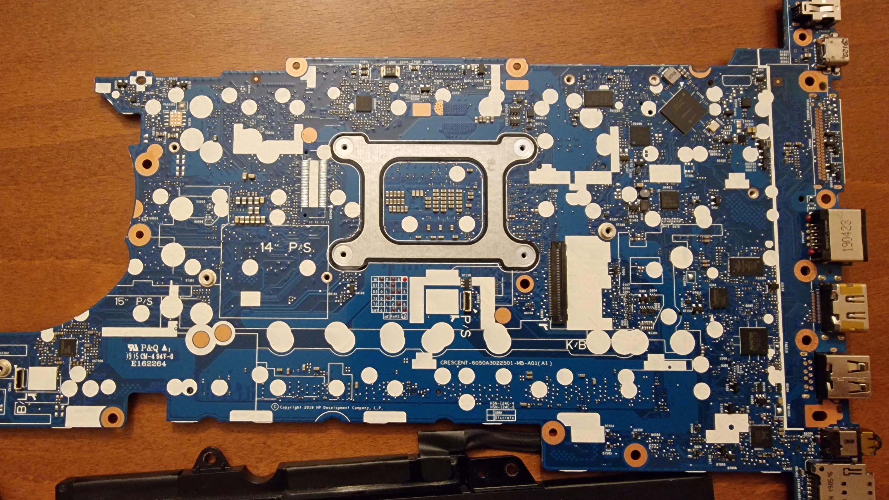

                Carefully measure the voltage to ground of each pin of the mosfet at Q60003. Under this case, this mosfet should pass the power adapter voltage rail forward onto the main logic board rail.

                  Battery is disconnected and I have taken various measurements starting from the connector.
                  Please see the attached drawings where I have put inside the red boxes the figures I have measured
                  I cannot identify if anything wrong. Your further support/advice is kindly required

                      In the end, they are applying a dedicated charger IC like the BQ series in an enclosure to perform the same task. The 8 pins are common contacts and still will feature:
                      B+
                      Ground
                      Smbus lines (SCL and SDA)
                      There is an option you can consider and that is the BQ development tool or clone from AliExpress. That tool with the software from Texas Instruments will allow you to debug and interact with the charger IC that will be similar to the logic board charger. You will need to interface the contacts on the battery pack with flat copper pads which is more of a challenge. Again, this is a USB to smbus + charger IC tool but compatible with the Texas Instruments software.

                                    The DC jack measurements look to be ok to me. One is the main adapter feed and the other is an analog voltage used to gauge the power rating of the mated adapter. The EC controller (8051 based) will sample this voltage using an Analog to Digital port to determine the specs of the adapter.
                                    With extreme care, can you measure the voltage to ground of the ACOK (pin 24) pin on the charger IC? This is the final status of the power adapter being used. If it is a logic '1' = ~3v3 then the adapter is accepted as being OK to power this logic board.
