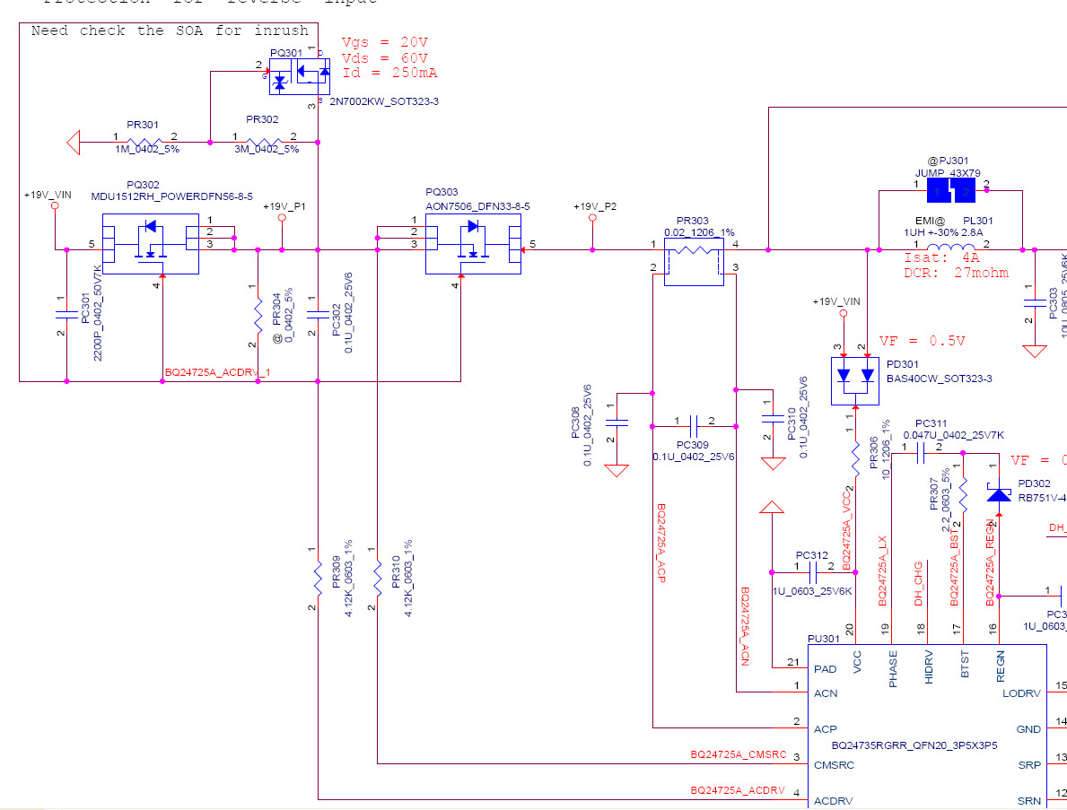

    Hi
    I have this laptop
    MB: B5W11 LA-E061P
    When put dc power on first FET has 19v on pin-5 but after that on +19v_P1 has 0.9v only (fet not switched on) also on main power rail only 0.9V
    With battery main power rail is ok, 16V and laptop starts ok
    If I short drain-source on first FET then I have 19v on main rail, battery charged but FETs for charging goes very hot
    Any help?
    P.S. Just to mention that not have LDO on 3/5alw becouse no voltage IN-19v on drivers ICs, only 0.9v

        Attach the power adapter. Carefully measure the voltage to ground of each pin on the charger IC.
        Post each measurement with the pin numbers for a review.

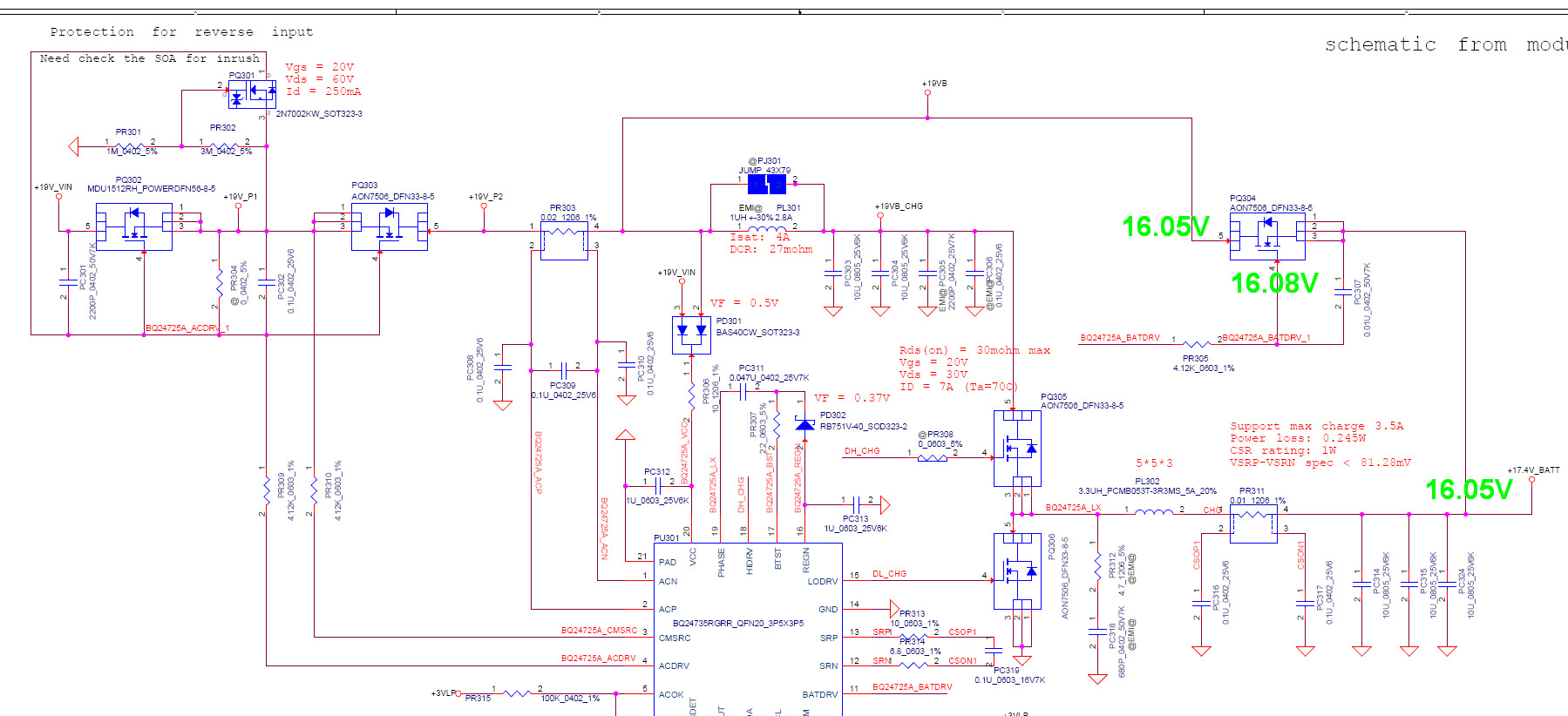

            this is battedry only connected:
            1=16v
            2=16v
            3=/
            4=/
            5=/
            6=/
            7=3.3v
            8=3.3v
            9=3.3v
            10=0.8v
            11=16.5v
            12=16.5v
            13=16v
            14=/
            15=/
            16=/
            17=15.8v
            18=16v
            19=16v
            20=16v
            batt=16v on connector

              Also PQ304
              G,S,D ame voltage, should be on gate at least +5v more then source?
              I removed this fet and now 19v is ok via dcin
              solved,replace that fet and now laptop on,batery charge... source to drain was shorted on fet

                No REGN in battery mode can not be true. And if one measurement is wrong, we cannot trust in any of these measurements since it would mislead the whole troubleshooting process.
                It is also in your interest to redo all 40 measurements till we can be sure you did it right.

                  I tried all measurements to be good,on that diode not has voltage in battery mode, its big diode so easy to test voltage....but maybe you right...maybe gnd moved or similar but laptop is ok now

                      By datasheet REGN ldo is 6v when ACDET is above 0.6v
                      ACDET has voltage divider from +19v_vin , which is not present without adapter.

                        PQ304 was shorted drain to source l¹
