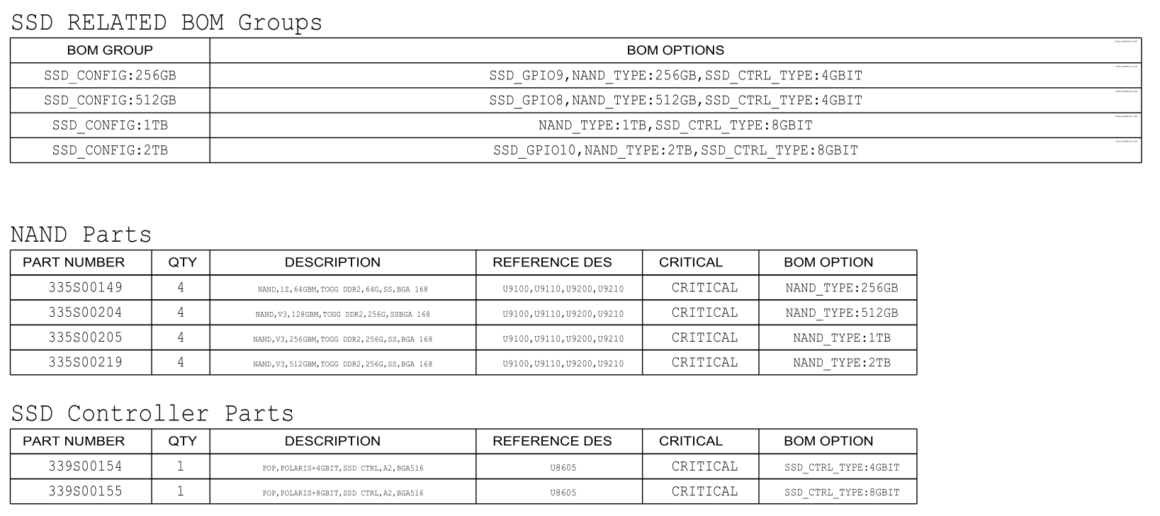

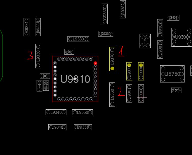

    I'm replacing NAND (Upgrade 256GB to 1TB) and need a favor from someone who have this motherboard – 820-00928. I haven't checked resistant to the ground before replacing chips and after I've placed new chips I've notice low resistance on L9370 (number 1 on my attached picture) next to the U9310 (S2FPS04X01). 0,3 - 0,2 Ohm.
    If someone will be so kind and could check this resistance I'll be pleased.

    Re: MacBook A1707 favor needed.

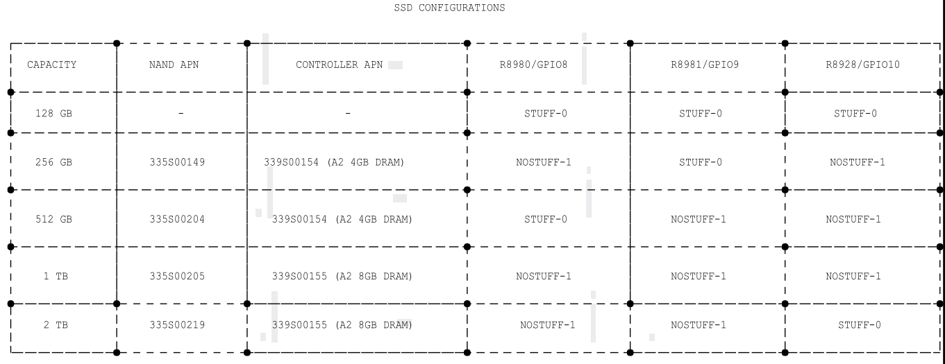

    It was shorted SDD controller. I haven't touched it during replacing SSD chips around and glue was still there. It seems glue is changing its capacity during heating. When I've removed it there was a mess under it. Now I have high resistance on that coil, and I've measured 1,2V. But replacing SSD's wasn't success. M/B works, but there is no disk..
      There are strapping resistors and the SSD controller for 1TB/2TB configurations has more RAM.
        Thank you Piernov. I'll try that. Still have SSD Controller.
