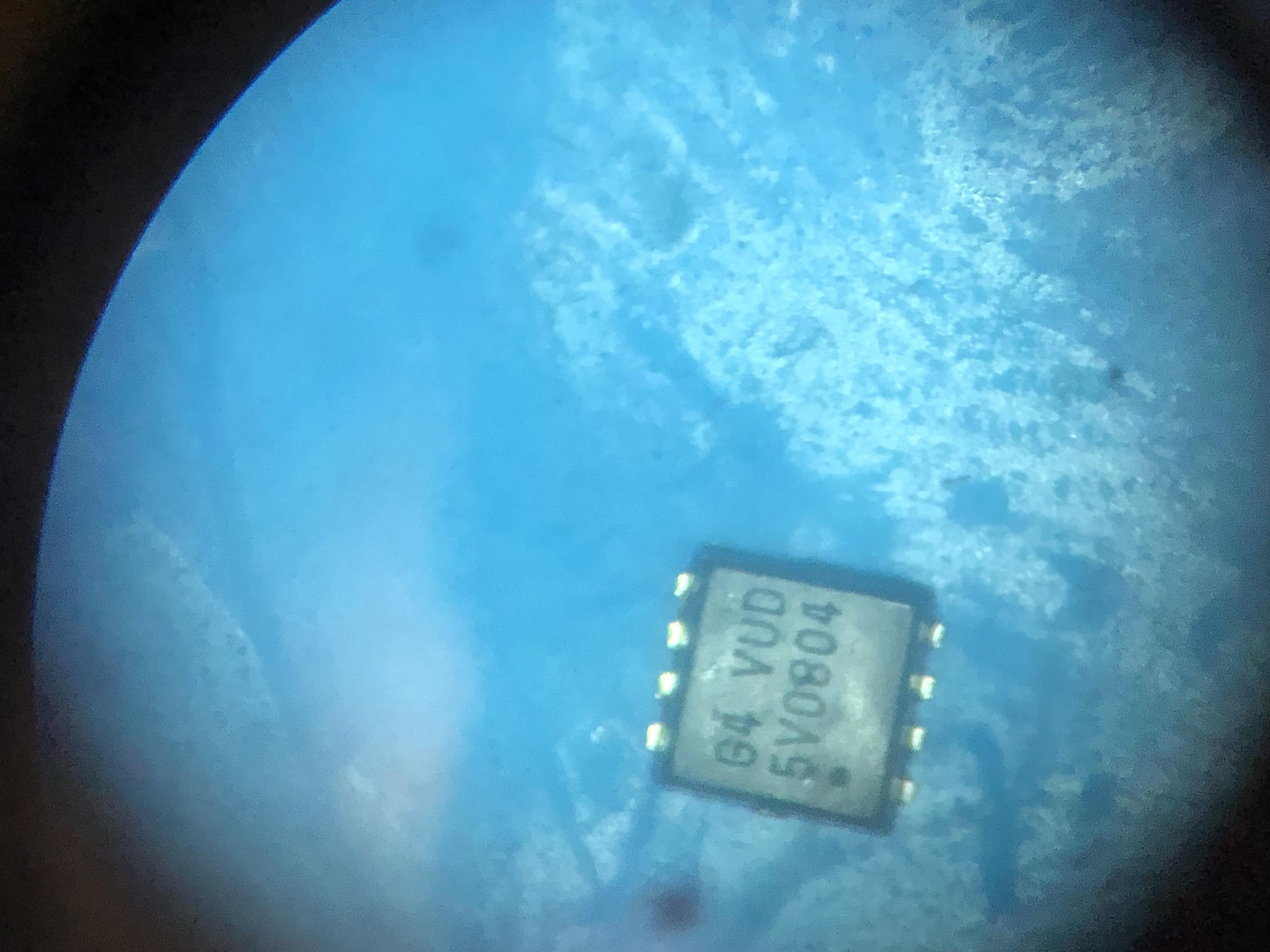

    HI, I discovered a mosfet in continuity, and grounded the motherboard. I would like to replace it to be able to repair the motherboard of my asus pc. I am not a big expert, can you tell me what is this mosfet?I can't find it on the internet.
    Can you help me find the datasheet and maybe tell me which mosfet I can replace? I have macbook a1466 1708 1278 donor motherboards.
    THANKS

    It is a PEA16BA mosfet...
      • 20949
      Re: identifying a mosfet for asus laptop
      PE616BA .https://cdn.badcaps-static.com/pdfs/...2c64e89db5.pdf

        Thank you so much

          I changed it with this one, taken from the macbook a1466, the mosfets heat up enormously and the pc does not start
          https://cdn.badcaps-static.com/pdfs/...c1196d720b.pdf

            We should start with the location of the Mosfet and the circuit to which it is related to and clarify later why it possibly isn't a suitable replacement.
