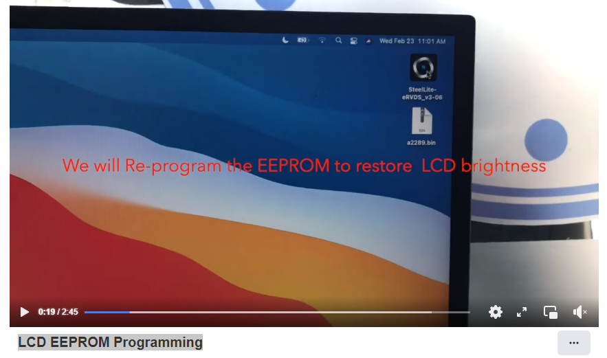

    HELP A1989 screen with dimmed brightness issue
    Hi guys. I bought a MacBook A1989 screen assembly from Alibaba, and after replacing it, I realized that I was scammed. The screen is dim, and the keyboard backlight doesn't work. I have researched and found that there is a software called SteelLite-ervds _v3-06 LCD EEPROM Programming that can fix this issue. However, I have been unable to find a place to download or purchase this software. If anyone knows where I can download or buy this software, please kindly help me. Thank you very much.

          can you tell me where to download or buy this SteelLite-ervds _v3-06 software to fix my problem ?

                Re: HELP A1989 screen with dimmed brightness issue
                I think this is your problem?
                https://www.ifixit.com/Answers/View/...hes+after+boot
                The LCD backlight controller is a ghetto house marked one from TI (former National Semiconductor group). Respectively, no public datasheets I could find in a quick search.
                From the schematic, this controller is configured over I2C (aka SMBUS) interface using the SCL / SDA lines.
                Have a few ideas for a fix but are 'hacks'.
                Hack idea #1 -> allow for the unit to boot with the bright screen and before logging in for the dim backlight intensity, strap eith the SCL or SDA line LOW (ground). Doing so will halt further I2C bus communication so any further attempts by the host I2C bus master to dim the display will be rejected. This is safe to do but is a hack. If you get a chance and with care, consider to test it. Post your feedback on the attempt.
                Hack idea #1 -> use an I2C bus analyzer to monitor the communication from the host to this I2C slave. Review the logs (ie. Total Phase tools are good for this) to learn how the display is being dimmed.
                Then use a low cost microcontroller (WCH has some parts for around $0.10 USD) -> they have lots of code examples + free GCC compiler -> use the I2C code example and target this I2C slave address -> apply the micro's SCL/SDA lines onto the existing ones on the logic board.
                Using a time delay or pushbutton, etc., allow for this micro controller to send out the I2C bus packets to dial up the intensity again, back to normal. The value of the backlight can be user defined.

                        Any body have info about SteelLite-ervds _v3-06 ? where can buy it?

                          I have this software !

                              This is the software you are looking for !
                              In my memories this software works on High Sierra
                              I just tried it on montrey but I can't launch it.

                                It seems to works only on Mojave !

                                  Hello, to solve the brightness problem do the following. Start the macbook with catalina or bigsur, open the steellite app and in the second tab change the value of the id panel to A039 then click on write to eeprom, close the steel and restart the macbook, with that the system applies the correct values at startup and the backlight level is corrected. I advise you against playing with the eeprom and its values and always make a copy of the eeprom before touching anything. Luck.​
