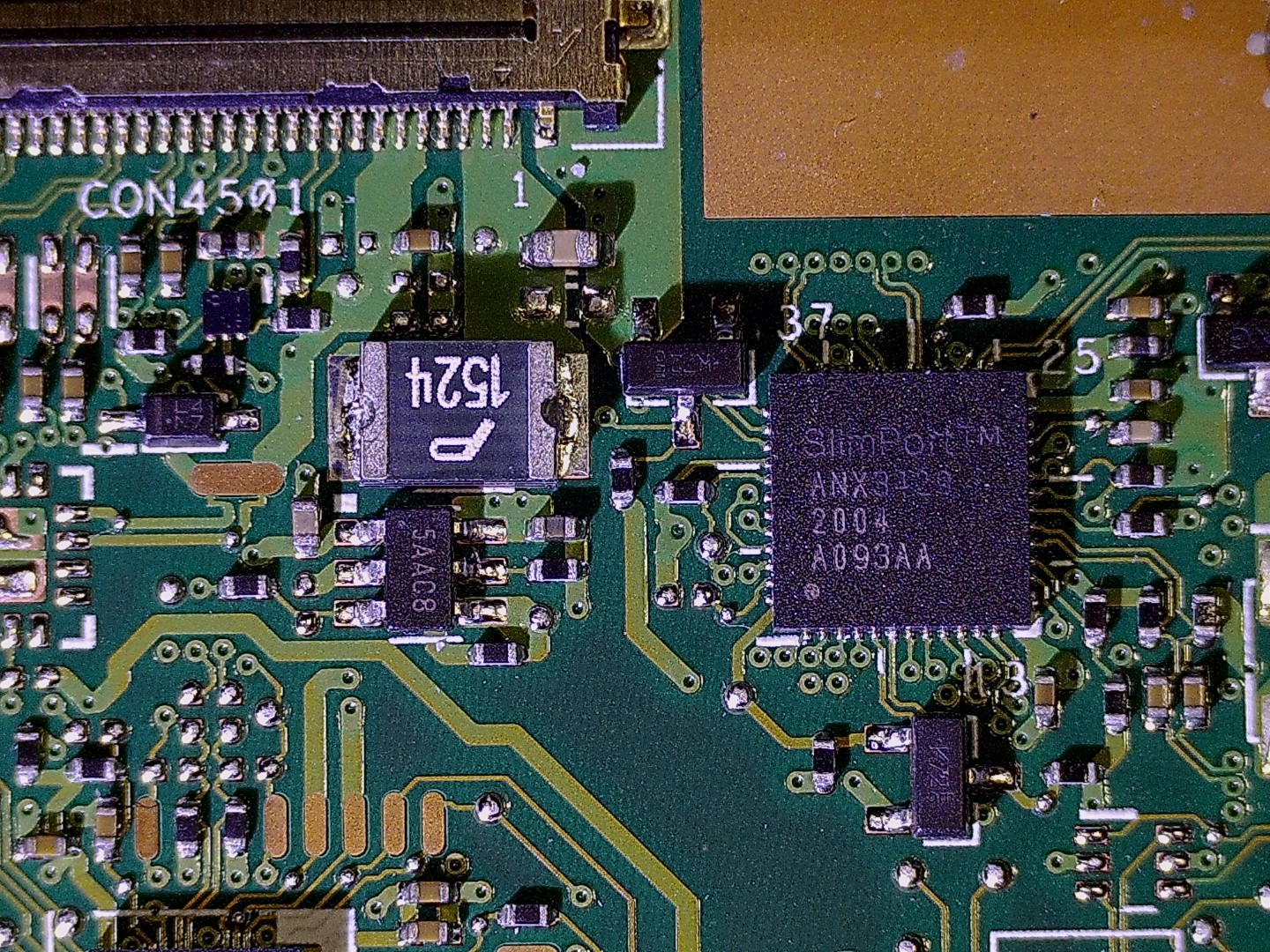

    Asus C423N not turning on because of shorted SilmPort Chip ANX3429 ?
    Need some advice from my Badcaps friends!
    I have this Asus C423N laptop that doesn't turn on, voltage from the power supply doesn't seem to get to the laptop.
    I checked the power rails and one of them was showing 14 ohms, so I injected voltage on that rail and the SilmPort Chip ANX3429 gets abnormally hot.
    So my reflex would be to change that chip, but I am unsure if it is a chip with firmware on it or just a power controller type chip? Can anyone help?
    Photo of actual chip uploaded.
    Many thanks!

    Re: Asus C423N not turning on because of shorted SilmPort Chip ANX3429 ?
    Hi this is just a power controller
