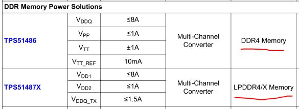

    Hi, have a question about the pwm TPS51487 output voltage.
    Have a UX425IA motherboard that have no image.
    All voltages are present, and power consumption is 600 mA from power supply.
    A good bios have been programmed but nothing change.
    DDR4 voltage is only 1.1 volts, and I think It should be 1.2volts
    It has 4 lpddr4 memory chips type OVE77 D9WLQ, and datasheet says this chip needs 1.2v.
    Probably the chip and sorrounding components all are good and 1.1v is ok in this board, but need someone that confirm that.
    I know that TPS51486 is almost identical, but not found datasheet for comparing them.
    Thanks for your comments.

      Re: Question about TPS51487
      Heres some schematics with these IC`s.Some of the pin descriptions are not the same,if you look carefully
      Quanta DAG7HAMB8E0 https://www.badcaps.net/forum/showpo...80&postcount=2 TPS51486RJER - PU8700
      HuaQin NB8511 https://www.badcaps.net/forum/showthread.php?t=105702 TPS51487XRJER - PU701
        Thanks SMDFlea, this information solves the question.
        From the schematic "Floris Yebisu NB8511 NB8512PU701 MB V4 FINAL" I can see that PU701 (TPS51487XRJER) outputs the +V1P1U_VDDQ for LPDDR4 chips.
        So, in this board probably the cpu is damaged and is not able to fulfil the POST.
        Another board for the trash can.
        Forgot to say that kbc have been programmed wit new data extracted from last bios update.
