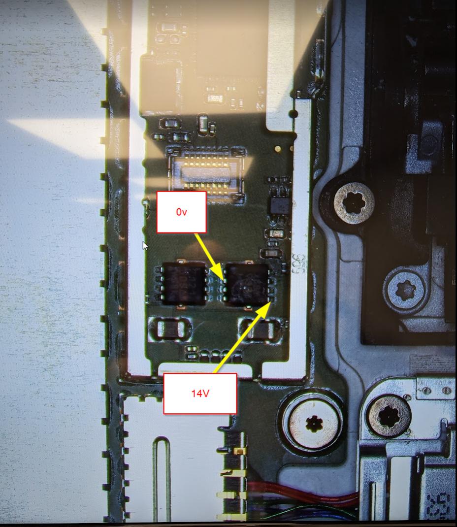

    Surface Pro 4 drawing no current, no power on
    Hi! I have a surface pro 4 here which will not power up and pulls no current plugged in. Some preliminary testing shows 14v on the drain of the 1st mosfet, but nothing coming out of the source. What additional questions can I answer? Any thoughts?

    Re: Surface Pro 4 drawing no current, no power on
    Is the adapter's charging light on? If the charging light is on, it is the IT8528VG chip that opens these mosfets.
    If the charging light is not on, the problem is more complex.

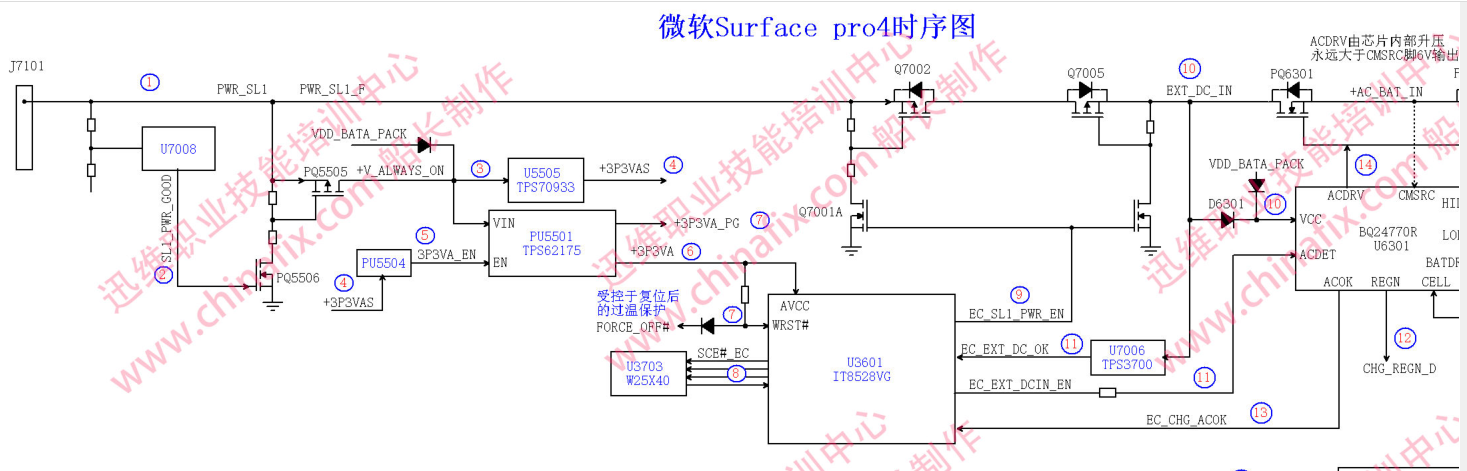

      See attached for the power sequence (in shown circles).
