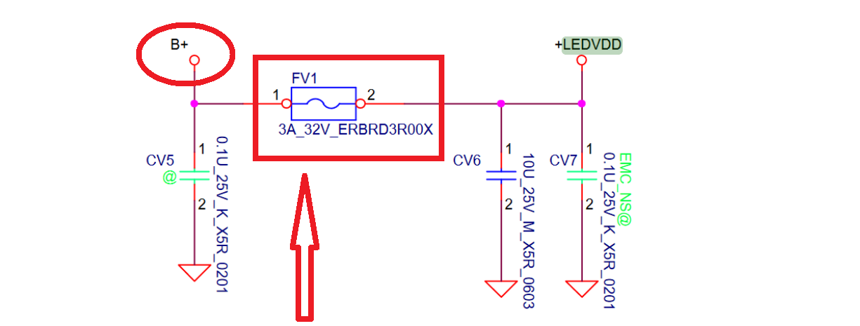

                ihave another question if you dont mind ihad a exact ssame unit but the issue is the lcd wont turn on i tried using a external monitor and there is a display i checked LCDVDD (3.3 present) i checked lids switch (3.3present) but the LEDVDD is missing what voltage should i get normaly on LEDVDD? and whats its pupose?

                  Re: ideapad 3-14ITL6 Laptop - Type 82H7 repair
                  Check fuse FV1.
                  LEDVDD=B+=20V (main power rail).
