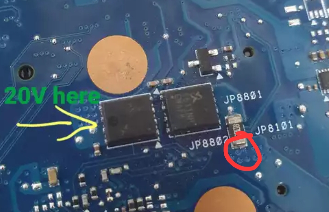

    My laptop won't turn on anymore, I am getting 20V from the charger into the first mosfet but there's no voltage on the source so nothing coming out the other side of the mosfet. So the battery isn't charging.
    There are no shorts on either mosfets or anywhere else I can find. I've tried looking through the schematic but it makes no sense to me. The board view pdf is a waste of time too.
    I took it apart earlier and had the board on the dwask, was poking around with the multimeter looking for shorts and then retested to see if voltage was getting to the battery port and it was. I had 12V on the red leads and 3.3 on the yellow and white. So I put it all back together testing each time I added something and it was fine until I added the battery. The 12V then dropped to 10V but then testing later I then get 0.3V on the 12V side of the battery port and nothing on yellow or white.
    So I'm stuck, can anyone help please? Where should I be looking?
    Some pictures here: https://imgur.com/a/D5DrFWe
    Edit: I may of found something, this side of the mosfet is shorted to ground: https://imgur.com/a/X6R6jav

    Remove power, measure resistance to GND here in Ohms mode and share the reading.

      It started in around 3MOhms and gradually dropped down to 94k

        Since this mosfet most likely belongs to the buck converter for the battery charging rail, it is probably the low-side mosfet. it is absolutely normal and expected to have one mosfet of a buck converter connected to GND, otherwise it could not create the down-stepped voltage. So I kindly ask you to stop doing random measurements.
        Share close ups of the area around the DC-IN and Battery connector since we need to identify the charging controller.
        Edit: Probably this one. Share the top marking please. And clarify why it does look so dirty there.

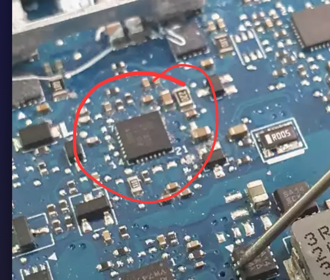

            The "dust" need to be ruled out anyway. So proper cleaning, share top marking and a nice and clear picture from the top of the IC with surrounding components please.

              Sorry for the delay, just got in now. The chip is a BQ 24780S which is a battery charge controller, would make sense this thing is at fault. Datasheet here: https://www.google.com/url?sa=t&sour...Fj-GWLYsdvatqK
              Pictures of the chip: https://imgur.com/a/6NIvyB8
              Really appreciate your help so far buddy!
              I'll get it all cleaned up now and test...
              Edit: cleaned and reflowed the chip but am still only getting 0.3V on the 12V side of the battery port

                Likely a issue around the charging controller or a faulty charging controller itself, yes.
                Pictures were taken before or after cleaning(?), because it is still hard to identify the tracks with all this stuff in the picture. Angle and quality is perfectly fine, though.
                You have sourced the datasheet, so start measuring voltages please. Pay attention to not short different tracks together. CMSRC, ACDRV, ACDET, ACOK, REGN and VCC

                      REGN is not up although VCC is above UVLO and ACDET present. Usually It points to a dead controller. But you should measure resistance to GND of all pins to make sure there is no unexpected short to GND somewhere. Measurements without power of course.
