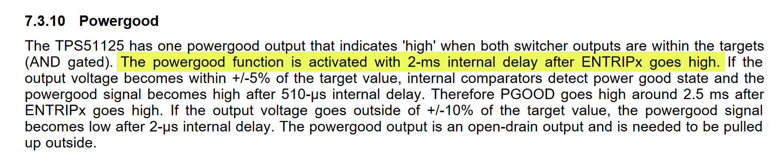

                  • mon2
                    • Dec 2019
                    • 14663
                    Re: Lenovo b450 LA 14 no power up 13mA
                    This regulator is remaining OFF due to ENTRIP1 & ENTRIP2 pins being logic low. Respectively, PGOOD is a logic low since both of these rails are not within specifications.
                    (netnames are 51125_ENTIP1 & 51125_ENTIP2)
                    L15 and L6 = 0volt
                    Remove all power -> meter in resistance mode -> measure the resistance to ground of L15 and then of L6.
                    Post each measurement.
                    reference - regulator datasheet:
                    https://cdn.badcaps-static.com/pdfs/...abc8077401.pdf
