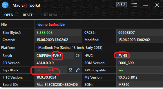

          Ok I am 99% certain this is down to a borked firmware file. I dumped it via linux with flashrom...
          - fsys checksum is invalid
          - hardware code is different
          - country code in serial is unknown (C10)
          How this boots and works 'fine' is beyond my understanding

            • reformatt
              • Feb 2020
              • 1418
              Re: A1502 - unable to run diagnostics
              You need to fix the Fsys block checksum in the dump after you change the serial number. Piernov has a video on YouTube on how to do it with UEFI tool and hex editor.
              Diagnostics doesn't reside on the SSD anymore, it's downloaded via Internet Recovery. Invalid serial and bad checksum would explain why its not working.

                The board inside of this case is 820-4924-09. From the files I found for this model, all of them had FVH3 as model code.
                Each and every time I changed the serial to the one on the case (it indicates FVH5 model), the board wouldn't start - and cycled.
                However... when I updated the serial in the 'original' dump (which was FVH3...) the board booted, new serial was visible in OS, however the diagnostics wouldn't run UNLESS i put 4D1EDE05-38C7-4A6A-9CC6-4BCCA8B38C14:MLB/HW_MLB values in NVRAM.
                Tried clearing VSS/SVS - no boot.
                So I spent hours de/resoldering/programming the SPI, checked multiple files and I'm a bit stuck... some sort of validation of the serial/model is kicking me in the butt :|
