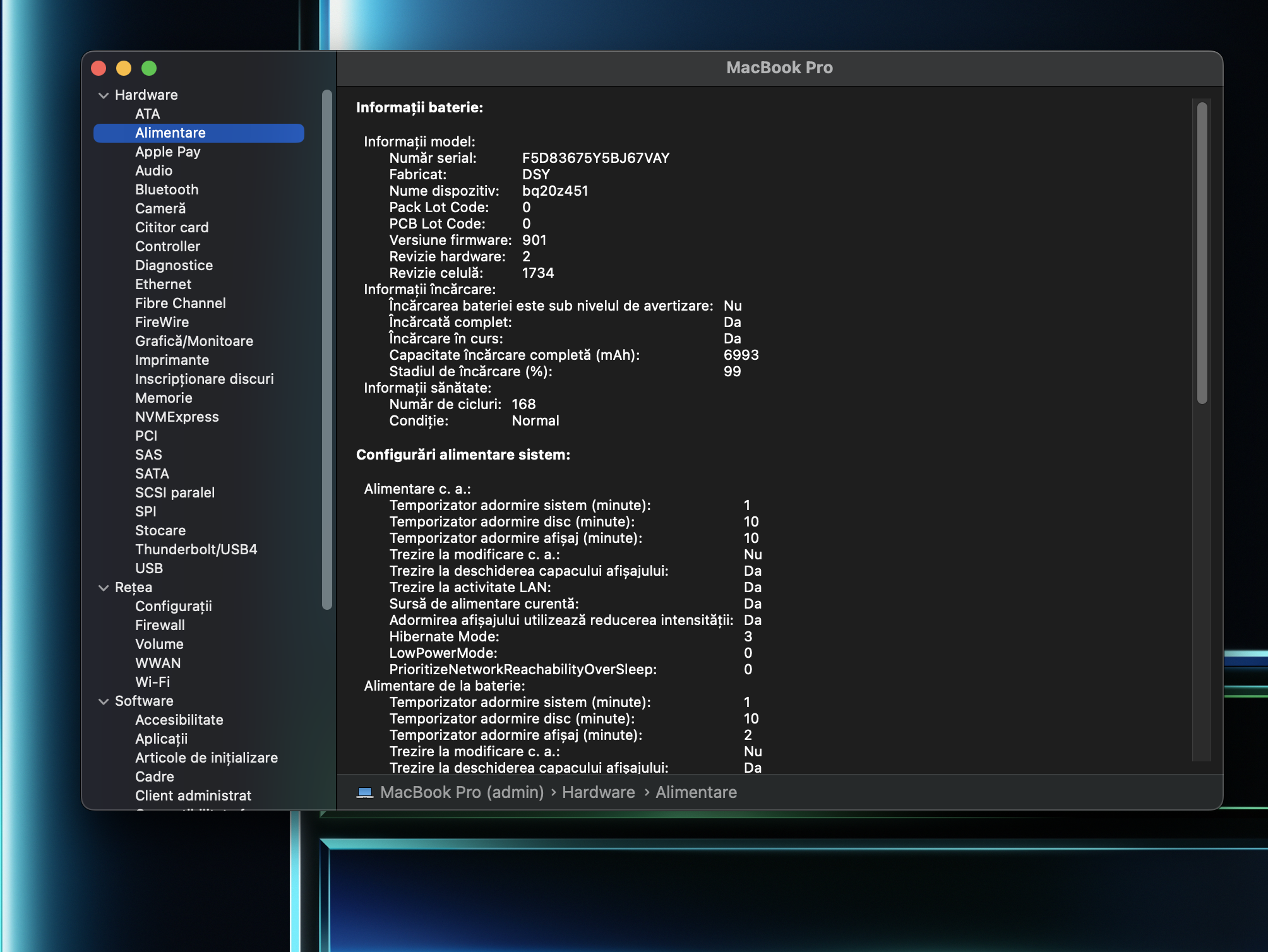

              Hi Stephen!
              I have an issue with an MBP 15' - A1990, it boots when battery flex cable is unpluged but when I plug in the cable it runs in kernel panic, the fans are running at max for a second and the machine reboots over and over again, in loop, until I disconect the flex cable.
              First I thought is something about current sensing, and I replaced the current sense rezistor, after that the ISL chip (U7000). Result - same behavior. I've dumped the ACPI tables and I found that one of them SSDT SmcDppt.aml is empty, has nothing written on him. If this table is responsible of SMC behavior, could be an explanation. I have a reflashing tool, but no genuine A1990 I7 2,6Ghz bin file to reflash SPI ROM. Could you help me?

              Hi Stephen,
              I already tried with 2 other batteries. this one has 168 cycles. I could boot with the battery pluged in but with trackpad cable disconected. It booted slow, and the fans where running noisy, and that's how I found information about the battery.

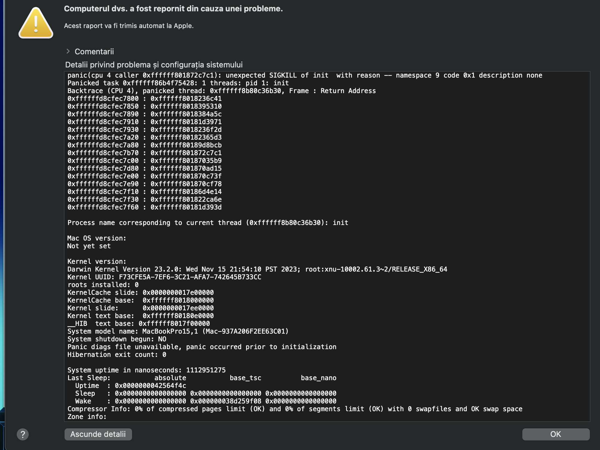

              I've performed a new DFU Restore, this time with last version of macos Sonoma on both macs, and with the last iBridge. The same result. Please tell me this, DFU Restore operation is reflashing the entire T2 ROM file?
              I have some KP messages looking like this

                  When I read the KP message - about a namespace error, I thought there's something about ACPI namespace and the ACPI tables are part of T2 ROM bin file. That's why I've asked you to help me with a clean T2ROM bin file.
                  The old battery had over 750 cycles, and I experienced something with an A1989 model, wich was working normal until the battery percentage was drawing down to 60% - 70%, when suddenly the system was crashing, rebooting by itself with KP message. So my explanation is that could be the same with this A1990, perhaps it was performed a major update, without the addapter pluged in and during the process, the system crashed and the bios was corrupted.
                  I have another macbook in the same stage, an A2251 one. At this one I have no info about the battery, but I let it to charge at full, and after few hours I measured the voltage - first 8V, after 7V -decreasing, with the battery flex cable un plugged. I think this one also had a broblem with the T2ROM bin file corrupted, probably the same cause. I could be wrong but I have no other explanation. So could you help me?

                    You will have high fan spin when trackpad is disconnected and it will act slow with these machines. This also happens with m1 machines. You should always have the trackpad connected. If the fans are off when it is connected and it boots normally and the battery holds a charge you have an issue with the board and need to diagnose the board for repair.
