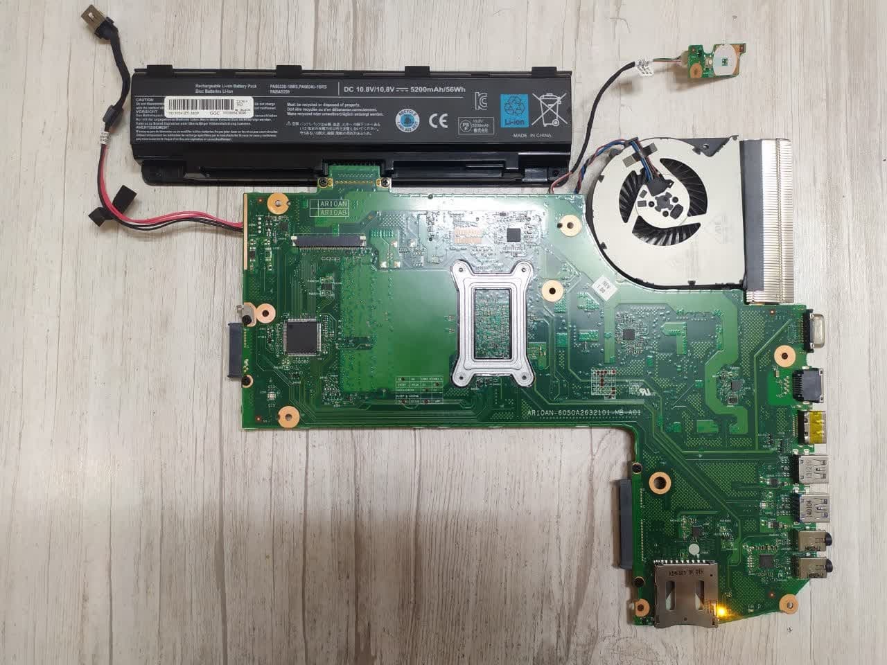

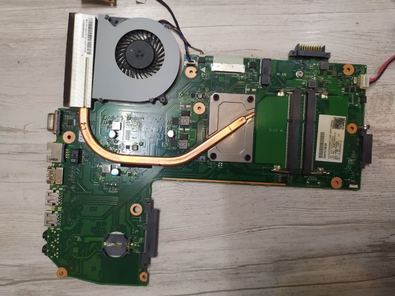

    Hi
    I received a Toshiba laptop that does not turn on with battery and the orange indicator flashes.
    Even if the battery is connected, it does not turn on with the adapter.
    (it turns on without battery)
    I replaced the charge controller(BQ24725a), IO (NPCE285UA0DX)and battery but the problem was not solved.
    The input and charging MOSFETs are also correct.
    I don't know what to test anymore?
    Thanks for any help.
    MB:AR10AN-6050A2632101-MB-A01

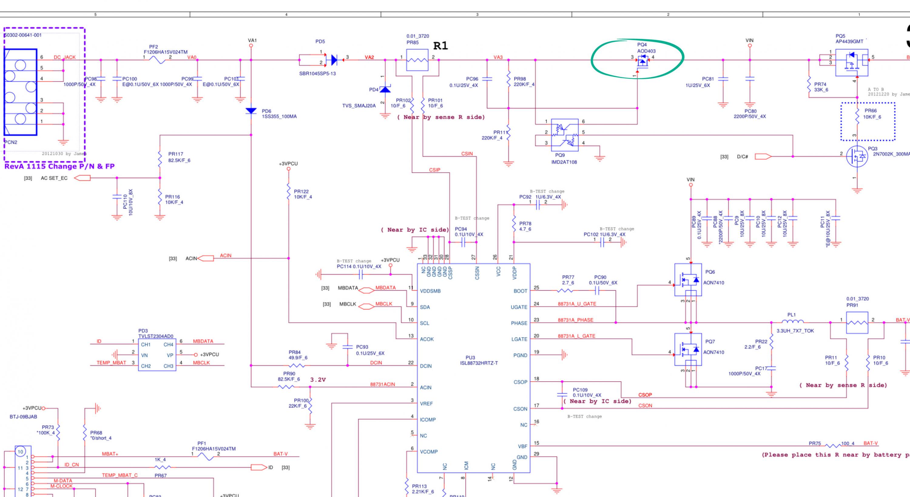

      Review each of the power path mosfets.
      Be sure the battery is a known good battery. If possible, test with another battery.
      Review PQ5 which is the battery mosfet that should enable if on battery only; turn OFF if the power adapter is plugged in.

          Re: Toshiba C75D no Power With Battery
          Given that the unit fails to turn on if both the adapter and the battery are connected hints that you have a leaky mosfet in the power paths.
          Post the resistance readings of the mosfets for a review.
          Source & drain
          Source & gate
          Gate & drain

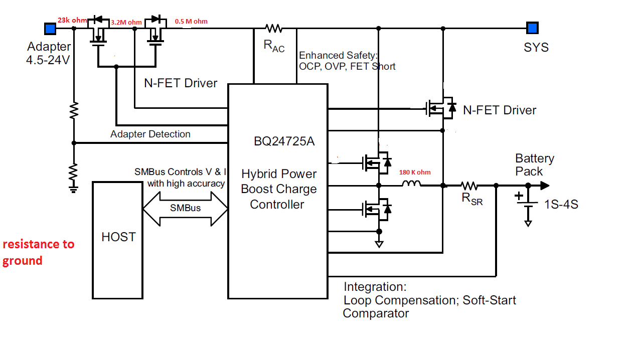

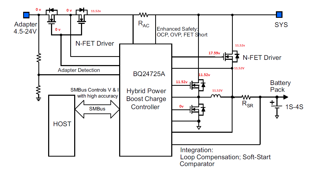

            I Pluged in AC and Battery and Measur points.
            I marked the points I measured with a red line in the photo

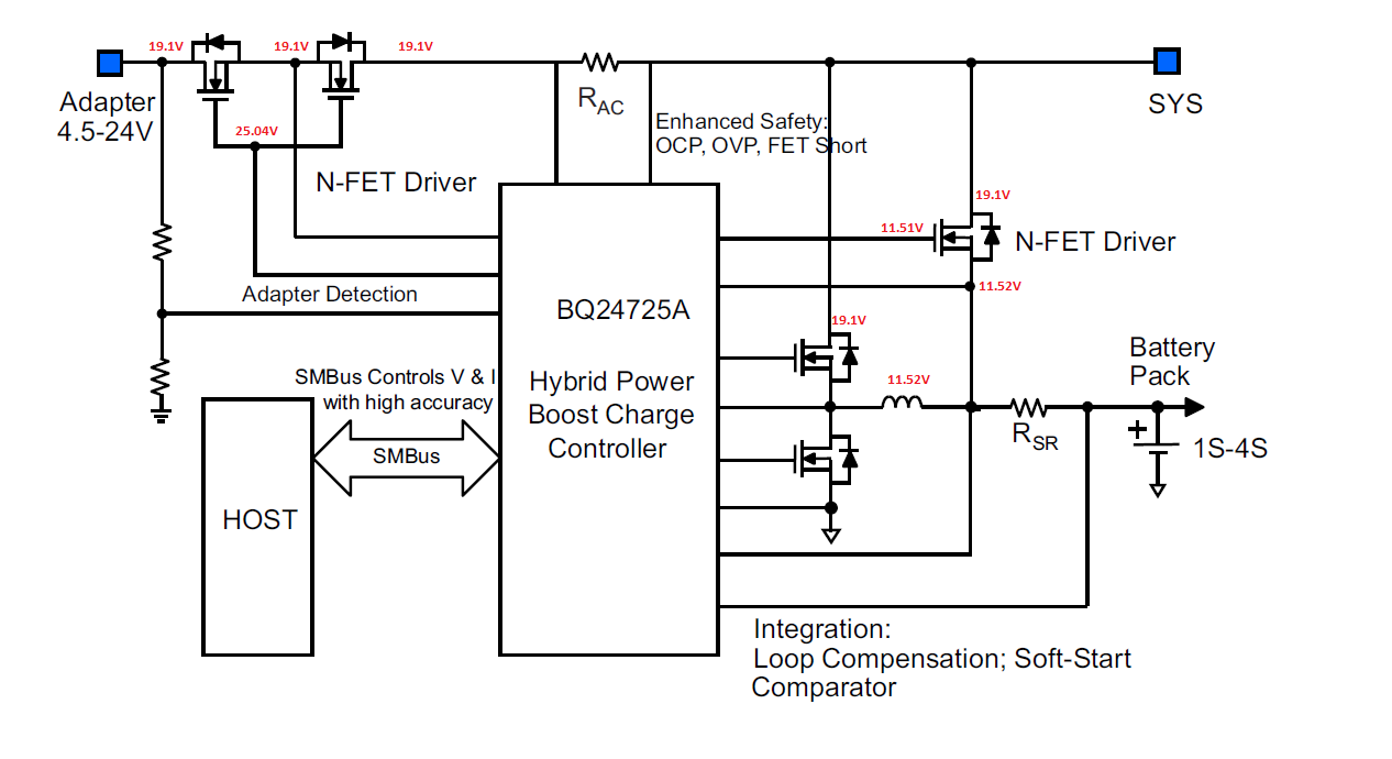

              Measurment With Just Battery.
                We were after the resistance and without power but the values look ok.
                The gate voltage should be higher than the source/drain pins to enable which they are.
                Remove the battery and confirm the resistance to be sure the mosfet is not always leaking (enabled).
                Then review the same for the 2 x DCin mosfets.
                The adapter detect voltage should be also > 2v4 to be considered as a valid voltage (usually is ~2v7).

                  Measure without power .
                  .Today should be different from yesterday.
                  • mon2
                    • Dec 2019
                    • 14664
                    We are after the measurements across the mosfet pins.
                    One probe on source (1-2-3) and other on drain (5-6-7-8)
                    Then source & gate (4)
                    Then gate & drain
                    Post each measurement of each DCin mosfet.

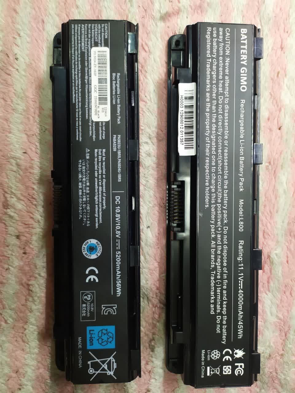

                      • ahkh_72
                        • Dec 2014
                        • 109
                        • Iran
                        According to this post (https://www.badcaps.net/forum/showth...hlight=bq24725)
                        -It is exactly the same for me-
                        I think the problem is about non-orginal battery.
                        Tanks for your time #MON2.
