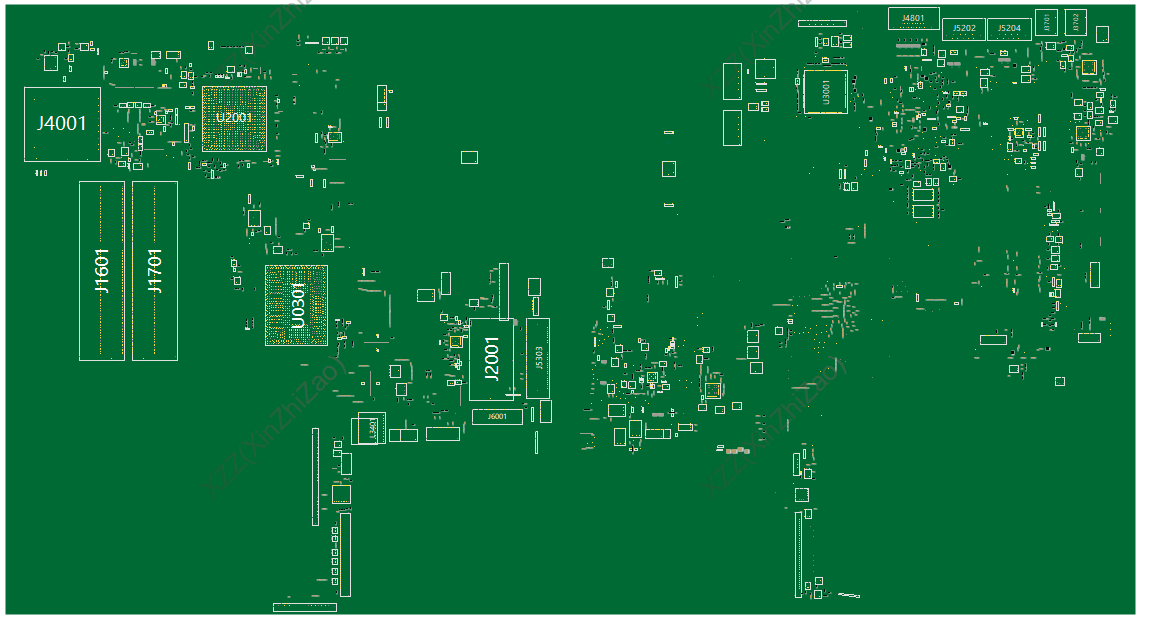

        Post a few pics of your logic board. We need to review the location of the parts to determine which version is inside of your laptop.
        Perhaps the logic board is like the attached view? If the laptop is popular enough, there will be leaked schematics and a boardview file to assist us. Otherwise, the process will take longer to diagnose. In general, there is the power adapter -> DCin mosfets (usually are 2 of these) -> then the charger IC. Most of the time, the fault is in this region of the logic board.
        Using a meter and hot air soldering tools, it is possible to repair most of these boards. If required, you can lean on your local cell phone repair store to make the replacement of the defective parts after a review.
