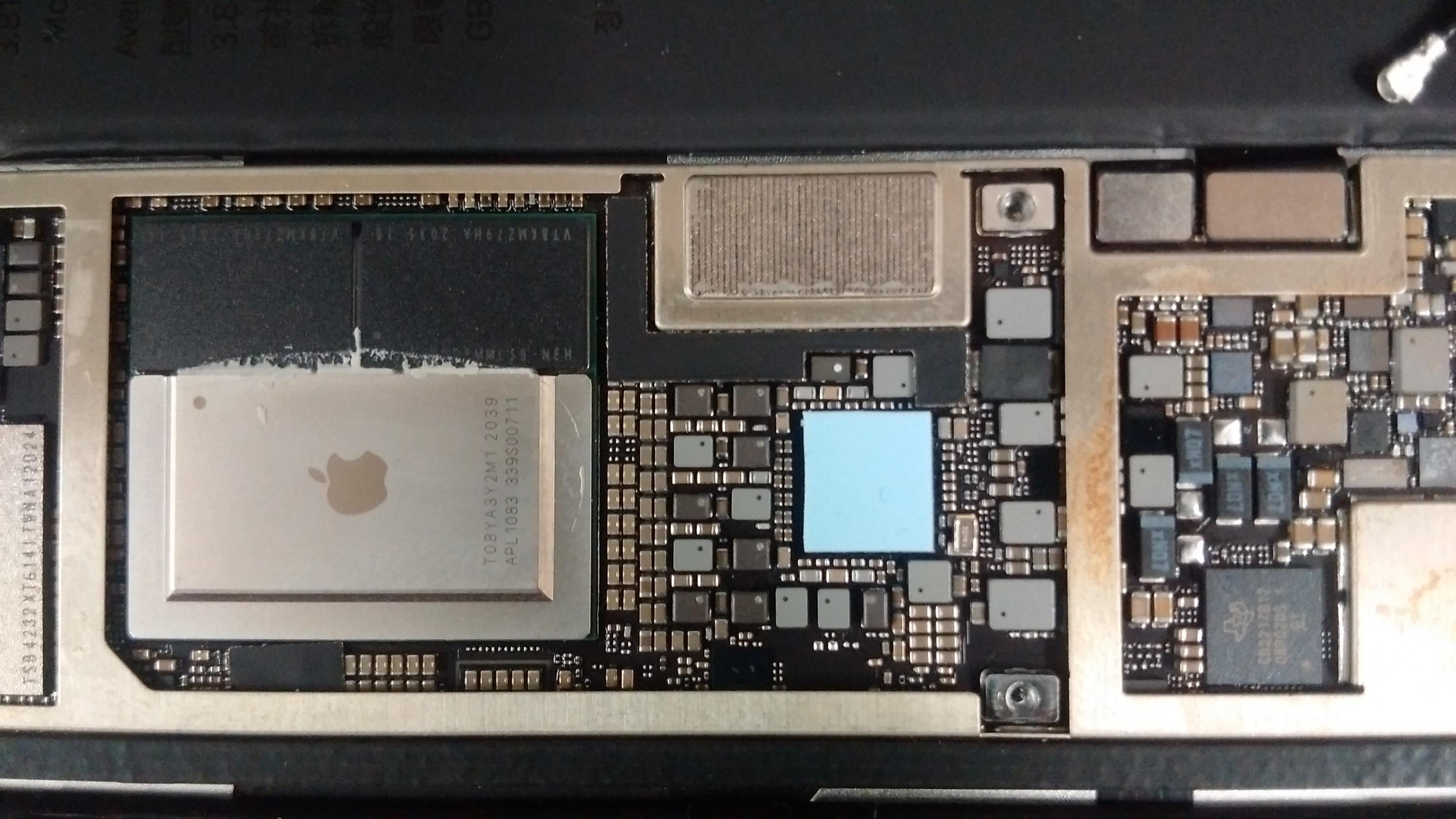

    Post the details of these parts with their values, size, voltage.
    Chinaphonefix is a good vendor we have used for ipad parts.

      Re: iPad Pro 11 A2230 won't boot up - stuck at logo
      D8710 Finally found it on Mouser.com https://cdn.badcaps-static.com/pdfs/...2c4536cde1.pdf
      C8073 - 1uF / 35V (0402)
            So, I finally disassembled PCB. Changed broken diode (I found donor - iphone XSMAX - same value). Removed C8073.
            But with no effect. Still the same.
              What is the current draw?

                    #29
                    So, now battery is disconnected, there is only USB-C connected.
                    Still stuck at logo. Current draw is about 120mA.
                          There appears to be very little on this model and topic on the internet.
                          Remove the USB-C port cable so there is no power to the logic board. Meter in resistance mode.
                          Measure the resistance to ground of each coil you can probe. Review the coil(s) against the schematic to confirm if they are linked to a local switching power supply rail.
                          If the resistance is low, there may be a shorted capacitor on that power rail.
                          Other suggestions are to review the I2C bus devices. It is possible that the OS is stuck waiting on some I2C bus slave device to respond and there may be a disconnect.
                            Well, I think this is impossible, beacause there is no visible pads. See photo.
                              Understood. Trick is to find a nearby capacitor that can be probed and is on the same power rail. Since power is removed, all safe to check each such coil.
                              You are sure the ipad was not dropped? This will result in fractured coils or caps.
                                C8073 and D8710 shorted, those 2 components have connection to U8000.
                                This IC has I2C bus you should check this IC and components around.
                                  There is no short. Already checked it.
                                    Ok no short around U8000 but the IC itself can be the problem
                                      Maybe, but I don't have spare parts. So it's better be sure what really cause this behaviour before I'll order it.
                                        I started measuring and found that on C812F (PPVDD_S1_SOC) is only 30ohm to ground.
                                          You have an image SOC power rails should be good.
