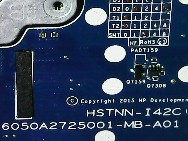

    Machine: HP Elitebook 820 G3
    Prod: Y1F04UC#ABA
    Mobo: 6050A2725001-MB-A01
    Need some info about missing components , machine was damaged with liquid spill.
    Photos attached.

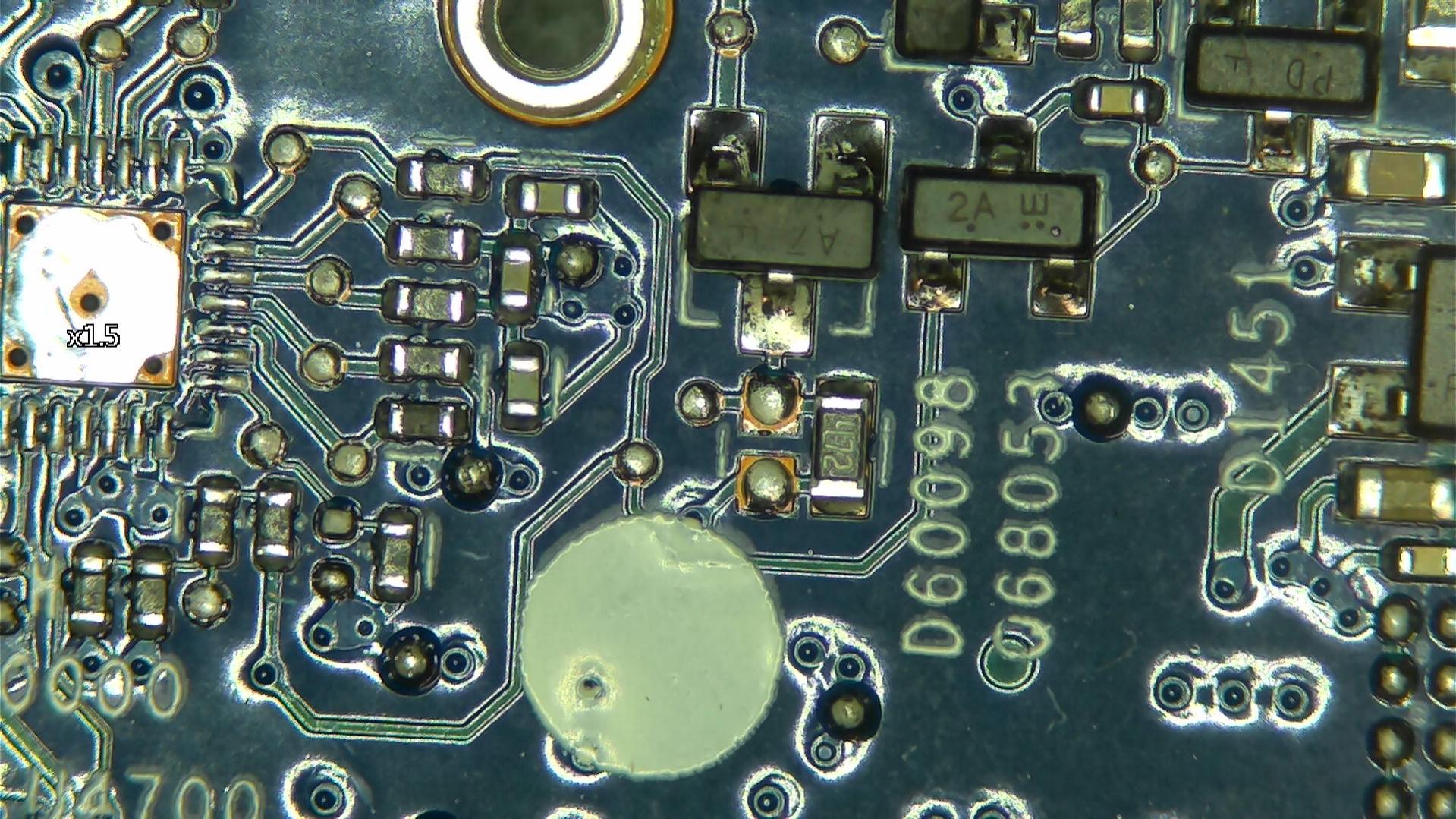

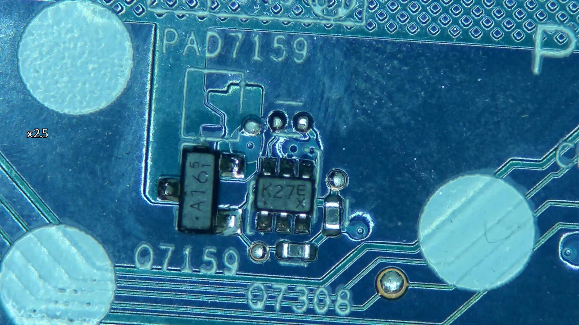

    Re: HP-Elitebook 820 G3 missing components.
    Here what I have on donor board
    Good luck !
    • Timeeez
      • Sep 2022
      • 17
      • France
      Good luck !
      Image 2 I think other than BQ there is nothing missing

        img1 just for help ID board marking.

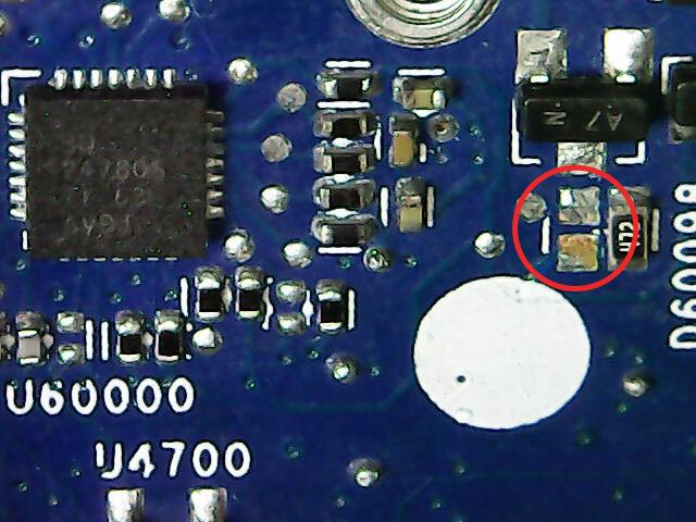

        img2 checked with your image and no component connected to D60098

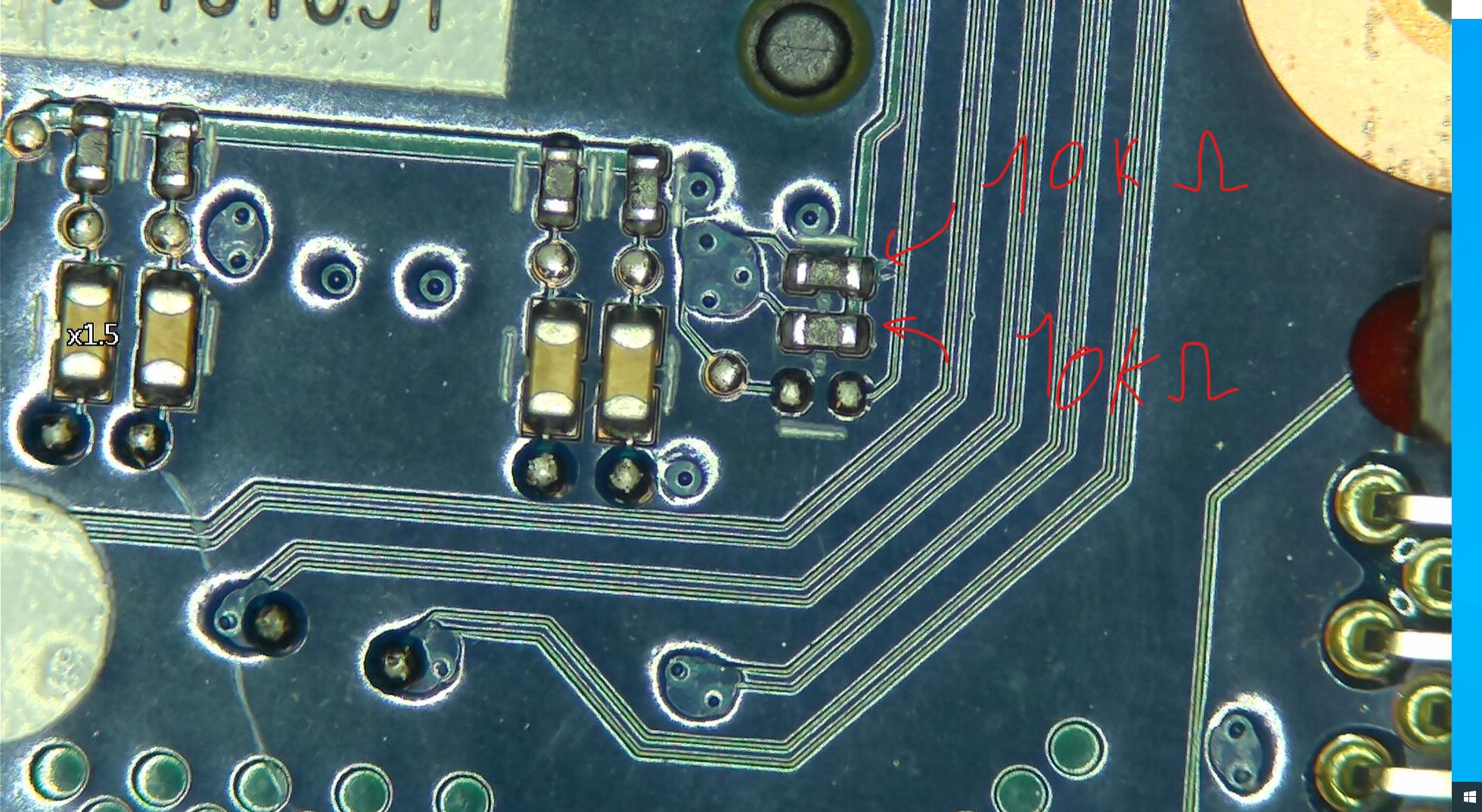

        img3 both 10k resistor, will solder news and let you know.
        Board problem: Cycling power on/off ( 3sec.)
        BQ780S Cycling Q60000 & Q60010 gates (ACDRV Pin4)
        Voltage in /PROCHOT (BQ Pin10) is 0,6V , maybe those 2 10k resistors works as pullups for /PROCHOT and CMPOUT.
        Will report back later.
