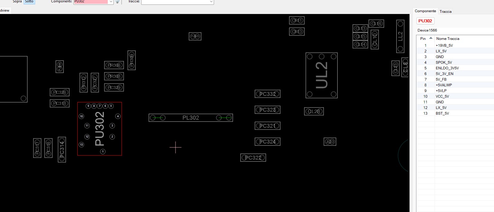

    Dear friends, I have this HP LA-H462P pc that my customer poured water on and burned the component indicated in the figure PU302, how can I know the name for the replacement?

    Most probably it's a Silergy SY8270CTMC, chip marking must be BTX***

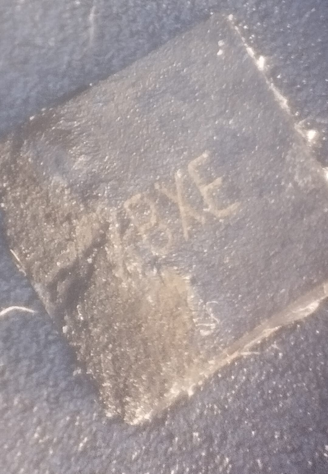

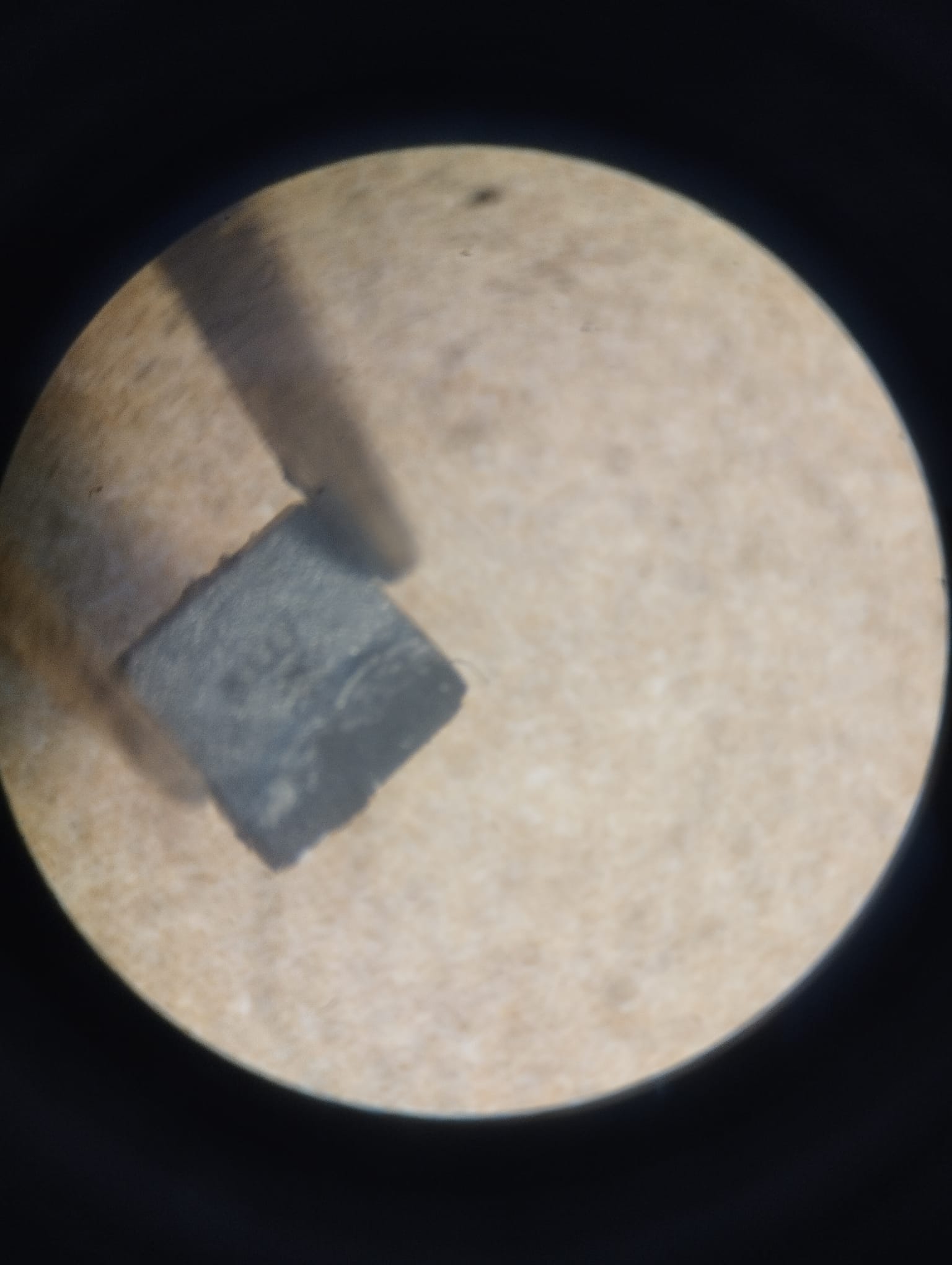

        this is what is left of the chip

          Re: La-h462p
          Post a bottom side pic of this part. I can make out 'BXE' in the markings.

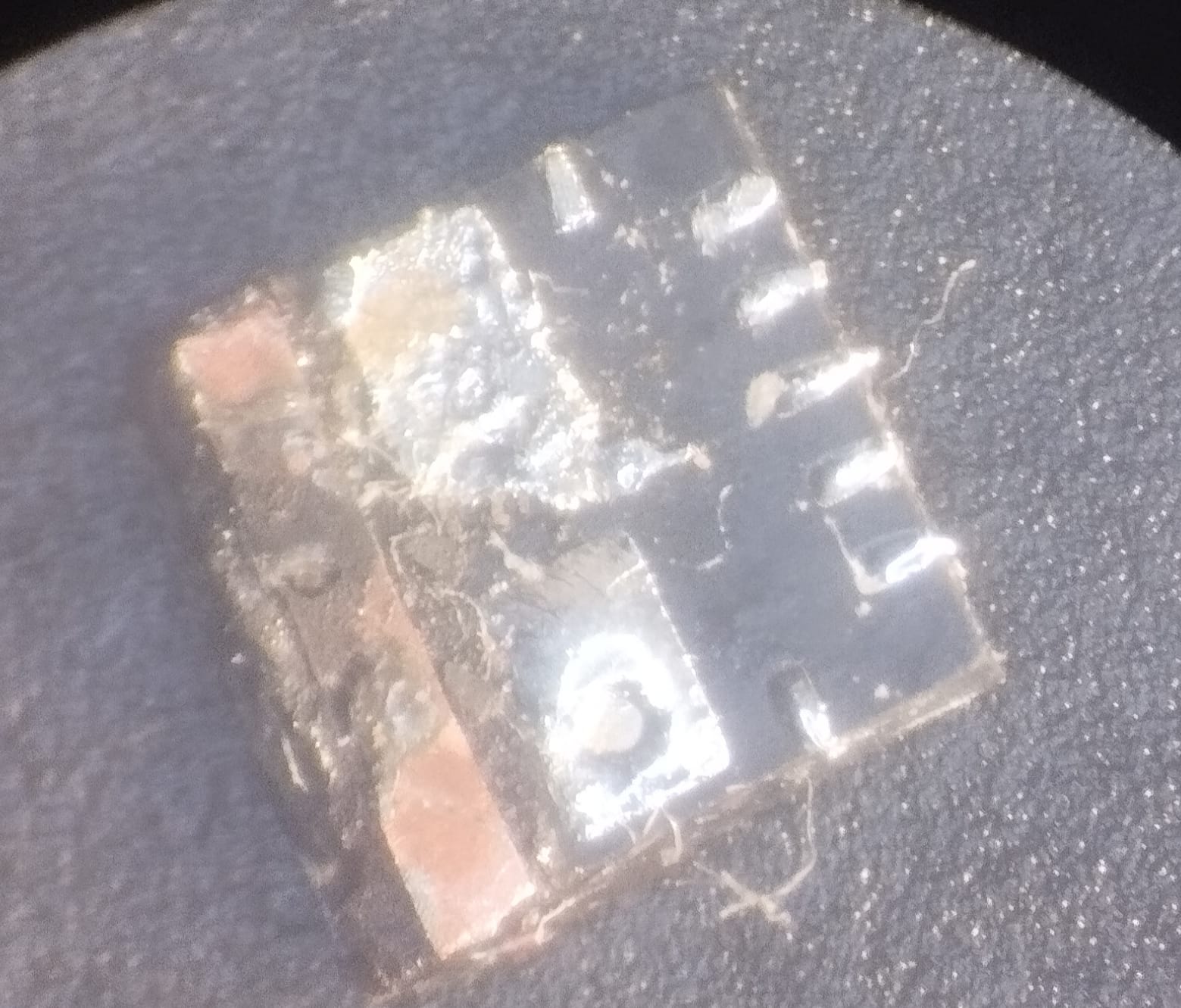

            Re: La-h462p
            is this photo okay?

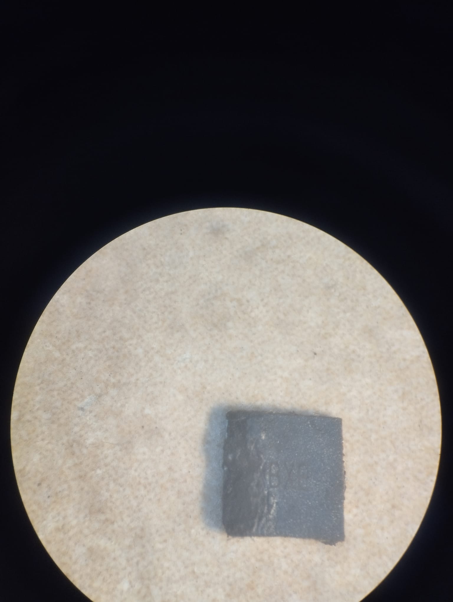

              Re: La-h462p
              is this photo okay?

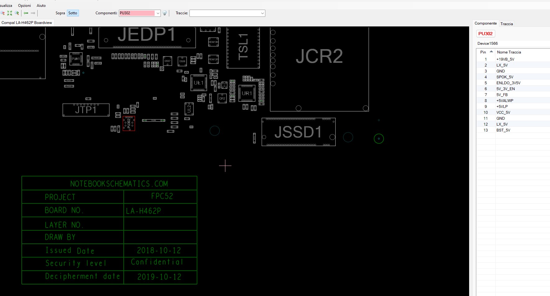

                Re: La-h462p
                FlexBV sometimes extracts more info from these boardviews. In this case, it is listed as a SY8270CTMC. So @Vesko356 gets the prize.
