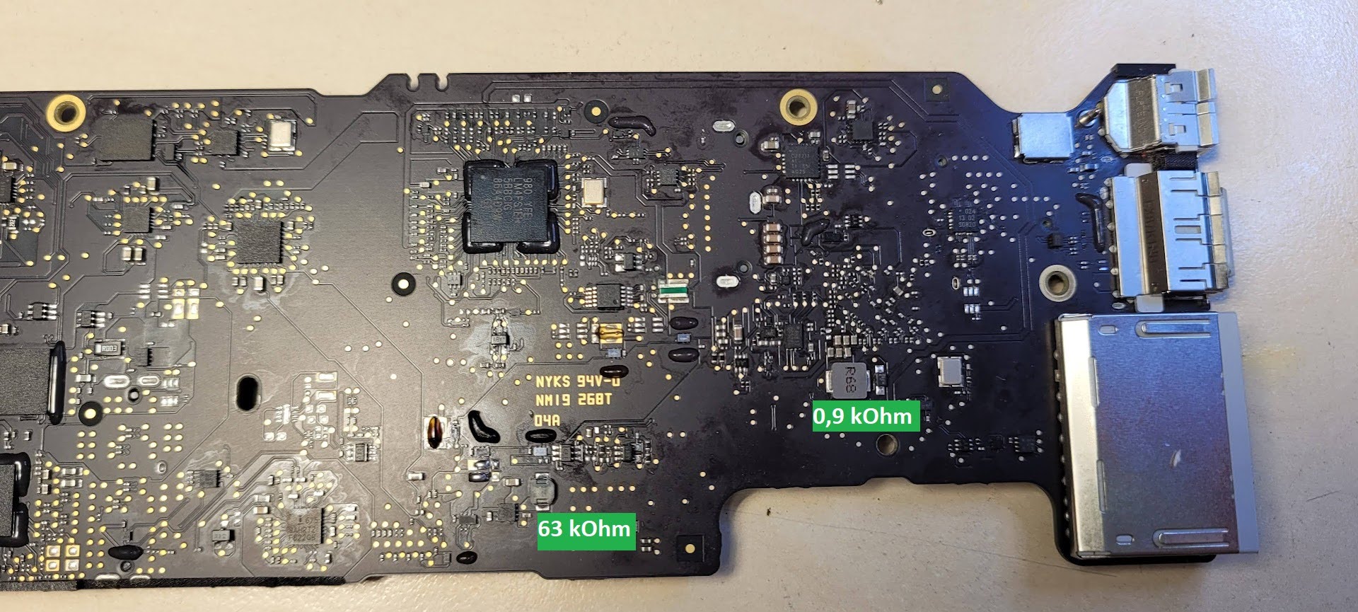

    Hi
    MacBook AIR 1466
    MB: 820-00165-A
    I followed the power scheme https://logi.wiki/images/a/af/G3_-_S...ell.drawio.png. I have all voltages up to "PM_SLP_S5_L" = 0V. When I plug the charger it tries to power on, goes to 0,250A then goes to 0,023A and does nothing. No fan spin.
    I'm confused, board looks good under microscope. No corrosion.

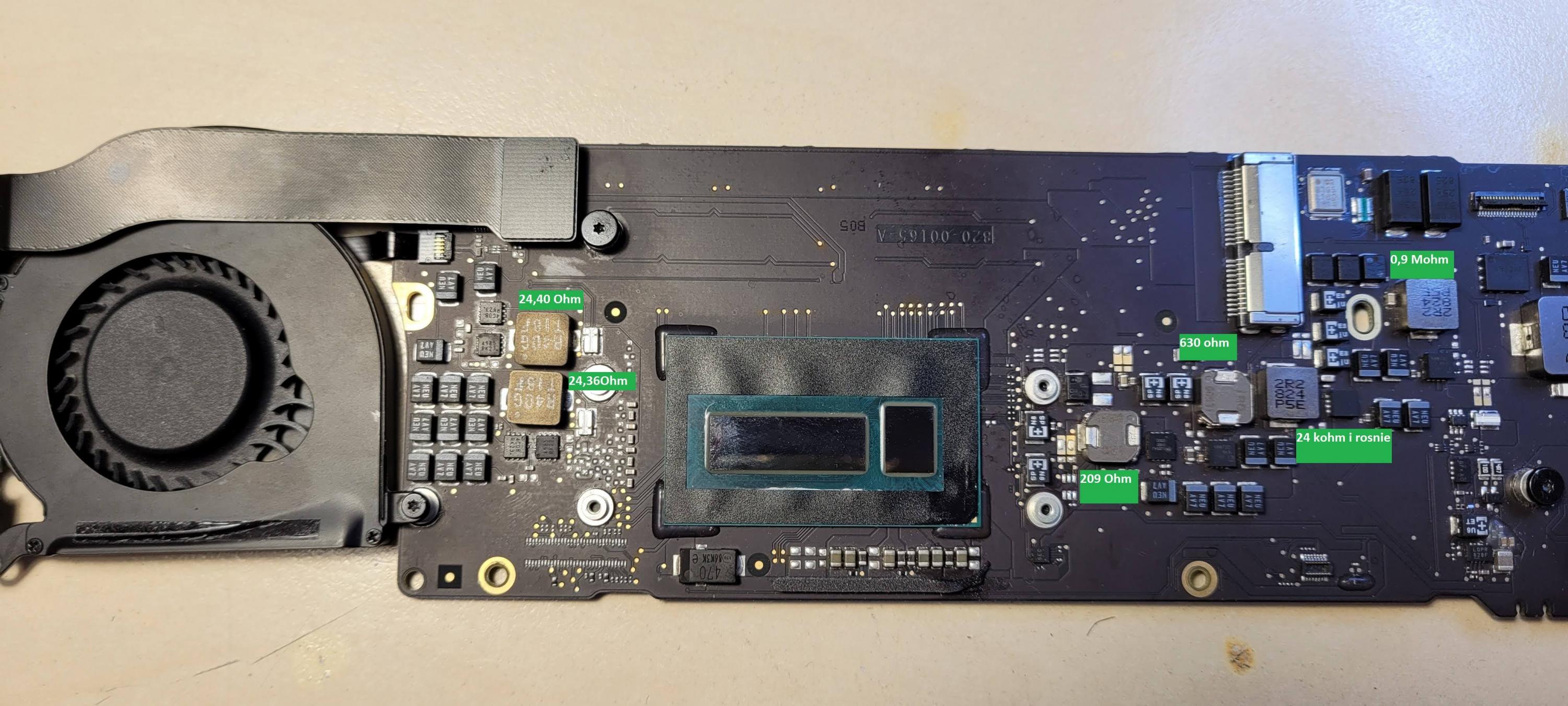

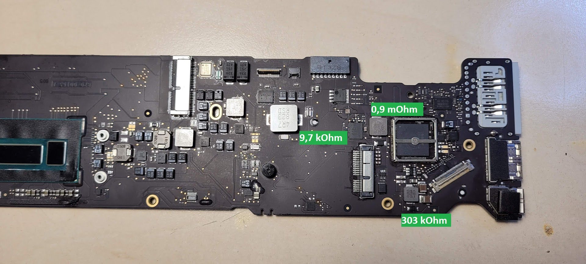

    Re: MacBook AIR 1466 [ 820-00165-A] = Missing "PM_SLP_S5_L"
    You may have a shorted part on the part which causes the current sensors to power down the logic board.
    Remove all power. Meter in resistance mode.
    Measure the resistance to ground of each coil on the board.
    Each coil is linked to a local buck regulator power rail. Checking for low resistance readings.
      Sure.
      Board is a little bit dirty with flux, because I replaced a capacitor and a TPS22924 switch.

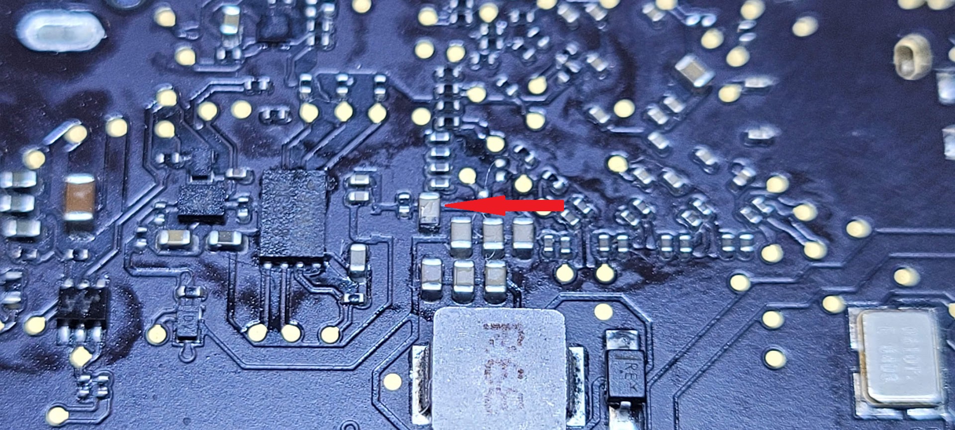

        The damaged cap in the last pic looks interesting. Check the resistance across this cap.
        • Lgolebio
          • Feb 2021
          • 9
          • Polska
          It was replaced as I mentioned. And resistance is high.
