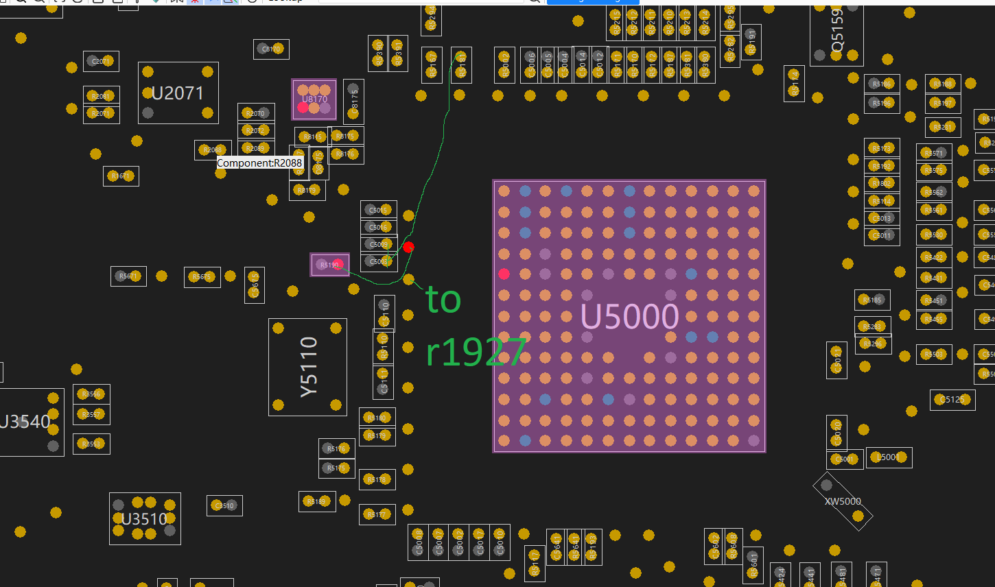

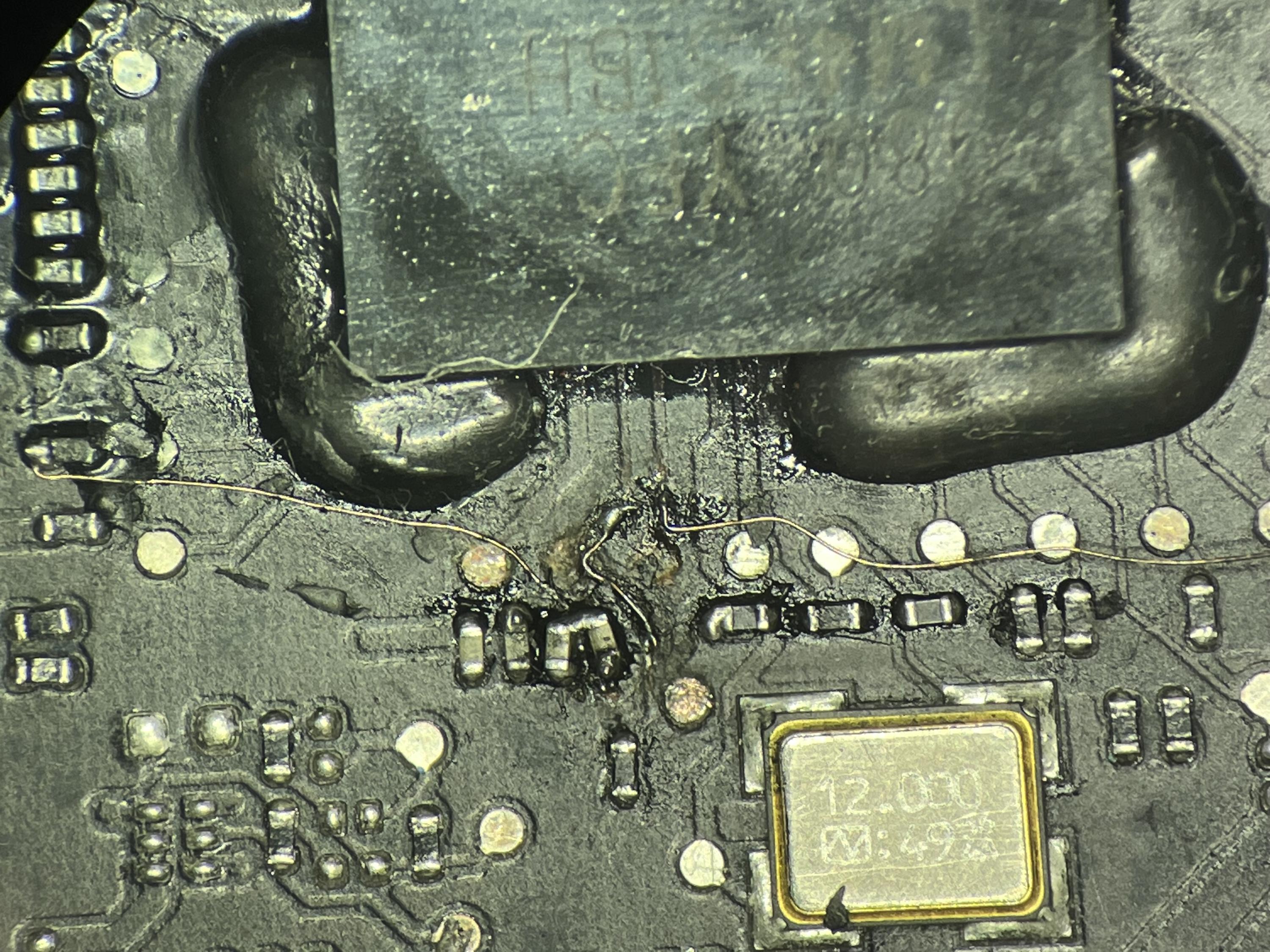

    I have this MacBook Air 820-3437. The computer doesn't boot; the lights transition from green to orange, the fans are spinning, but it doesn't boot, and the Caps Lock key is off. I found corrosion on C5009 and C5003, and two pads were damaged due to the corrosion. I replaced the capacitors, connecting the positive side to R5181 pin two since the positive pad was damaged. I made a jumper connection from R5190 to the interrupted trace, and I made a jumper from the LPC_CLK24M_SMC pad to R2197. However, the issue persists. What do you suggest checking?

    done it , Resolved: I had used uninsulated jumper wire.
