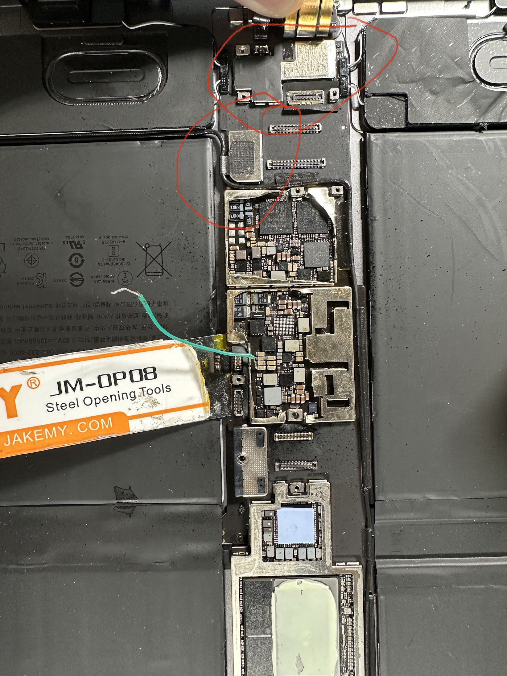

    i have an iPad A2378 dead no charging.
    disassembled and found out that 343S00389-A0 ic was hot so i took it out. after that i measure but the caps ( you can see in the picture i attached) still short to ground.
    does anyone has a clue?

    Re: iPad A2378 dead no charging
    It is a Vcc High short first check Vcc main (tantal cap near the ic you have removed)
              Originally posted by elecsoluces
              Have you removed the two top shields? There is a lot of connection in this area.
              What tool are you using for heat detection?
              do you mean the shields that i circle in the picture?
              • elecsoluces
                • May 2020
                • 66
                • France
                No Vcchigh in you red circle.
                  nothing getting hot here also..

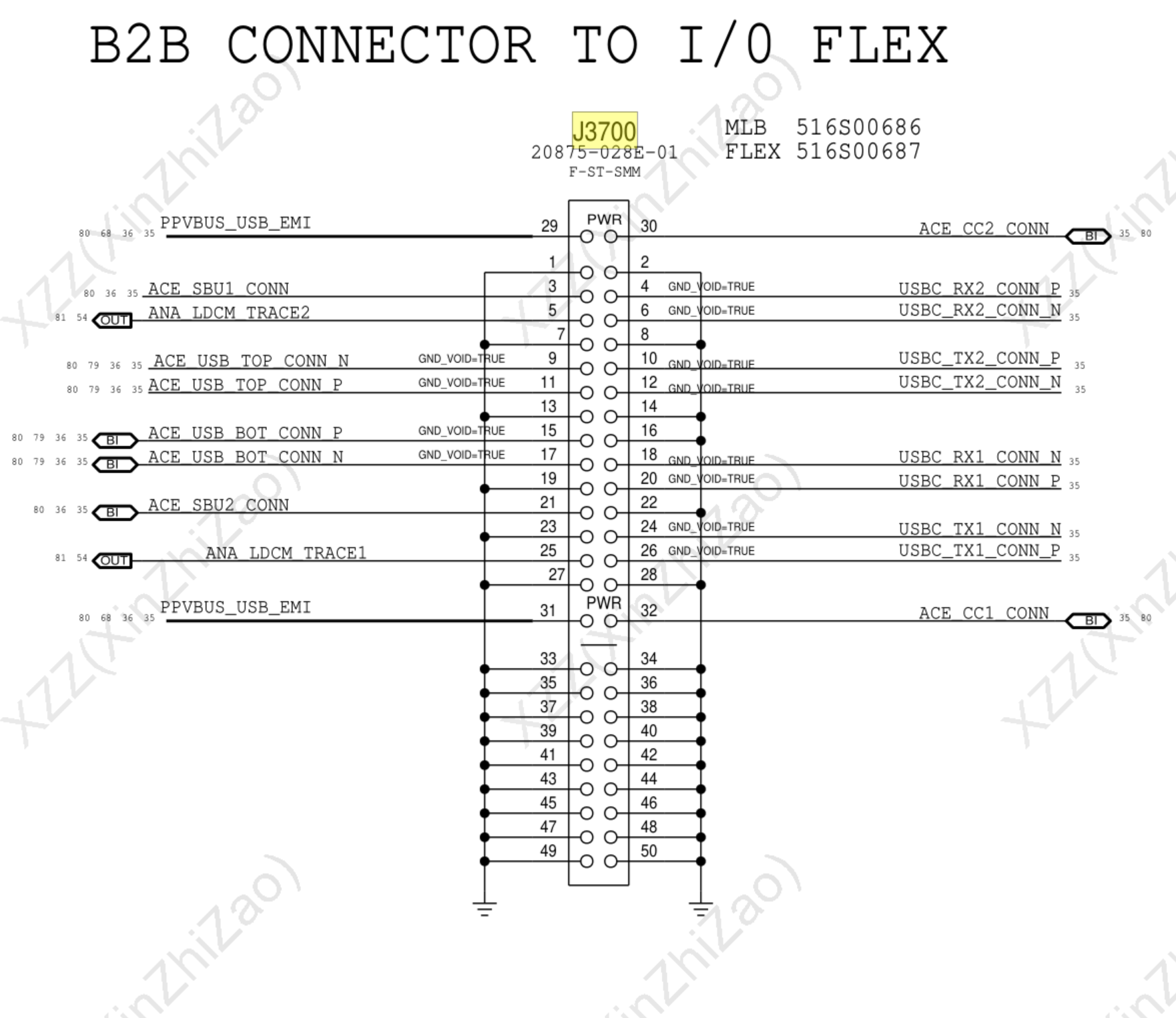

                                      So this is a USB Type C charger port? Have not seen these in the shop yet. You have a CD3217 power delivery controller onboard so the same investigation as the macbooks will apply.
                                      Remove all power -> meter in DIODE mode. Locate and review connector J3700. Lift off the charge port cable which should be removable. Then measure each signal on this J3700 connector in diode mode. Red meter probe to ground; black meter probe to pin to test.
                                      Post each measurement. Checking for a defective signal line. Something between the chargeport and the CD3217 is to blame.

                                        Thank you for the hint. I have checked all pins, all values looks ok. I have here an iPad Pro 11" 2nd gen which have same chip. The values are all the same. Also checked with usb-c tester, also everything is ok.
