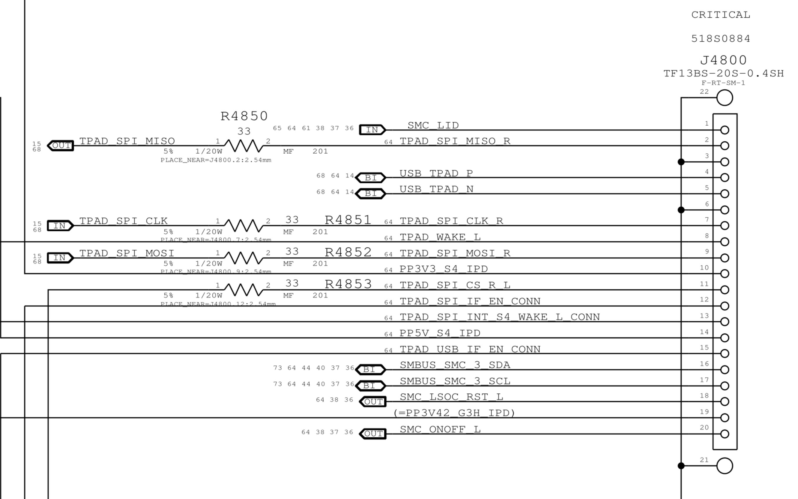

        Re: Macbook Air a1466 no keyboard and no touchpad
        Remove all power. Meter in DIODE mode.
        Connect your keyboard / trackpad.
        Red meter probe, yes red, to ground.
        Black meter probe to point to test.
        Measure the diode mode reading of each pin on the trackpad connector J4800.
        Post each measurement with the pin # being tested.
            I think pin #8 is ok due to R4844 being mated with ground.
            Now apply power and check the voltage to ground of each pin. Measure with caution as the power is active.
            The diode mode readings look ok to me and do not show a short.
                Pins #16 and #17 are not the correct voltage. Remove the interconnect cable and review the voltage to ground of these 2 pins again.
                These pins must return to a logic '1' due to local pull up resistors required on all smbus interfaces.
                Confirm it. If still missing, locate the pull-up resistors for this pair and check if the pull up voltage is present or is missing.

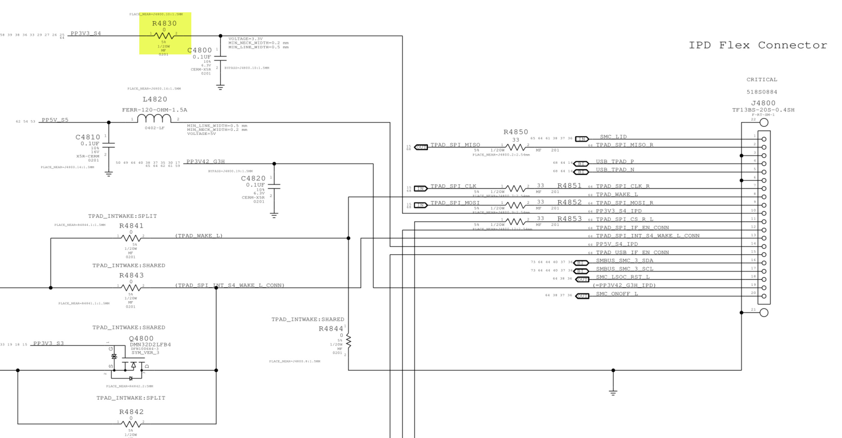

                          should the output of Q4800 (to pin 13) be 3.3 ?
                          @reformat, can you please elaborate on what you written ? about the TPAD_SPI or explain what should i measure ?
                            Measure the voltage to ground on each side of R4830.
                            • koby058
                              • Jan 2017
                              • 373
                              • israel
                              it is 2.47 on both sides

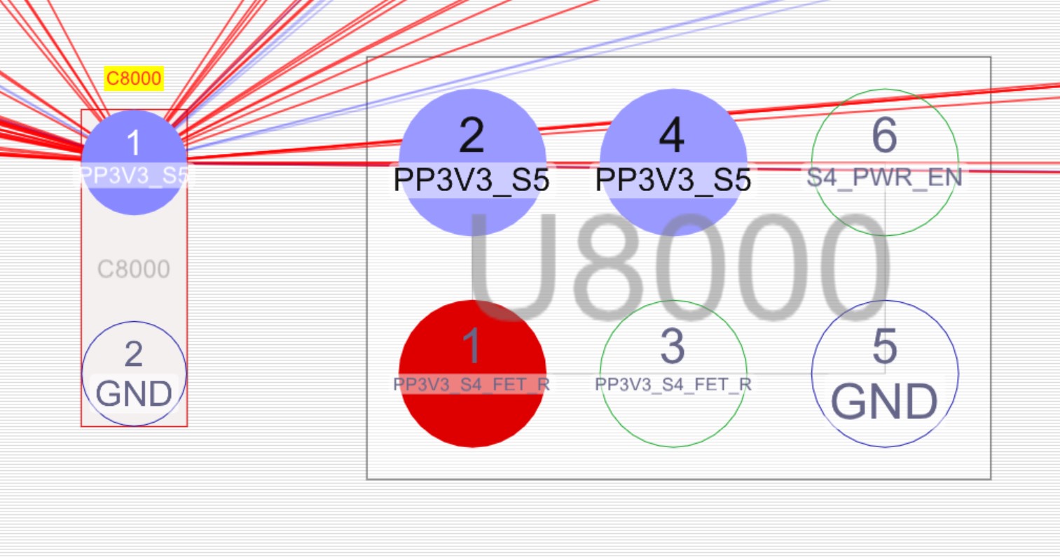

                                That is a low voltage and it should be 3v3.
                                Measure the voltage to ground @ U8000, input pins A2 / B2.
                                What is the voltage?
                                See attached. If the voltage is 3v3 then proceed to remove all power.
                                Meter in resistance mode.
                                Measure the resistance to ground of PP3v3_S4 rail.
                                What is the resistance?
                                Suspecting that the loadswitch @ U8000 is defective but will wait on your checks.
                                  I can see that U8000 is having a bit of corrosion on it, and i cannot measure it
                                  but i can see 3.3v on pin#1 of c8000.
                                  forgot about the resistance, i will do it tomorrow since it is late at night now
                                  Will reply with results in the tomorrow
                                  Thanks a lot Mon2
                                    Hi
                                    It is 3.7K ohm
                                    • mon2
                                      • Dec 2019
                                      • 14002
                                      The resistance is ok but suspecting this load switch is now defective and should be replaced.
                                      Assuming the enable pin is active (pin C2), the load switch is faulty.
