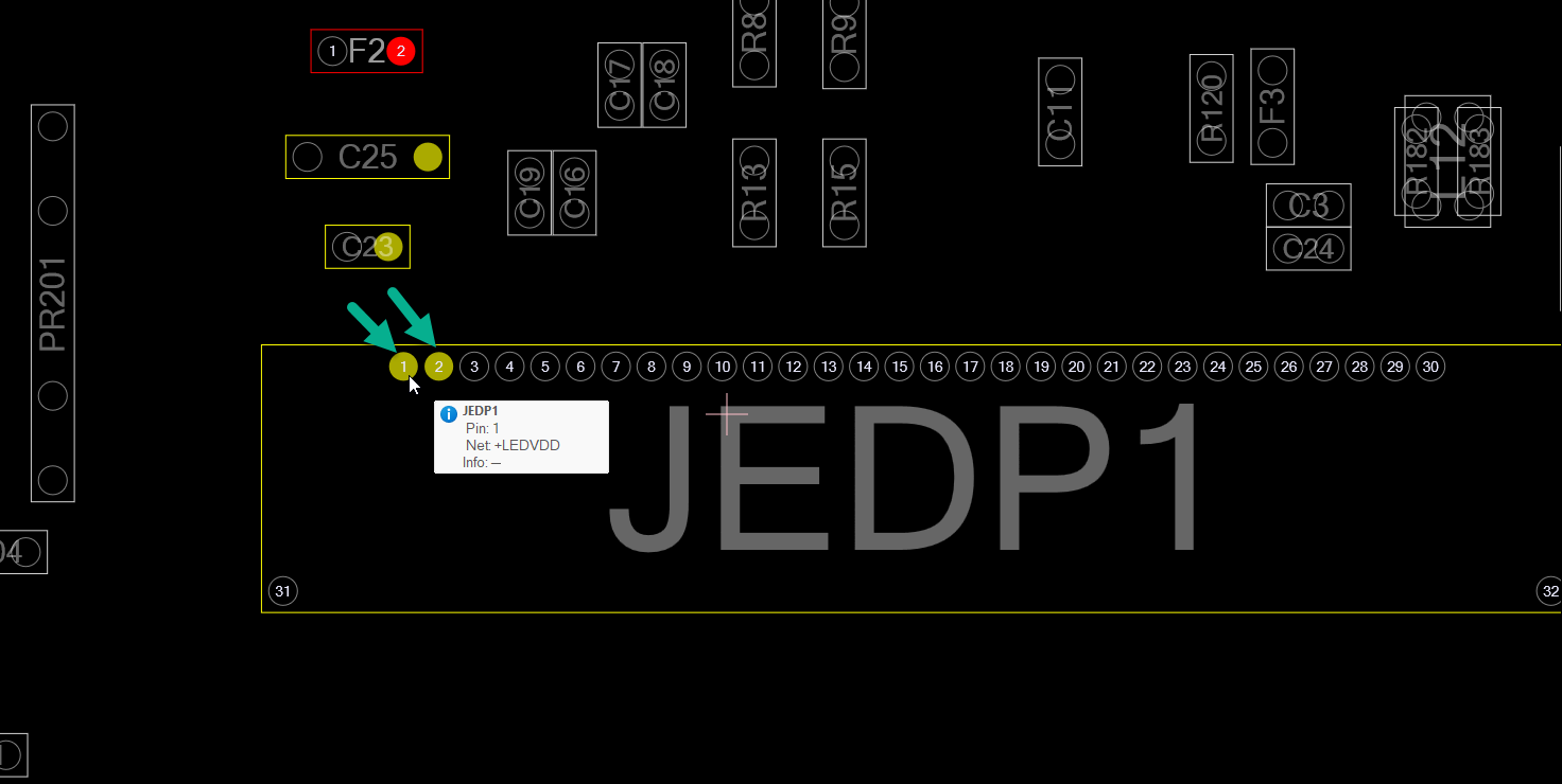

                    Confirm the same voltage is able to reach the LCD display connector - see attached and check where the arrows are shown.
                    To be safe, remove all power. Meter in DIODE mode. Short the meter probes and should hear a beep tone.
                    Next, one probe on either side of the fuse @ F2, other meter probe to the arrows in the attachment. Do you hear the tone beep?

                      I have 0.6 everywhere

                        I got the wrong motherboard. I have one where there is no sign of life and on the one in continuity the fuse f2 is good but on the motherboard where I have a very dark display no beep in continuity mode.
