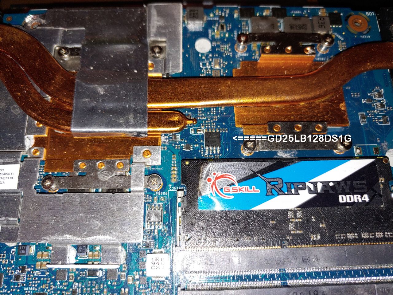

                      I noticed as the keyboard cycles thru on/off/on/off repeating cycle, available voltage rails follow the same. They appear, then disappear. Is it possible that the BIOS on this machine is bricked and needs to be rebuilt?
                      • swammyw

                        Re: FX505DT IT8987E
                        i have this same issue with same laptop, no picture and restart loop, have you made any progress?

                          #32
                          Re: FX505DT IT8987E
                          ok, i had actually bad bios and i fixed it with ch341a programmer & good bios dump dl from bios request, btw ch341a can flash 1,8v bios chips if 3,3v mod is done & if u disable/ insulate pin 8 from chip

                            #33
                            Re: FX505DT IT8987E
                            Actually, I was thinking about reflashing the BIOS since laptop's behavior indicated issue with the motherboard software. Can you, please provide clean BIOS file for me to try? The one you mentioned that worked for you? Also, can you tell me BIOS chip location on the motherboard?

                              #34
                              Re: FX505DT IT8987E
                              bios chip is between ram cpu & gpu, on top of upper ramslot, there is same kind of chip leftside of upper ramslot but i dont know what that is, my message got deleted when i uploaded biosfile to previous post but it was, FX505DU.zip, badcaps.net*forum*showthread.php?p=969483, actually tbh my case was corrupted ec firmware but it will auto flash it with this bios when making first boot

                                  #36
                                  Re: FX505DT IT8987E
                                  Swammyw, take a look at the snapshot. Is that the BIOS chip you were referring to? This is the only chip I found that has a matching size. Others are kind of smaller in size.

                                    #37
                                    Re: FX505DT IT8987E
                                    yes, that is bios chip, i think it is worth to try flash it, if the fault is in ec or bios fw
