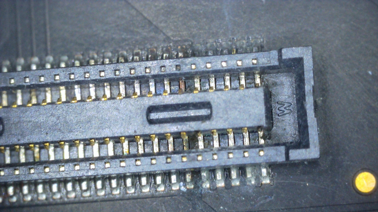

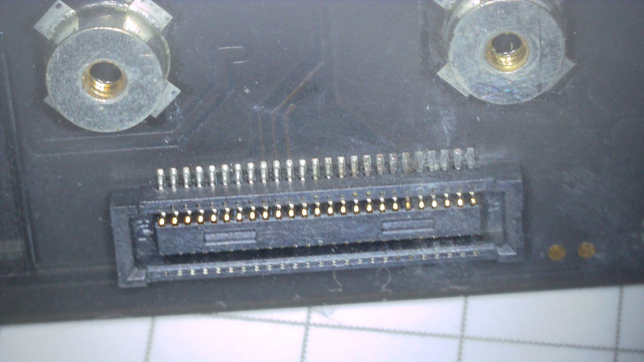

    Hello out there.
    I purchased this mac MacBook Pro 13'' M2 chip, model A2338, logic board number 820-02773 as partially working. Seller give me an apple report saying: "Liquid spill on trackpad flat, BMU battery flat and logic board. Macbook starts only when connected to DC IN and show intermittent shoutdown".
    Now that I got it is does not start at all, Amp mether shows 5V 0A on both usb-c.

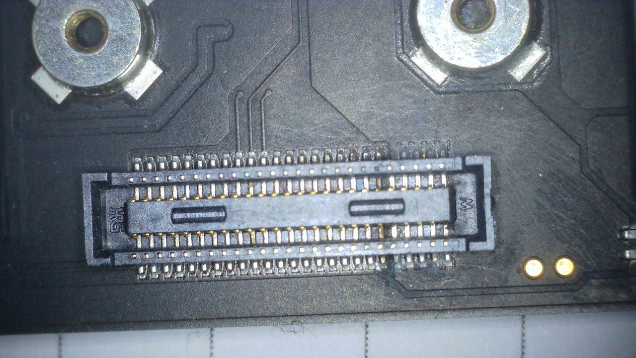

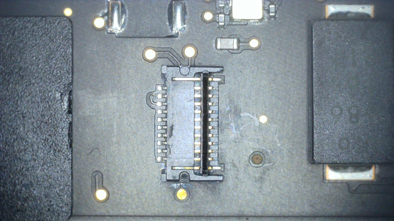

    Tearing down the logic board I can confirm there was liquid spill on the battery connector area and the battery flat. Liquid spill also on the trackpad connector and small amount on the antenna wifi connectors. I guess there was also a little moisture on the Q5800 side (referring to 820-02020 board view as 820-02773 is not present at this time).
    The back side of the board is pretty clean, no sings of corrosion or cleaning.
    The fact is that this moderboard was already cleaned from moisture, so I need to better check everything under microscope. Futhermore it seems to me that i'm hearing the famous clicking sound also in that board. But no components it's getting hot when plugged in.
    I would be glad if somenone more skilled that me will help me troubleshotting this Mac to have it finally working. That would be really appreciated.
    What I can start testing with my multimeter?

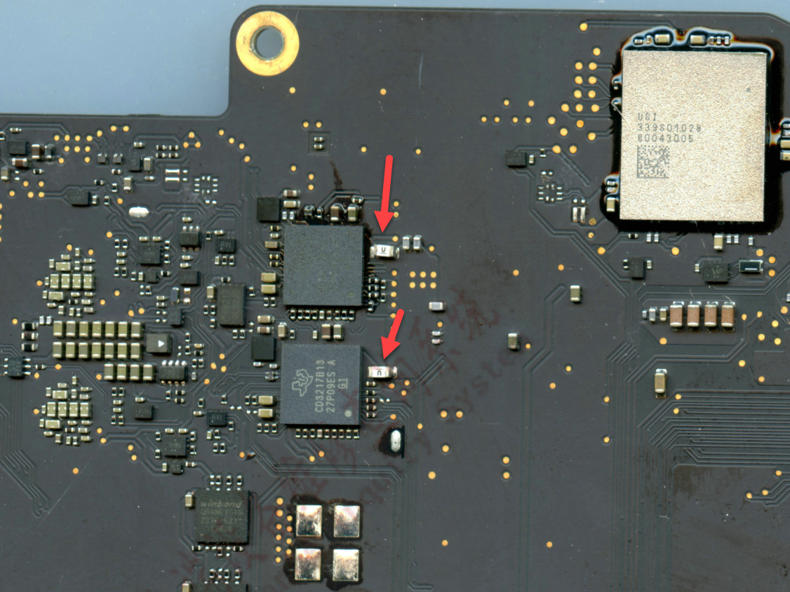

    Since the current draw is @ 0v and stuck @ 5v, start with a review of the USB Type C controllers (aka ACE controllers).
    See attached.
    Remove all power. Meter in resistance mode. Check the resistance across the white body parts = fuses.
    Post your measurements.

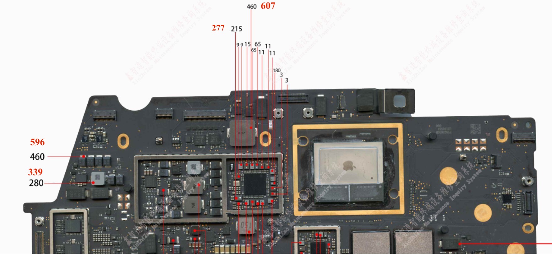

      I also took those measurement (please mind that I'm using 820-02020 brd as reference):
      voltage on PPBUS_AON on FP800
      1 PPBUS_AON 12.3V
      2 PPVIN_LCDBKLT_F 12.3V
      voltage on PP3v8_AON
      L5800
      1 P3V8AON_VSW1 3.78V
      2 PP3V8AON_PH1 3.78V
      PP3v3_S2 voltage
      LC710
      1 P3V3S2_SW 0V
      2 PP3V3_S2 0V
      CD3217 support voltages
      RP844
      1 PP5V_S2 0V
      2 PP5V_BKLT_D 0V
      PP3v3_S2_UPC NOT ABLE TO LOCATE
      C5320
      1 PP1V25_S2 0V
      2 GND
      PPDCIN_AON_CHGR_R
      C520C
      1 PPDCIN_AON_CHGR_R 5.17V
      2 GND
      series of current sensing resistors
      R5221 — 1.4 Ω
      R5222 — 1.4 Ω
      R5261 — 1.4 Ω
      R5262 — 1.4 Ω

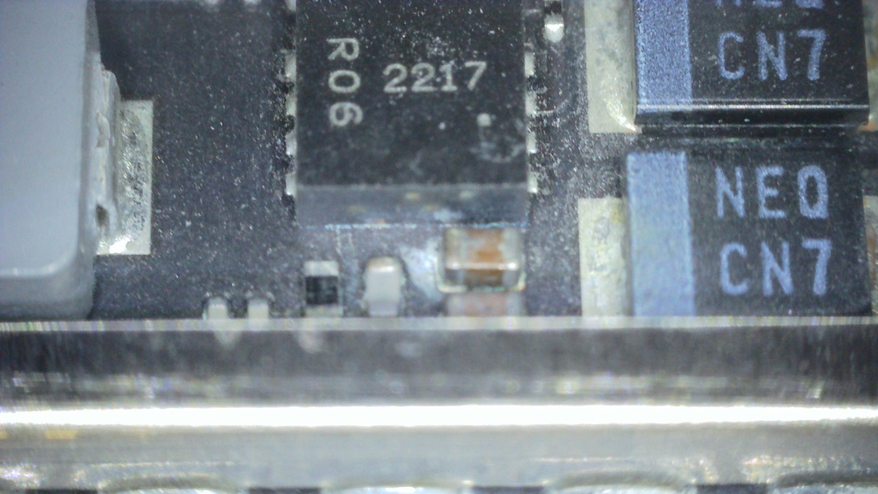

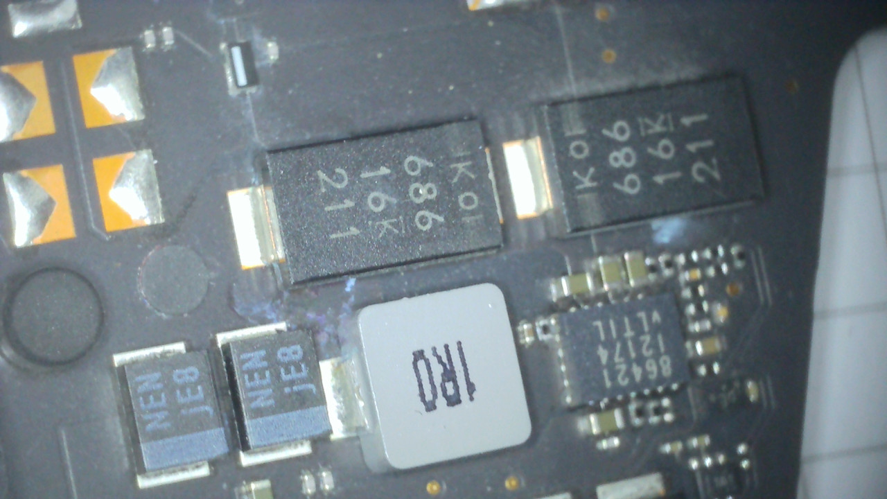

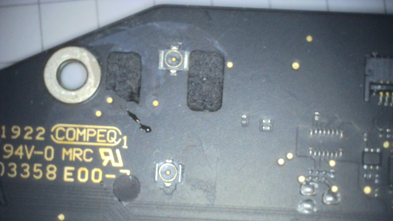

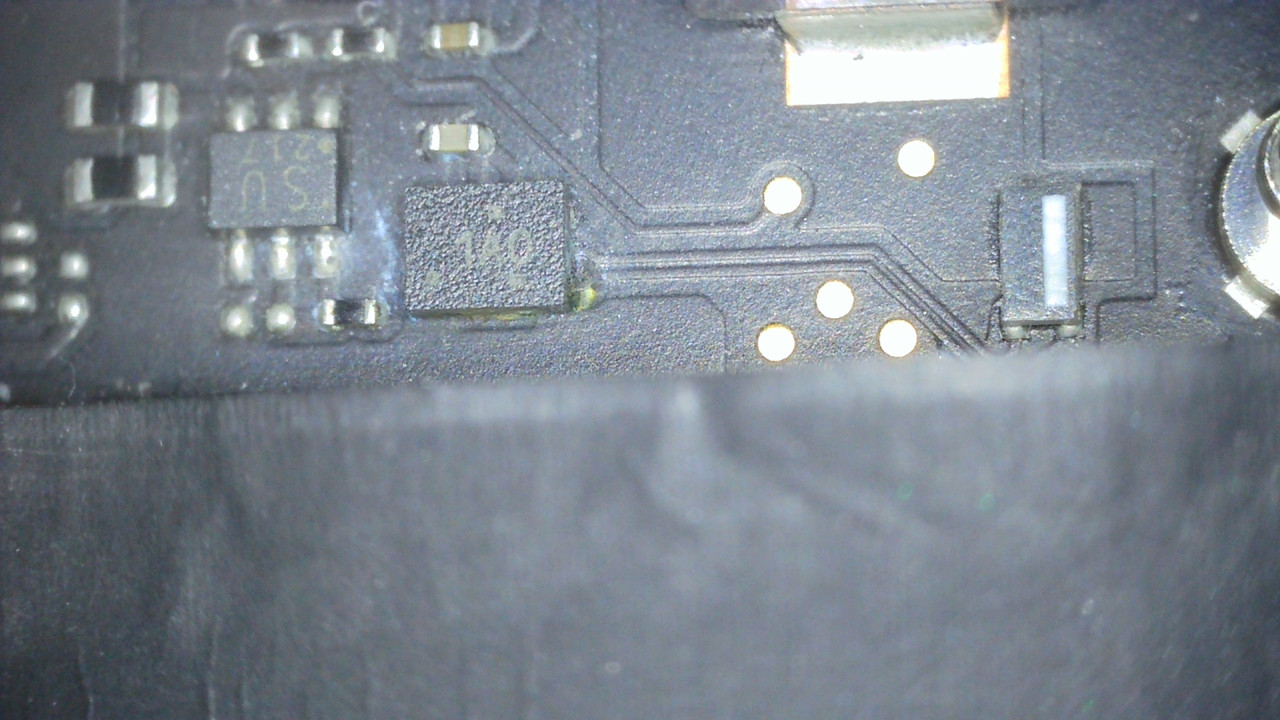

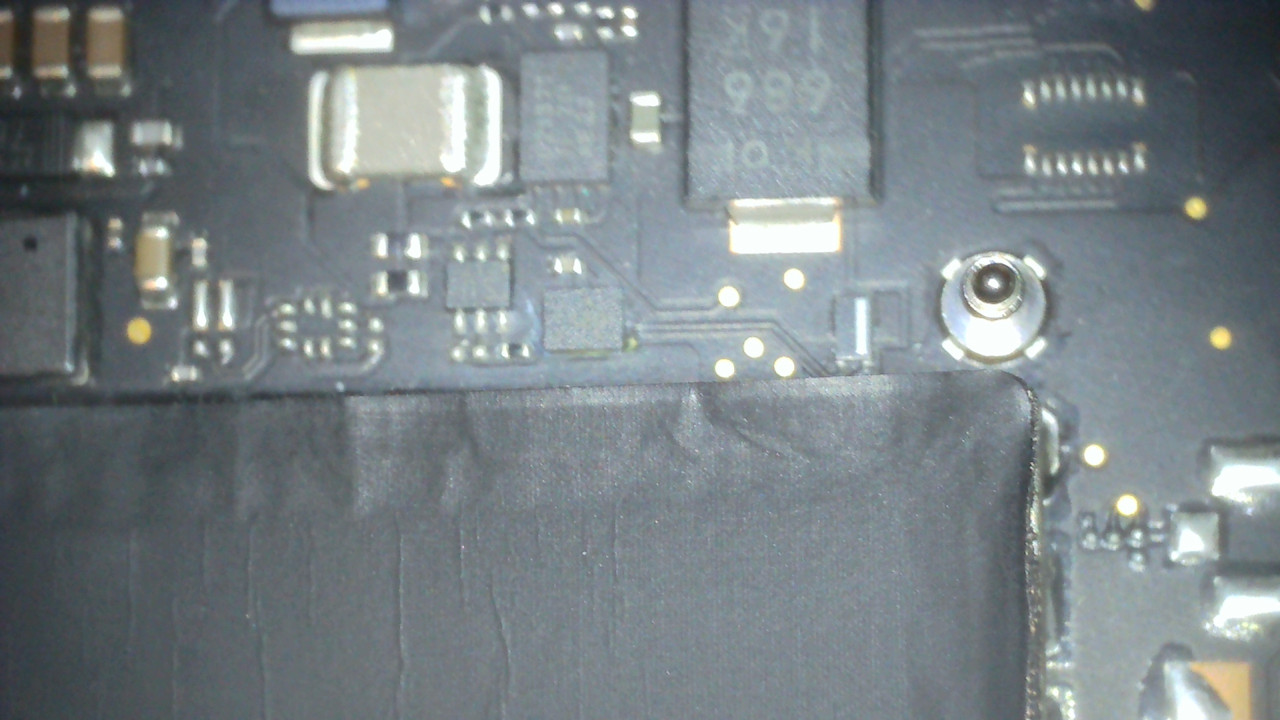

      Upon investigating board on microscope I found this spot of corrosion, see attached. Mainly around JT200, Q5840, C5800, UD560 areas.

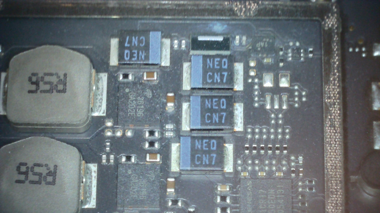

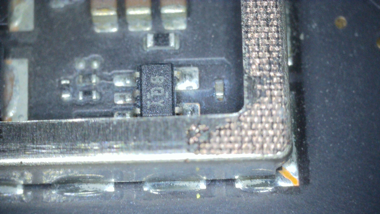

        Any of these part w moisture could be related to the problem?
        • mon2
          • Dec 2019
          • 14474
          Re: MacBook Pro 13'' M2 A2338 get 5V 0A does not boot. 820-02773
          Perhaps. Pour alcohol (IPA) and see if these sites can be cleaned up.

            I guess the voltage of each LDO rail is present on each of the CD3217 devices.

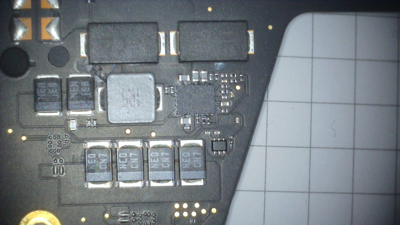

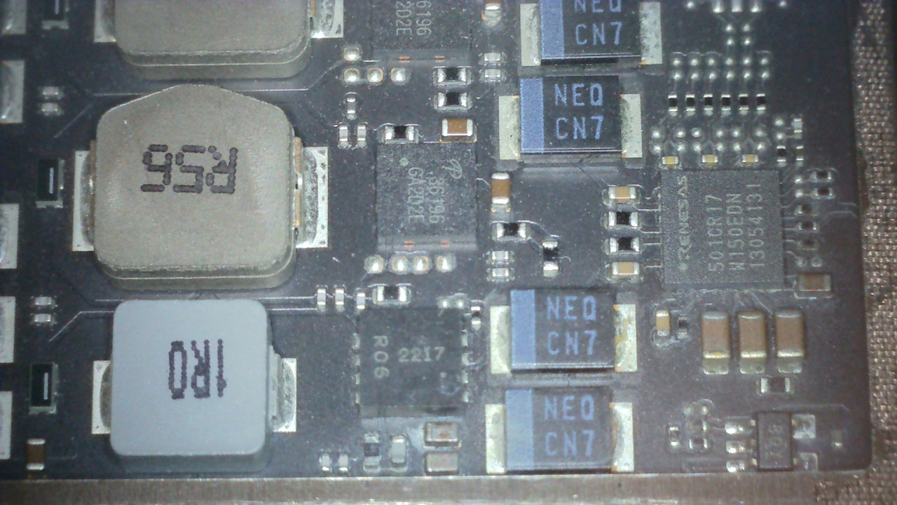

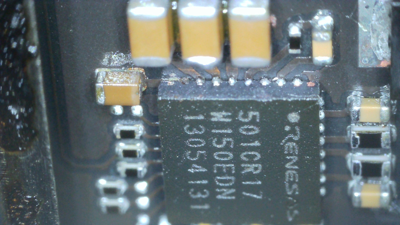

                  Ok, damn, upon checking voltages in renases chip area I deadly short the IC. Now the board is taking 5.16V and 0.43A, consuming 2.2W. That chip is pretty hot. Any advice how to find a replacement?
                  That would be different from RAA225501A A2338 2020 logic board I guess.
                  Mine is 501CR17 H150EDN 19054131, the other is 501CR0B.
                  damn damn damn damn
                  Last edited by SMDFlea; 05-16-2023, 05:15 AM. Reason: added external images to badcaps
                  • mon2
                    • Dec 2019
                    • 14474
                    Check the resistance to ground at the output of this regulator.
                    Post the measurement. If the resistance is low (and futile) then that explains why it is heating up.

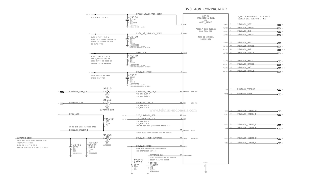

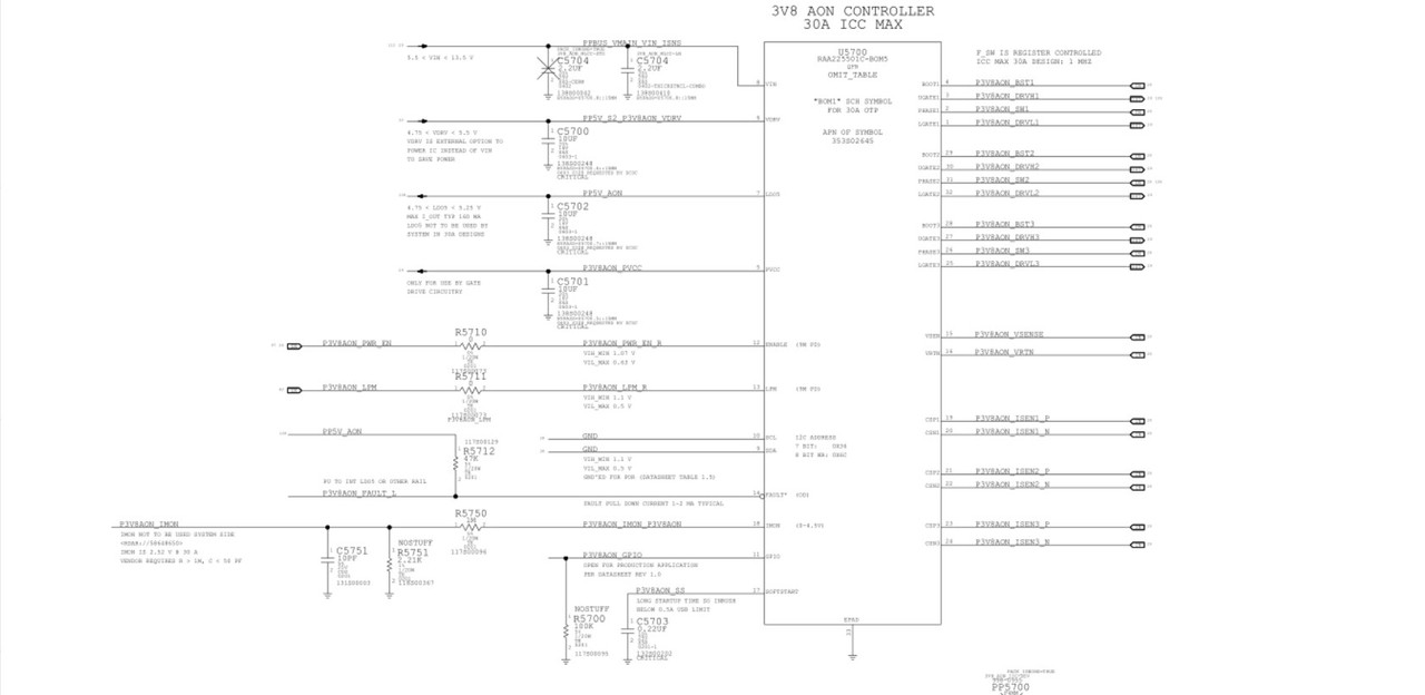

                        Ok - found it - it is U5700.
                        All output pins need to be checked for their resistance to ground. Remove all power.
                        Measure for example,
                        pin #7 (LDO5)
                        pin #5 (PVCC)
                        pin #3 (UGATE1)
                        etc. - review the direction of the arrows on this component's library symbol in the schematic and measure each such pin to see if there is an excessive load.

                          U5700
                          5 P3V8AON_PVCC 5.2Ω
                          7 PP5V_AON 4.4Ω
                          Are pretty shorted. I'm facing difficult on measuring other IC output.
                          I found that A2338 M1 2020 820-02020 and A2338 M2 2022 820-02773 seems to share same U5700.
                          It isn't?

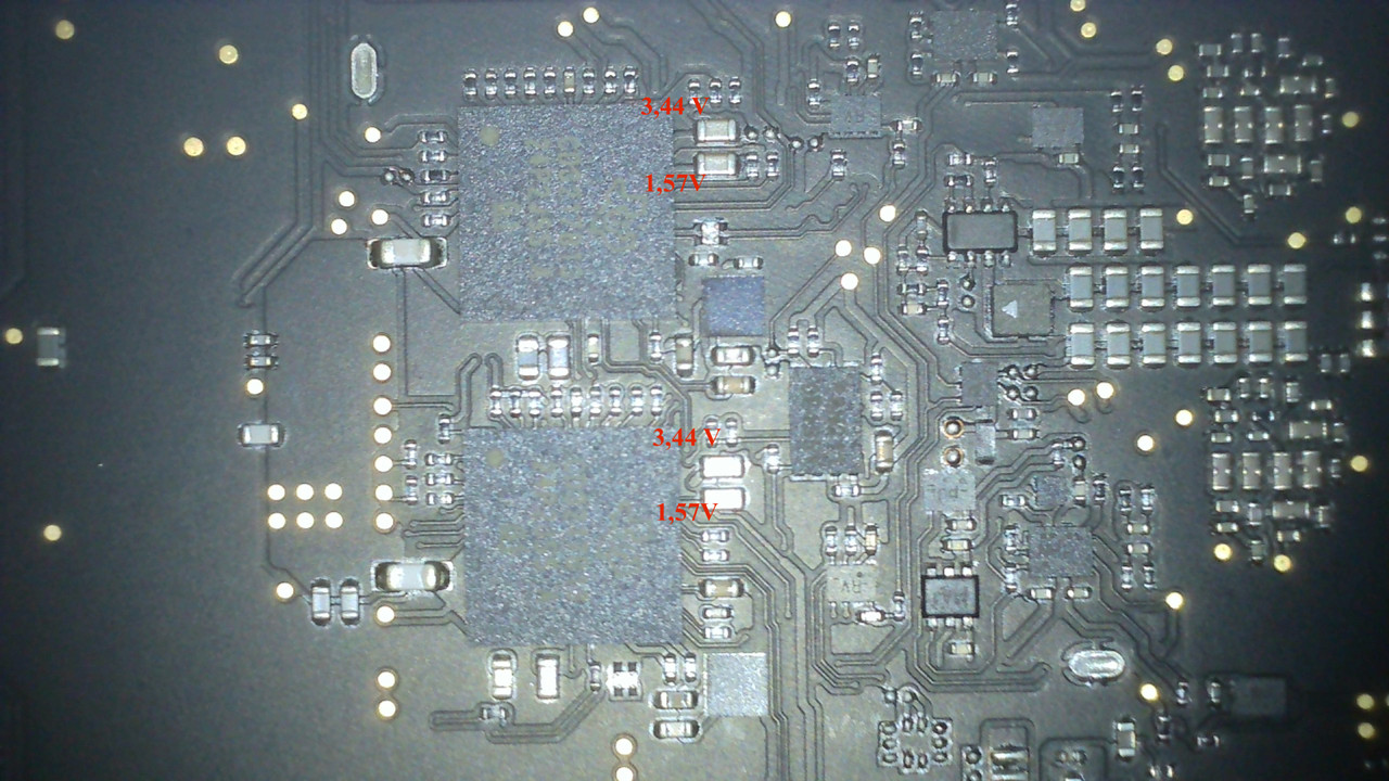

                                As always, you were right. My type c meter is trusty, always use the same one and is bidirectional. Connecting to the transformer adapter side (not logic board side) I can detect 5.237V and 0.034A.
                                upon re-checking LDO rails and fuses for each ACE controller seems right. But I have not voltage on S2 rails.
                                Anyways I found schematis, boardview file and power supply diode mode reads pdf on famous chinese app. So from now my references are right for A2338 M2 820-02773 logic board.
                                PPDCIN_AON_CHGR_R 5V on both ports
                                LDO outputs
                                PP3V3_UPC1_LDO 3.44V
                                PP1V5_UPC1_LDO_CORE 1.58V
                                PP3V3_UPC0_LDO 3.44V
                                  PP1V5_UPC0_LDO_CORE 1.58V
                                  To me, the PP3V3_UPCx_LDO rail outputs seem high. These should be close to 3v3 according to the schematics.
                                  For now, let us ignore this.

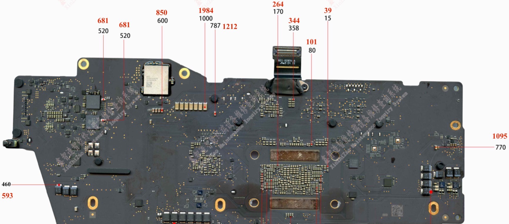

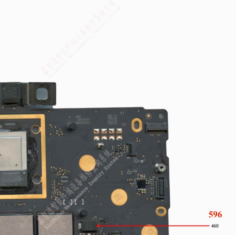

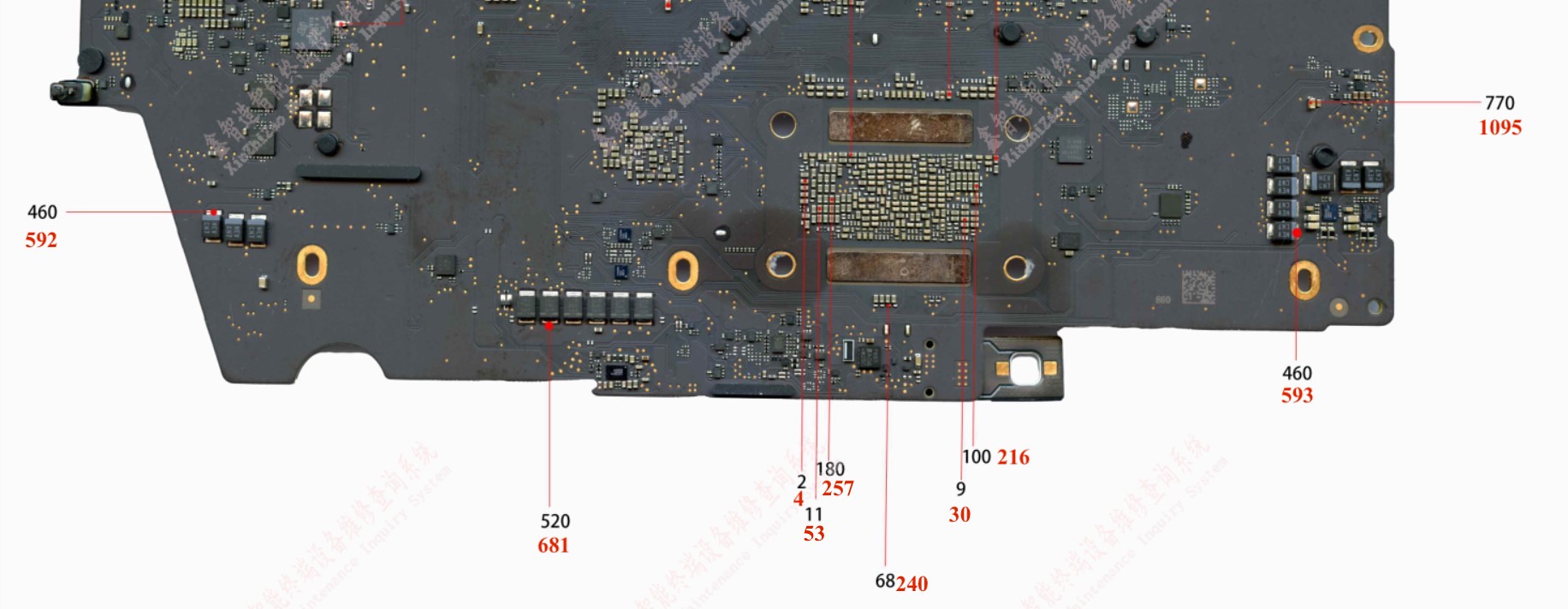

                                      These are the measures I take in diode mode. Mine in red, black one as reference.
                                      I'm not able to find any problem by myself.
