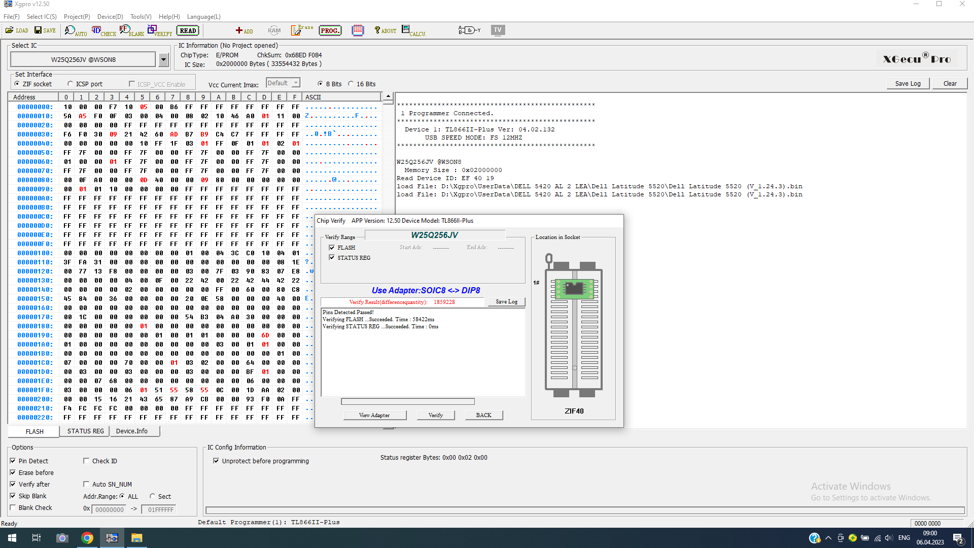

the chip its W25Q256JV
if i write all chip ff flash and compare are ok.
if i write data - its not ok
darckreign1984
04-06-2023, 12:01 AM
darckreign1984
Join Date:
Apr 2011
Posts:
260
Country:
Romania
04-06-2023, 09:27 AM
Re: tl866 II plus - write fail - verify error
solution for me was - XgproV1080
- this flash without error tested 10 times, and compare
