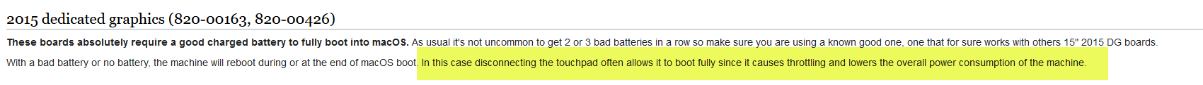

    hi got this board with a burned hole in the vram zone. owner reflower gpu and cpu for no reason ( he watched online video and think that this method will fix every problem). after find gpu totally shorted, i decided to make it uma.
    after send it back to owner he told me board was crashing, so i replaced also the 3 cpu mosfet, telling him that if that doesnt fix the crash, i give up on the repair.
    after replace the 3 mosfet, board was shutting down while loading os, and after asking owner if battery was ok and he told me it was.... i discovered that with another battery pc was booting fine with trackpad connected.
    now the board load macos and all ok, but if i close the lid screen goes off, but fan stay on, and if i reopen the lid macbook stay that way (black screen and fan spiining)
    is that an smc problem or it's cpu pch related ?

      edit: problem is that this mac wont fully work if battery is dead or not present... i told the owner and 1st time he send me mac with almost dead battery, and this time he send me mac without battery....
      without battery macbook start loading and at 30% of loading bar it restart in this loop.

        Re: macbook 820-00163no sleep wake problem
        Try the attached.
          yes without trackpad it works fine, but doesnt go on full sleep mode. owner told me sleep doesnt work even with a new battery and trackpad connected.

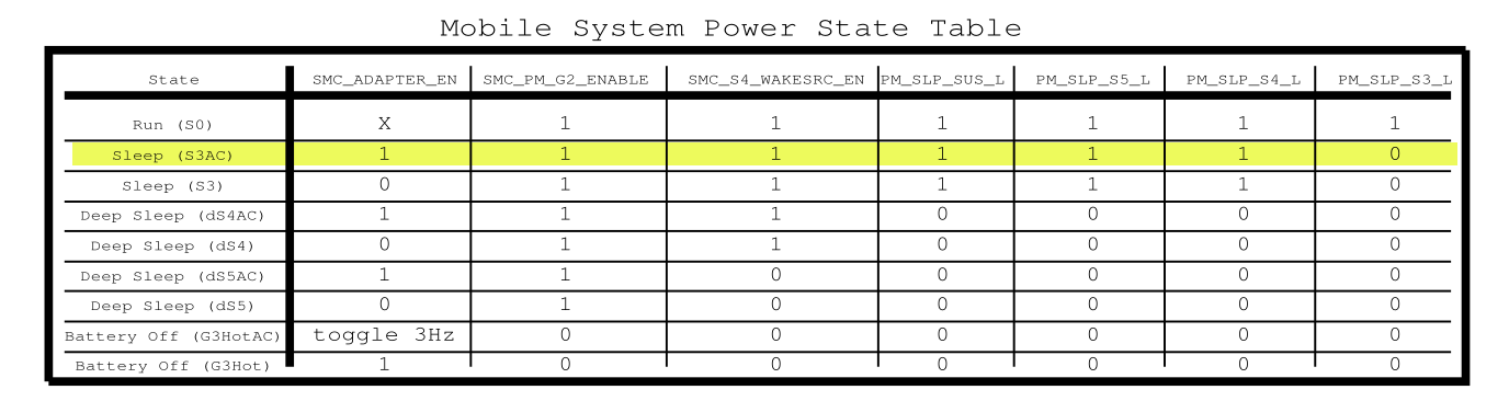

              • mon2
                • Dec 2019
                • 14326
                I would check the logic levels of the attached table to see if the conditions are being met.
                  tnx again. i think problem is related to uma conversion . ive seen that when it goes to sleep it wake up keyboard backlight , but screen backlight and image stay off. because it's uma now i cant test with external display.
                  what i have found is: i followed a tutorial for 820-3332 conversion to uma, but on that tutorial it was written to solder 3,3 volt to lcd_bklt_en and lcd_pwr _en, but now on that https://www.youtube.com/watch?v=XVzpMY8s9is yt video i see that he send 3,3 volt also to lcd_bklt_pwm, and i didnt connect that point to 3,3 volt.
                  tomorrow ill remove once again the mainboard and inspect the solder wire i did.
                  edit: ive watched whole video now and in the end he removed that lcd_bklt_pwm line, but that part is for controlling backlight, while in my case whole lcd stay black.
