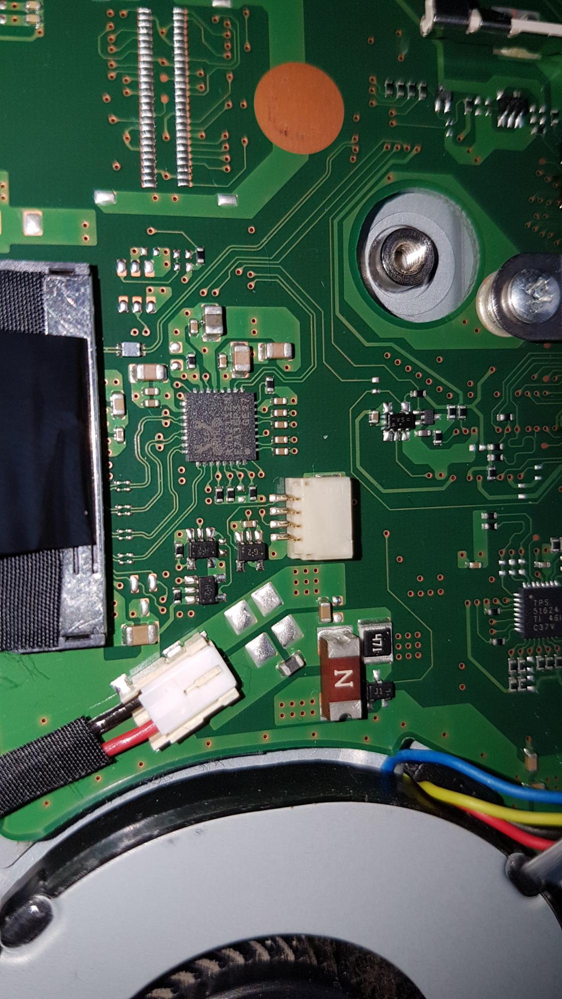

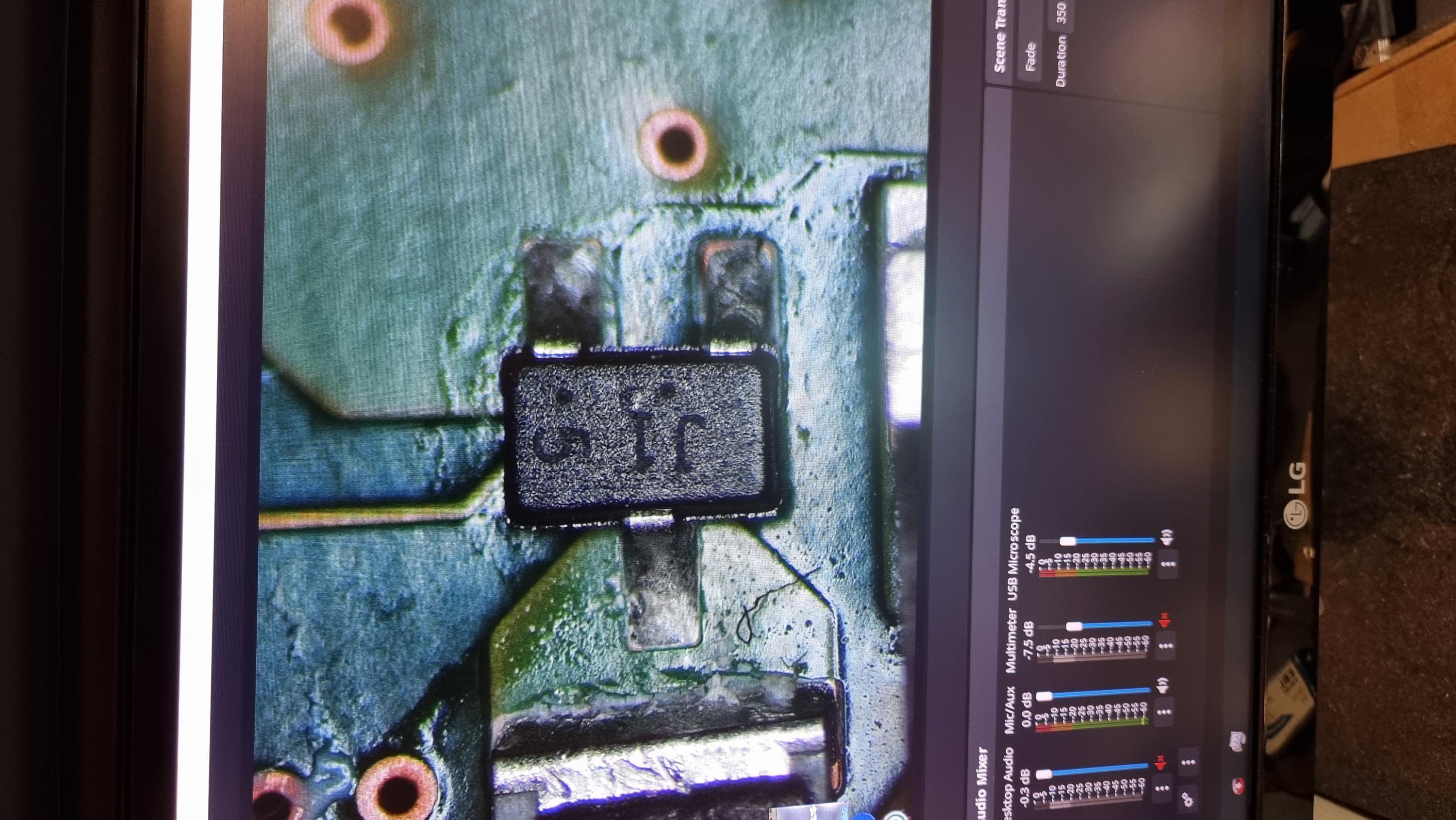

Help identify J1 chip Toshiba R50-B Laptop

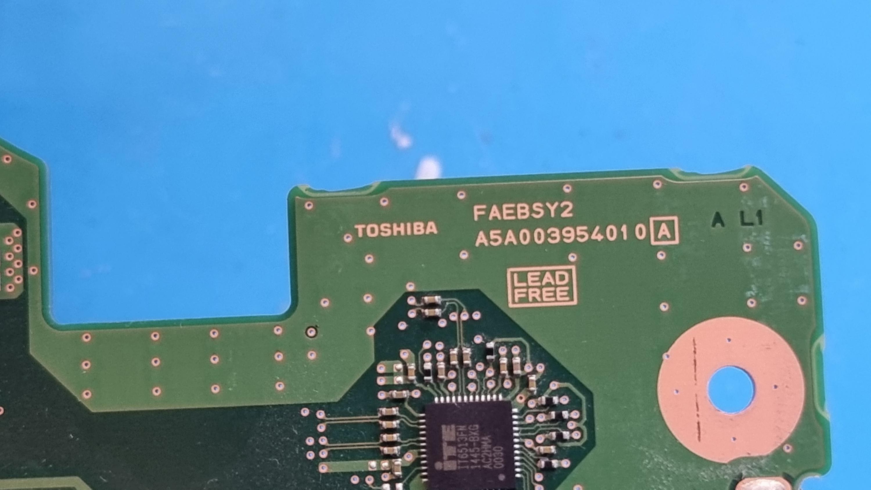

    Re: Help identify J1 chip Toshiba R50-B Laptop
    Faebsy2 motherboard model
      Top 2 pins are ground
      Other pin connected to 19v rail 470 ohms resistor
        It's BSS138 Mosfet ..
          How did you know Jiroy?
              Originally posted by sikocan
              But pin 1 and 2 are in ground. Doesn't make sense.
              It's definitely a BSS138 , now what's its purpose here , i need a schematic to tell ..
                I don't know, but 19c charger V comes into a 470ohm resistor then to this ic.

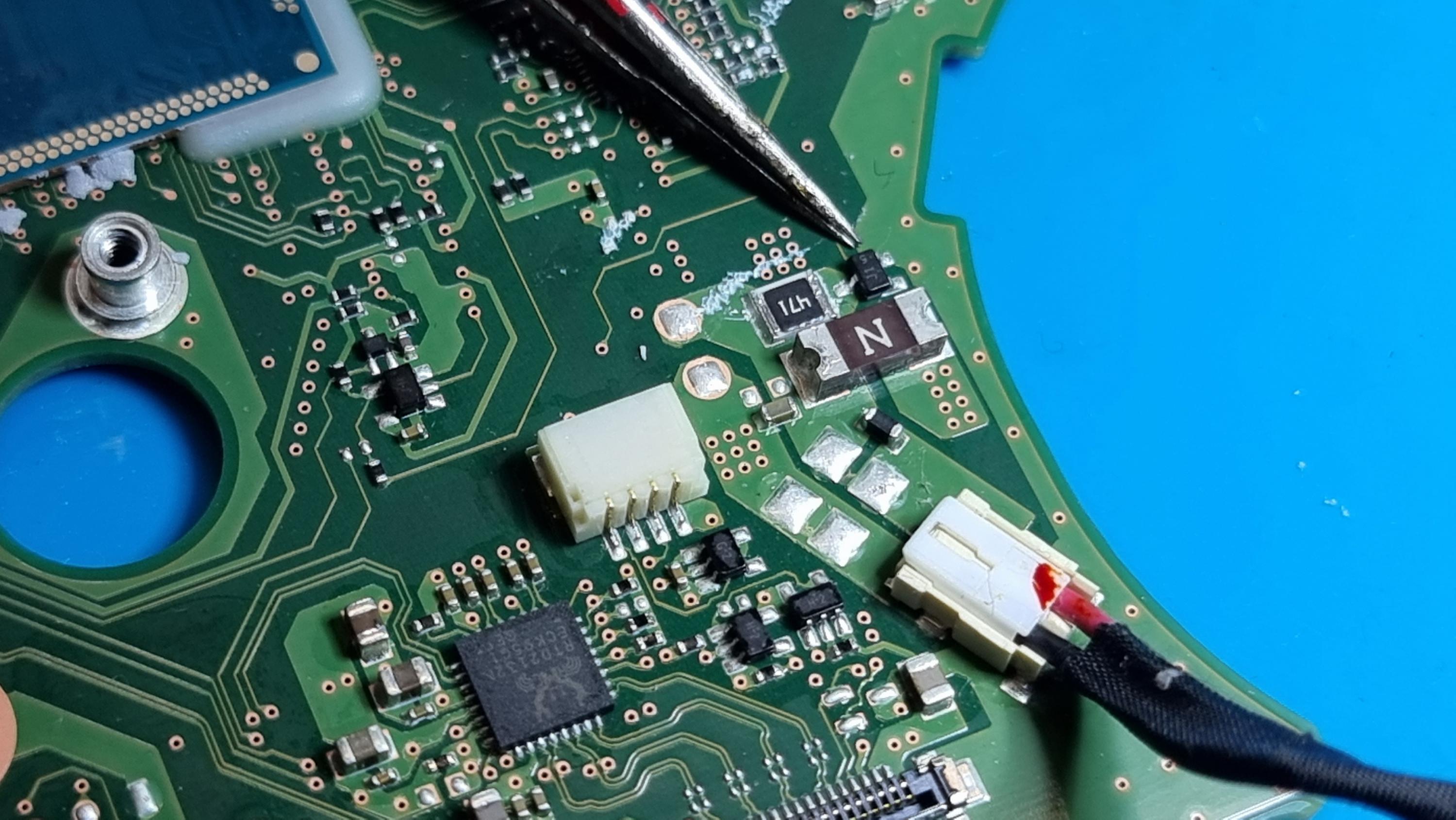

                  I'll check my schematics to see if I have this model .. In between , I've seen even some transistors used as only a 2 pins diode , so I can't tell right now .
                    They don't look connected to me, there's a gate drive trace going under the component. Maybe discharge MOSFET.
                      The best I could get is a high resolution picture from a similar laptop R50-B , Not a schematic .. It shows clearly that the 2 pins aren't connected to the ground otherwise they would be soldered on the same trace , logically .
                      Now either , like Piernov mentioned , discharge mosfet , or check if something abnormal happening like an open or short mosfet .
