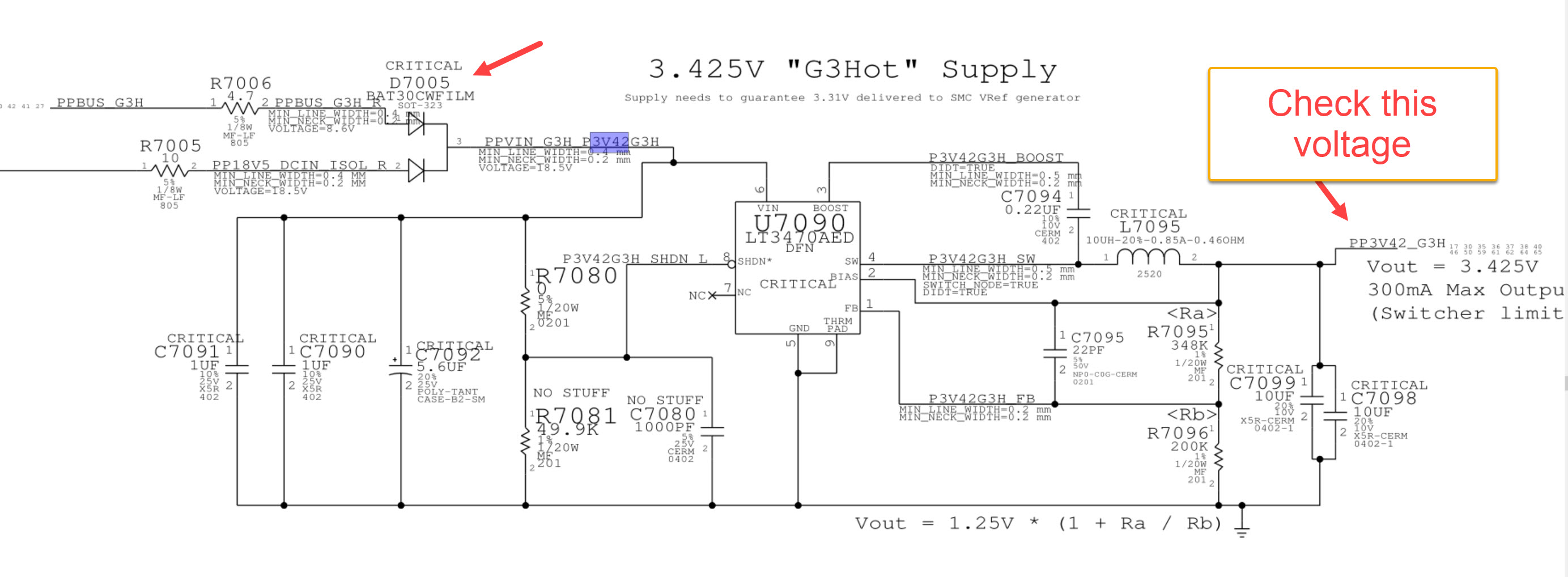

    I am troubleshooting a Macbook Air and the SMC posts a voltage of 8.2V at PPBUS_G3H.
    Should I replace the SMC?
    Macbook appears dead with no green light on the charger and no fan spin.

    1) what is the exact 820-**** number of your logic board ?
    2)
    A key power rail, that is 3v42 is missing. It is this power rail that powers the single wire Dallas / Maxim Semiconductor LED controller and soft-turn on of the power supply. If the magsafe hood led is missing then this power rail is missing.
    After you post the logic board #, we can review this power rail but often it is the DUAL common cathode diode that often fails.
    Attach your power adapter and measure the voltage to ground of each of the pins on the dual diode that feeds the above regulator.
    Post each measurement.
    Update - see attached.
    1) Check D7005 voltage to ground of each pin.
    2) Check the voltage to ground of PP3V42_G3H. Suspecting that this power rail is missing or is very low.

        Well noted. The above schematic is the same on your 820-00165.
        Do review the above critical rails. Only if this rail is present will the PPBUS_G3H start to function, etc.

          Voltages measured at input to Diode were 20.2v and 8.2v with 20.1v at output. The PP3BUS_G3H measured 3.43v at output.
          • mon2
            • Dec 2019
            • 14791
            Re: 820-00165 no green light on the charger and no fan spin
            These are good voltages.
            Clean the contacts of the magsafe connector on you logic board with IPA.
            Check or replace the LIO cable that mates the main logic board and the LIO board.
            If you have 3v42, then the magsafe head led should be lit.
