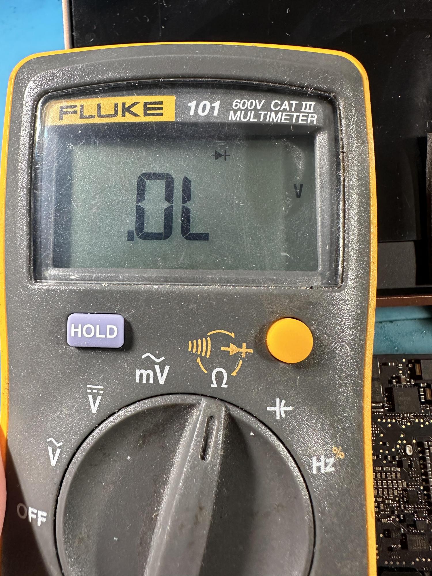

    i am working on macbook air 820-01958 that has water damage on connector J8500 around pin ppvout_s0_lcdbklt and dp_int_auxch_c_n and dp_int_auxch_c_p. i changed the connector but still no image and backlight.
    already checked there is no short to ground on this line.
    any suggestion will be appreciated.

          Measure the voltage to ground of the backlight enable pin. This will confirm if the logic board is requesting for the backlight to turn on or not.
          Note, for the backlight to enable, the display must be detected.
          What voltage do you measure for the backlight with the display connected?

              Measure the voltage to ground readings for:
              EDP_BKLT_EN
              BKLT_EN_R
              • kingskie
                • Oct 2014
                • 249
                • indonesia
                Re: 820-01958 no image and backlight
                Originally posted by mon2
                measure the voltage to ground readings for:
                edp_bklt_en
                bklt_en_r
                edp_bklt_en = 0.481
                bklt_en_r = 0.481
                  So the display is not being enabled.
                  Remove all power. Meter in resistance mode.
                  Check the resistance to ground of these same signal lines.
                        In post #8, missed that these are diode mode readings, not voltage readings.
                        Meter in 20v or higher dc volts scale.
                        Measure each point to ground.
                        • kingskie
                          • Oct 2014
                          • 249
                          • indonesia
                          hi @mon2, i set the multimeter as you can see from the picture and red probe to ground and black probe to the measurement point.
                          CMIIW
                          • kingskie
                            • Oct 2014
                            • 249
                            • indonesia
                            if you mean the voltage for these pins than all are 0V
