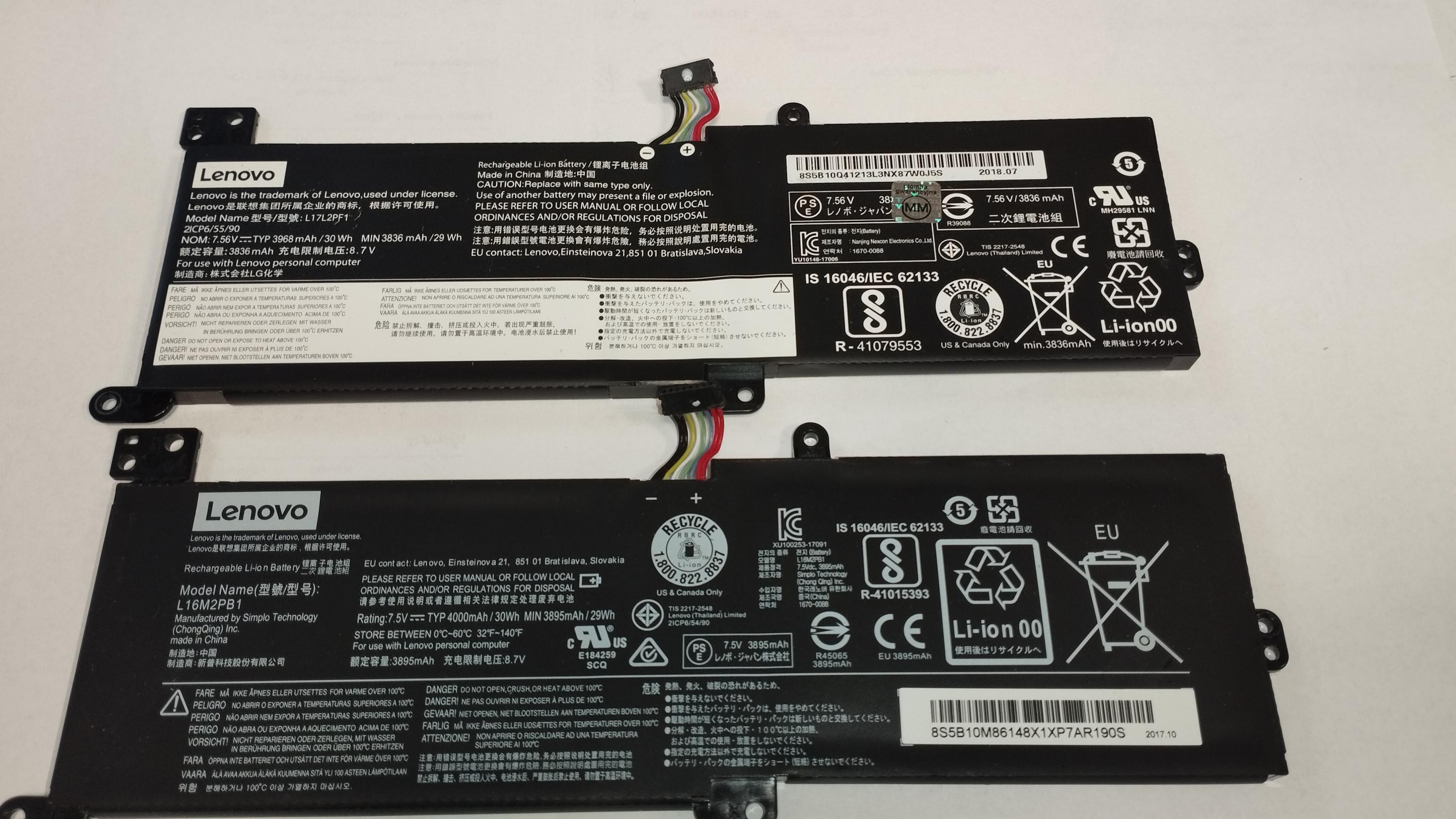

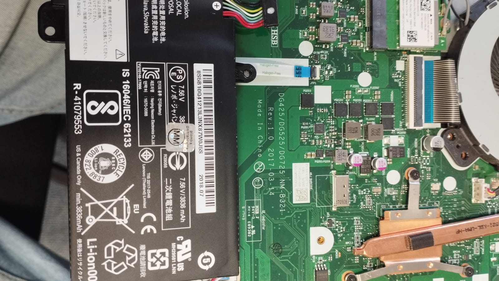

    Hi everone
    I have this craptop. AMD CPU. Motherboard model: DG425/DG525/DG725 NM-B321.
    After battery replace (it has wear level 96.5% - no charging at all) and screen replace it seems that this laptop is working, charging. OS installed, driver, bios updated, etc...
    But it does not work on battery, it turns on, ON button led and Num Lock led are on, fan spinning after while, but not screen. It's frozen. But if I connect charger then, it starts normally after short while.
    I noticed, that replace battery (it is not new, but used, wear level 45%, charging normally) is not same type and capacity as old battery was, but same shape and same connector. Can be this source of problem or it is on motherboard, some power good signal ?
    On photo is new battery, later I attach old battery.

    Here are both batteries on one photo, bottom battery is old, extracted from notebook before repair.
    Replacement battery:
    Type: 2ICP6/55/90 (L14L2P21), 3968mAh, 7,56V
    Old Battery:
    Type: L16M2PB1, 4000 mAh, 7,5V
    Can be source of problem in wrong battery ?

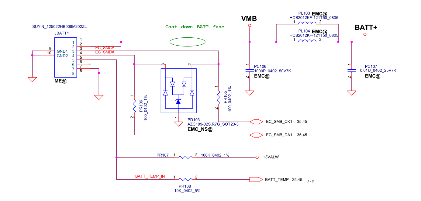

      See attached.
      Connect your power adapter and battery.
      Meter in DC volts (20v or higher is ok).
      Measure the voltage to ground of each pin on the battery connector.
      Post each measurement.

        Voltages are (AC In present, batt connected, power off or on have same voltages):
        1,2 8,5 V
        3 3,3V
        4 3,3V
        5 0,3V
        6 0V
        7,8 GND
        Voltages are (AC In disconnected, batt connected, power on):
        1,2 7,9 V
        3 3,3V
        4 3,3V
        5 0,3V
        6 0V
        7,8 GND

          On battery, when only power led is shinig, then there are these voltages values:
          +5VALW, on PJ605, 5,1 V
          +3VALW, PJ 602, 3,3 V
          +3VL and +3VLP, PJ603 3,3 V
          ALW_PWRGD, pin 9 from PU602, always 0V, even when succes boot, open drain output, position PR606 from+3VALW not used, resistance to 3VALW above 1mega ohm. Same on PU 601, seems taht board does not use this signal at all.
          APUALW_PWRGD 2,9V on batt, 3V on AC
          +APU_CORE, PL2202 0V, then ok

            Bios has code for battery support and not all battery with similar specs are supported by particular bios-So it may be the new battery is simply not supported by this mb bios. try with exact replacement before probing further.
