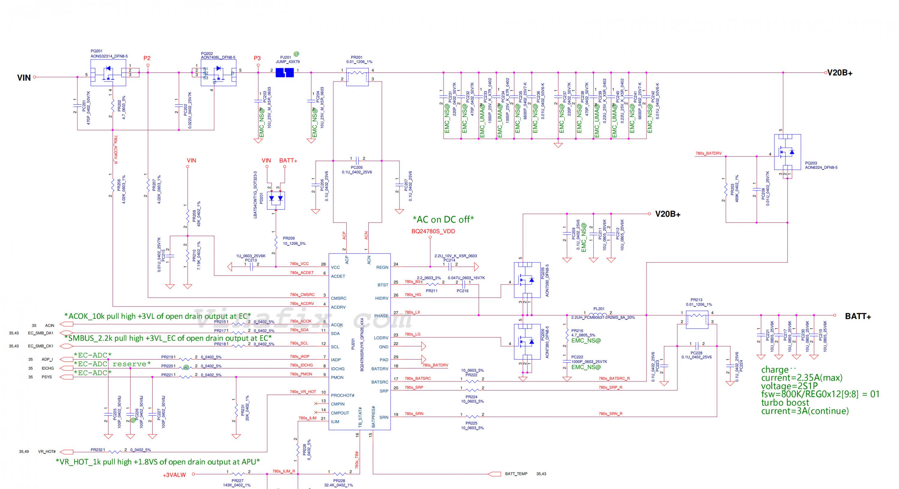

    hi guys i have this lenovo laptop model ideapad s145 motharboard : fs44a&fs54a nm-c171 rev 1.0, power on but no fan spin no display no vcccore no voltage on bios chip also on RAM but i have:
    +3VALW
    +5VALW
    +1.8VALW
    +0.775VALW
    +0.95VALW

    Re: lenovo nm-c171 no power
    schematic if needed
      Follow the power sequence on page 40 to see what voltages are missing.
            hello, I noticed that laptop it works with battery not with adapter but if I connect battery and adapter it doesn't work I noticed that the outputs +3VS_SW and +5VS_SW are missing with adapter in.
              Check the usual 2 x DCin mosfets.
              As a quick test - just replace the 2nd DCin mosfet (PQ202). This is the one that often gets killed.
                  hello the problem was in SUSP# line which is present on battery and not on adapter in i replaced Q6 and its working now tanks mon2,mcplslg123
