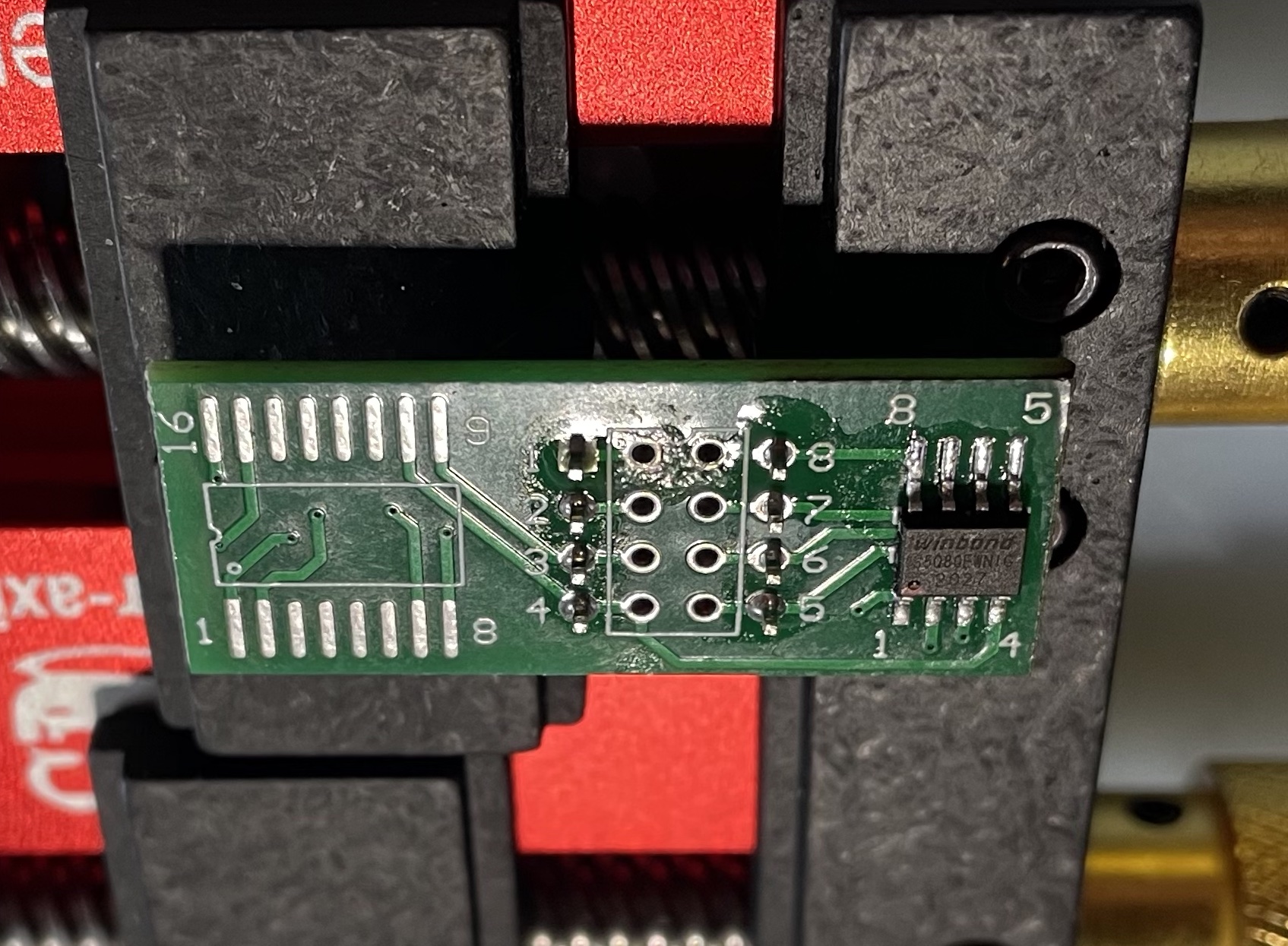

    Mon2, I was able to check the voltage on the bridge board is 1.8v. I have attached 2 photos, One show the full chip markings on the top and the other shows the chip mounted onto the adapter board that I then plug into the 1.8v bridge board, then into the CH341A. If I plug the adapter board with the chip on it directly into the CH341A it detects the exact chip, but says it's a 1.8v chip. Very strange.

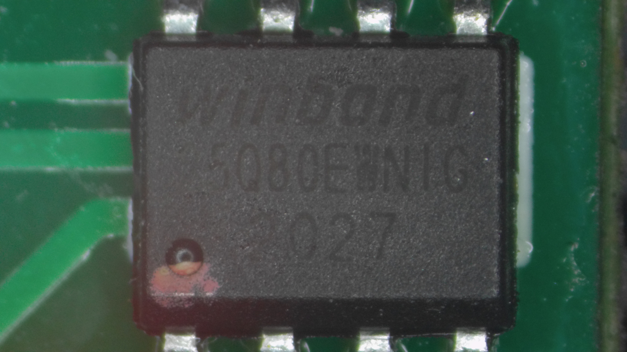

      The flash device is indeed a 1v8 rated part.

        Re: ROG G512li No power
        Thanks Mon2! I'm just confused as to why it won't work in the bridge board, but works straight up in the CH341A where it can be read perfectly. Could it have been damaged in some way?
          According to the datasheet and part number decoder, this device cannot handle a high voltage on the Vcc rail such as 3v3. That is beyond the max rating.
          If the low voltage bridge board is functional with other parts you have used in the past then can only conclude that this flash device is not stable to operate @ 1v8.
          You can try it but best to seek out a replacement of the same part. Grab a few. Check the fresh stock on the bridge board that operates @ 1v8. Does it work? Continue to flash your contents and verify again at 1v8.
          Finally apply onto your board.
            That makes sense to me for sure. I will order some new chips and see if I have any issues using the bridge board. I'll let you know once I have done that. Thanks!
              mon2 I was able to get the new chips. Although they are the same number the last 3 characters are not the same. The one I had ends in NIG and the new one in SIG. They look the same spec on paper, but the size profile is a little wider. Hope that's no an issue. Anyway, I am guessing my programer is fried as the new chips do not work in it either. Could there be any other reason for this? I have checked the adapter configuration schema several times and it is right, but still does not see the chip, new or old.
