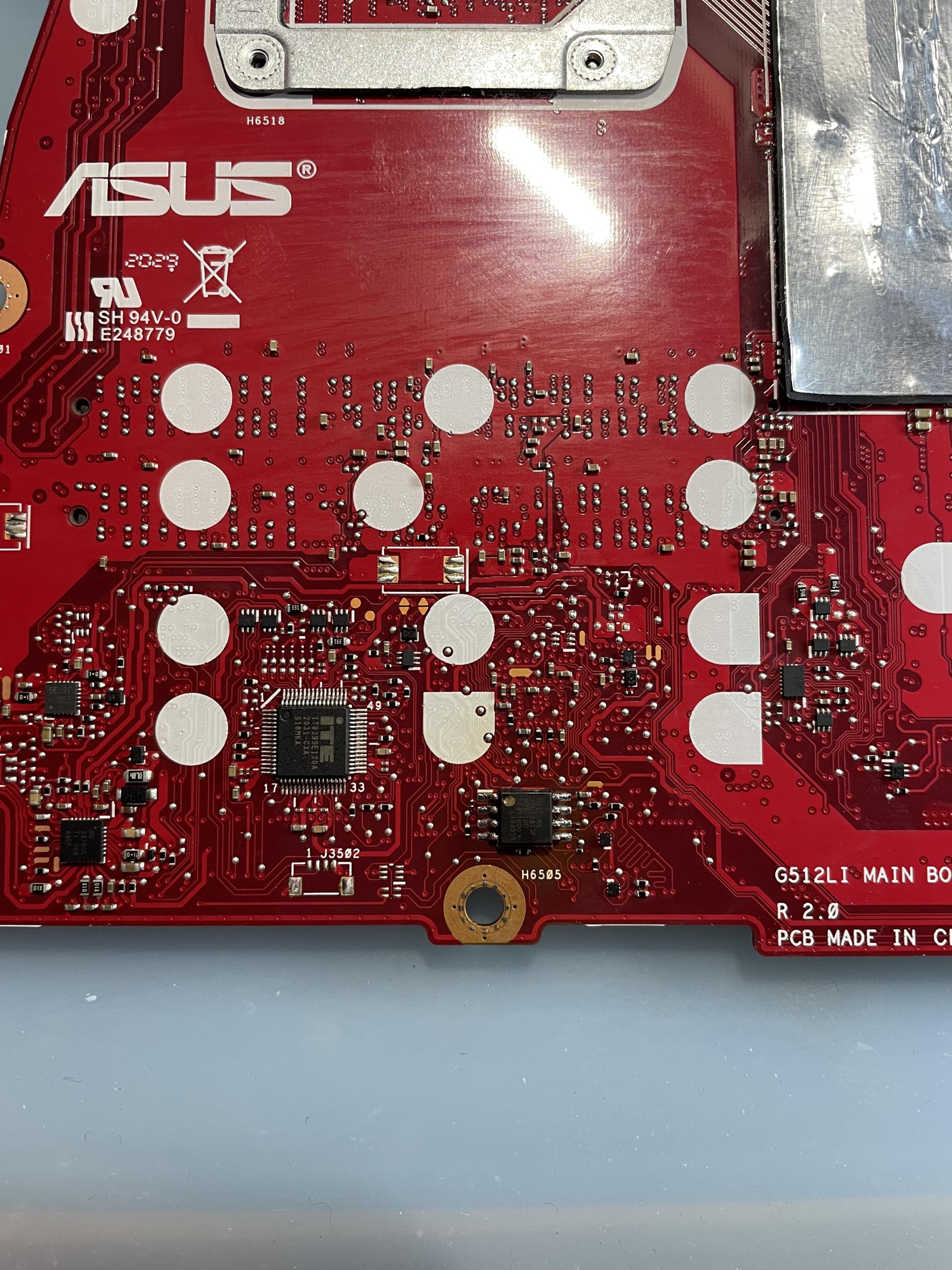

    Post a clear picture of the flash bios on the board.

      Here is a photo of the BIOS chip now...

        The soldering and orientation of the flash IC look fine.
        Which BIOS image did you apply?
        The same flash IC was selected in your programmer tool? Same density?

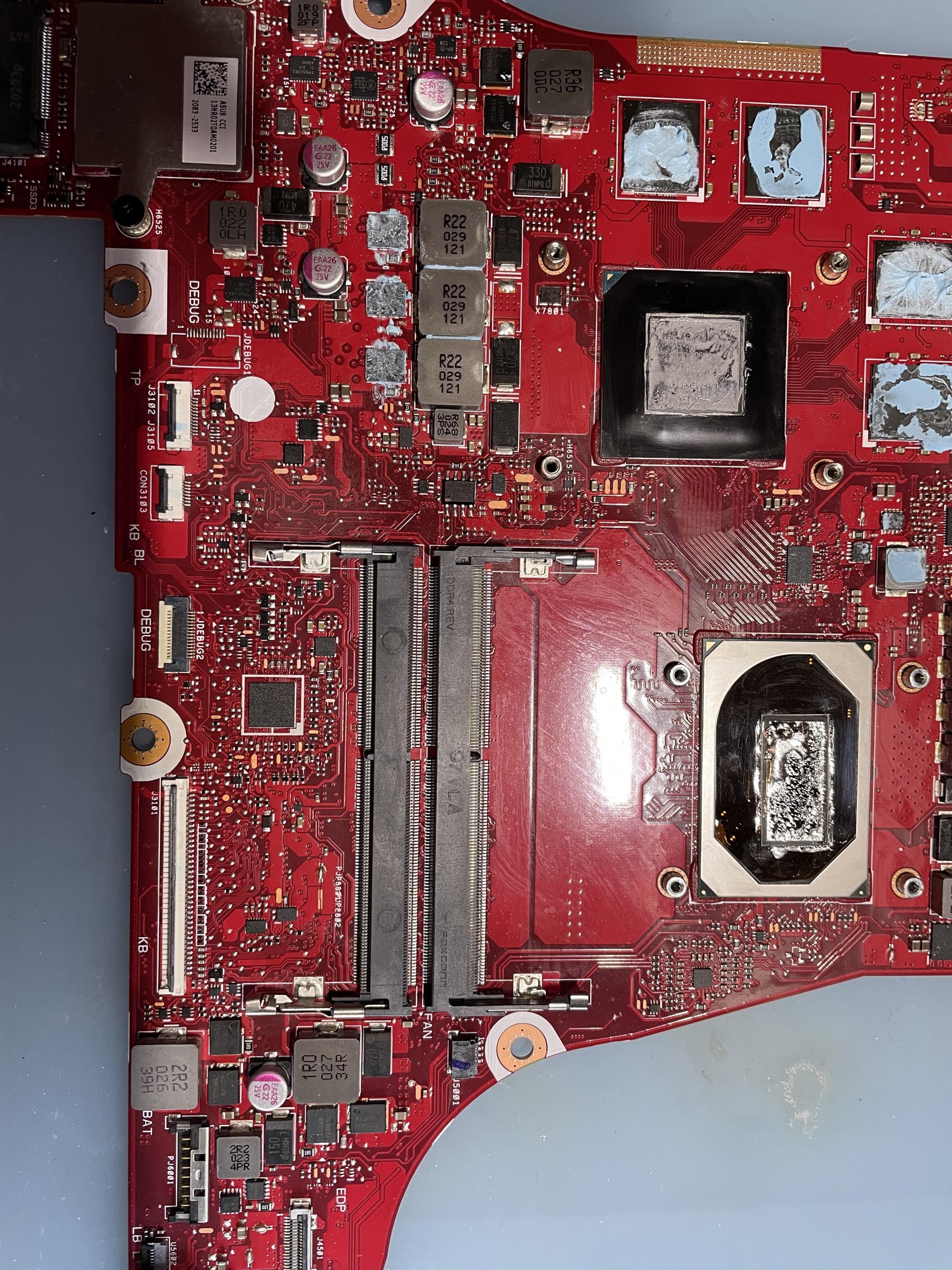

                                  My first inclination looking at your pictures is exposed liquid metal on the CPU. Make sure none of that got anywhere it shouldn't as it often shorts things out.

                                    Thanks for the info reformatt! Yes, I was worried that maybe a little liquid metal had made it's way onto the board somewhere, but after checking this board, up and down, under the microscope at least 20 times, I was not able to see anything. Hopefully none made its way under chip where I can see it. I have carefully cleaned off the liquid metal yesterday just to avoid any issues. I think it's a good point about the EC and not the PCH. Also, crazy thing is, I did remove the other winbond chip on this board at first as I thought it was the BIOS chip. I was able to read it and backup its content, but I never wrote to it. I am actually worried that maybe it became damaged and not sure how to check it though to see if it's ok. It's back on the board of course and nothing around it has been knocked off or anything. I believe it did power on when I first put it back on and it was only after writing to the Actual BIOS chip that it did not power up after I put it back on the board. When you say I should check the power input current, that would be great, but I'm so used to .brd files along with a schematic and there is only a PDF for a board that's not exactly the same. I can't use it to help guid me, so I'm not sure how I would find where to test the switch. Any idea what I can do to test that?
