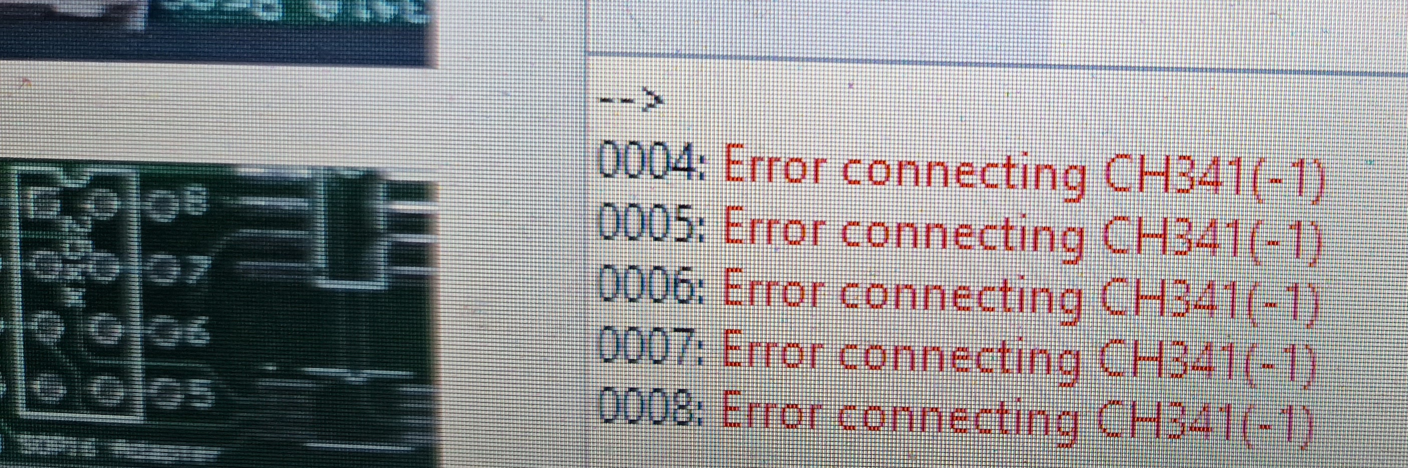

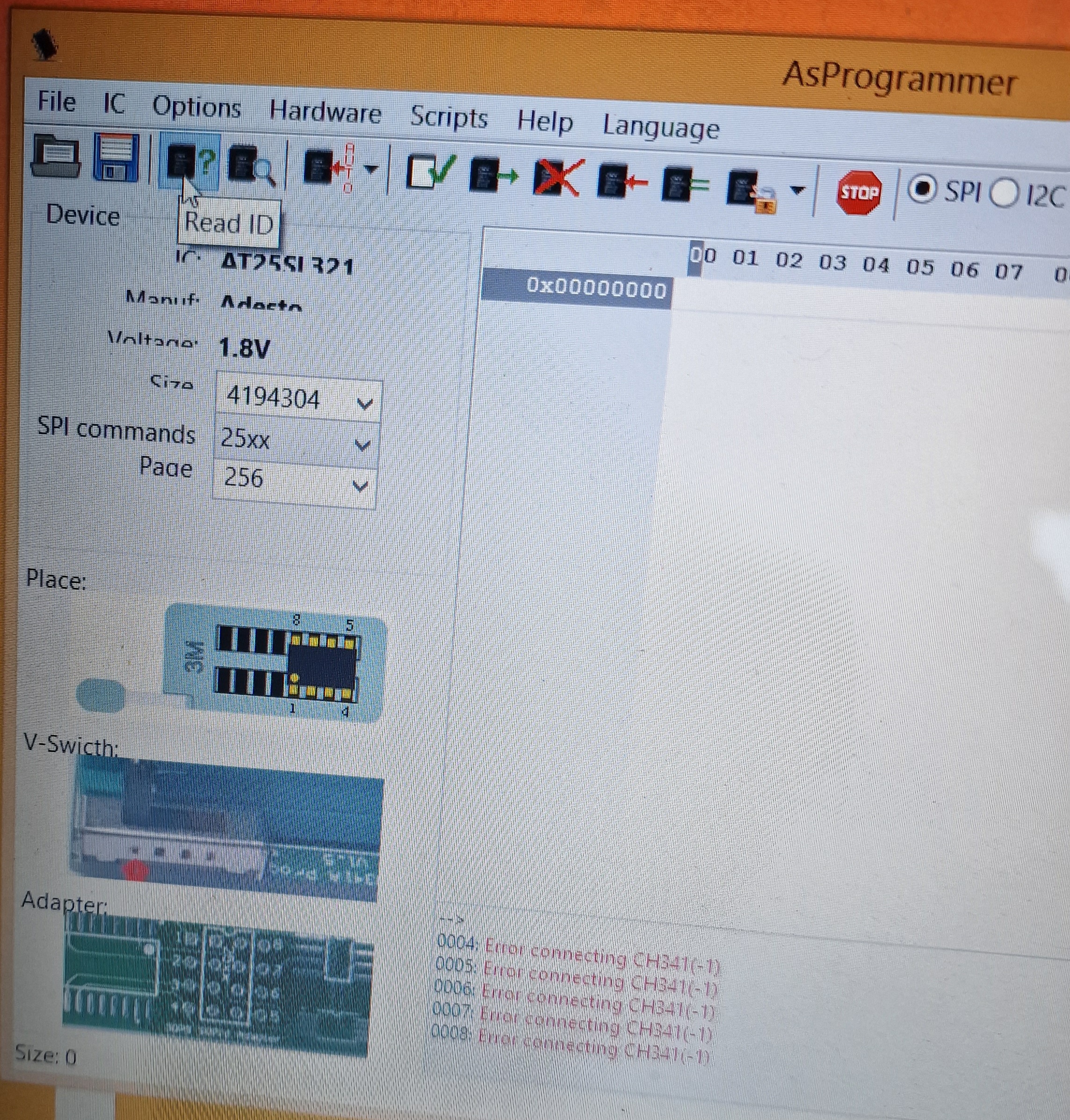

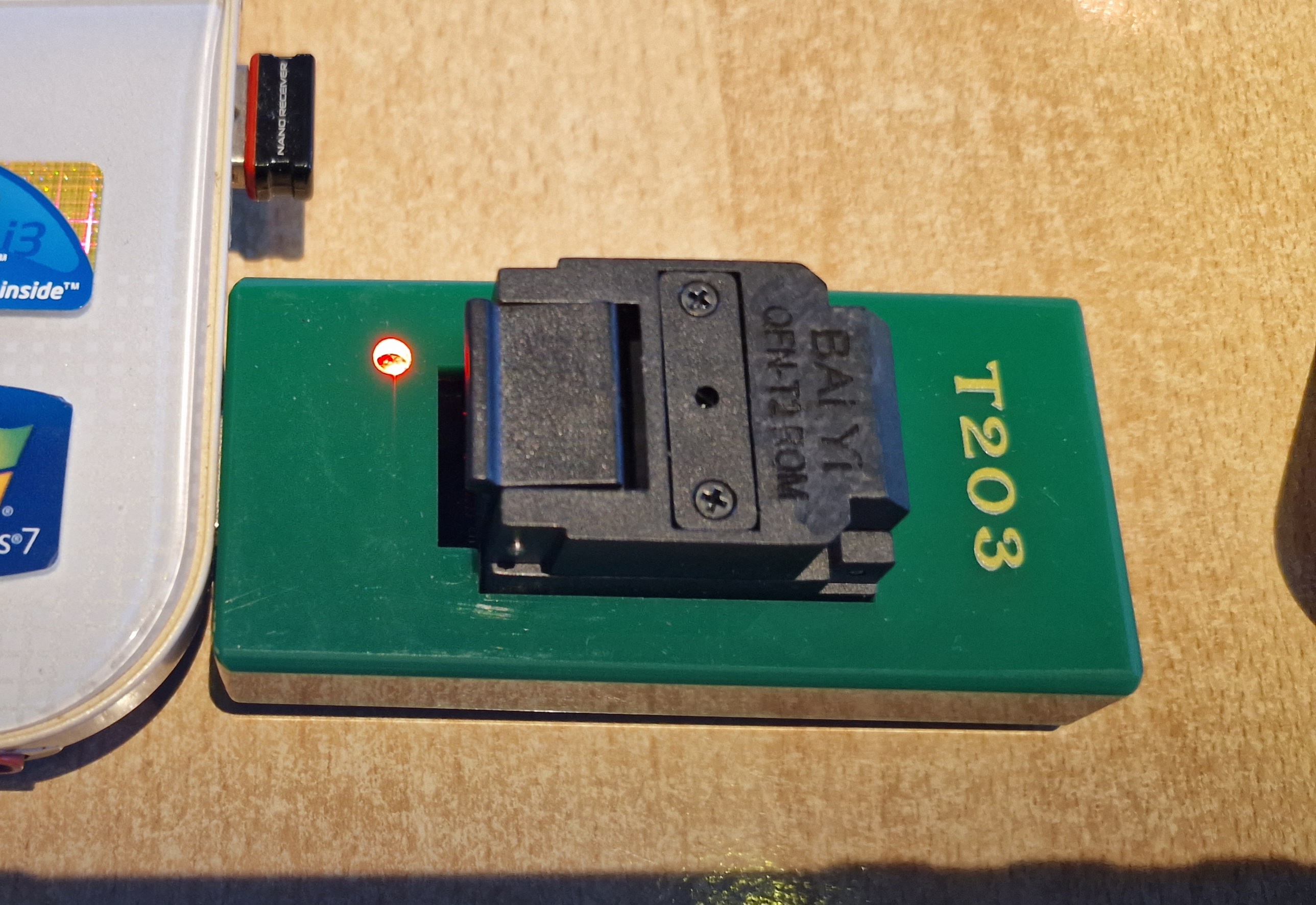

    I bought the T203 programmer and unsoldered the T2 ROM chip from the A2159 and put it in the T203. Then connected to Win 8 via USB AsProgrammer started and when I want to read it an error comes up! See pictures. I also tried it on Win 10.
    Hello, I have a problem. I unsoldered the chip from my Mac A2159 and put it in the T203. When I open As Programmer and click on Read ID I get the error message Error connecting CH341! What's wrong there? Please help. Thanks

    Remove all devices from the programmer socket.
    Then try to connect again.
    The fault is that the tool itself cannot be found.
    This has to do with the ch341 driver package.
    Confirm the usb cable; usb socket..try a different port on your PC; be sure the driver package from WCH is the latest.

      Hello mon2, yes I made it now. I was able to read and write to the T2 ROM. Apparently the serial number has been swapped. I did the restore too. But now I have to activate it or not? The Mina T2 Activation was not on the USB stick, I loaded it from the network, but it does not work. What else has to be done? Do I still have to pay for software to activate? I hope it's okay now? I bought the t203 and thought it would work with it? greeting
