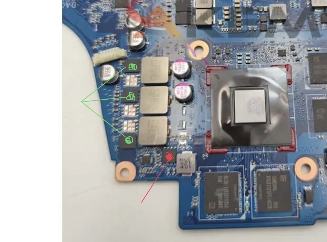

    Hi I need the reference of this mosfets I upload a photo.
    Green marked?
    Red marked?
    Thx in advance

    Re: Identify mosfets DAG35MMB8C1
    Are these mosfets stuffed on your logic board or are missing?
    Can you read off the topside markings if present on your board?
    Or share a close up clear pic of these parts.
      The board come from other service, and they removed this mosfets.
      I try found schematic, but I not have lucky, see others (like g35a, g35b) but in each schematic use diferent dual Chanel mosfets. Them I need help for get the correct ones.

        Are missing, the motherboard come to the other service and they removed this mosfets (they whant a sort circuit and not whant I found the driver mosfet sorted to ground…. But now need the model of this mosfets…)
          It's this one
          https://s.click.aliexpress.com/e/_DebMHzP FDPC5030SG
            i believe thats the memory gpu mosfet FDMS3669S according to the schematic.
            What is resistance to ground on that coil on the right while mosfet removed?
              hi, 90 ohm thx
                  Originally posted by extrexxx
                  hi, 90 ohm thx
                  the resistance is fine...probably not shorted gpu memory.
