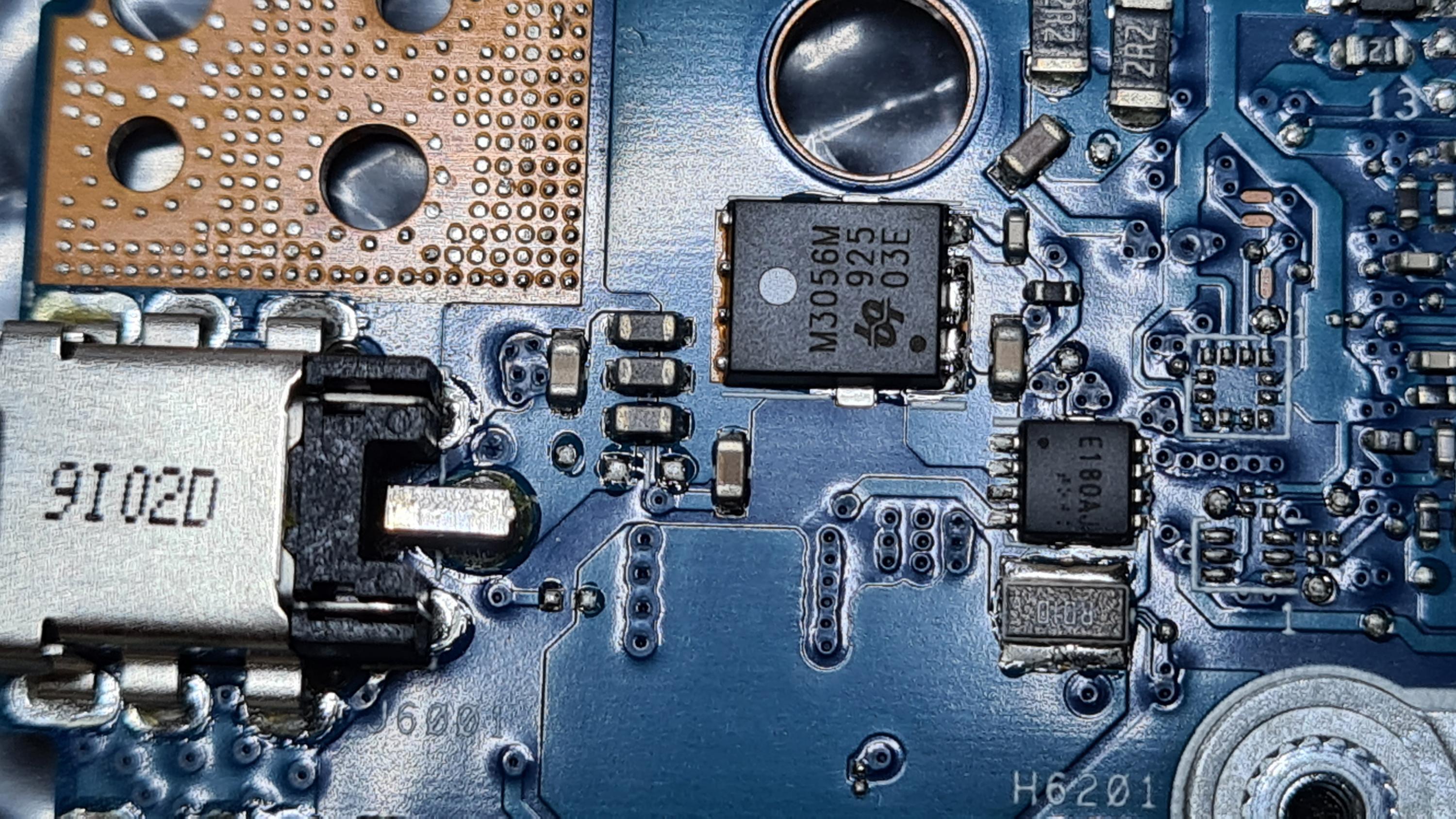

              Re: Asus UX334F - Not Charging
              I measured the MOSFETs next to the DC jack.
              M3056M - Drain 19v / 1-2-3 0 Gate 0
              E180AJ - Drain 2.16v / 1-2-3 0 Gate
              I attached image of the MOSFETs
                So gate voltage is not correct. It must be ~25v to enable.
                Locate the ACDRV pin on the charger IC and there is a 4k resistor in series from this pin to the gates of the DCin mosfets.
                Carefully flux and remove this 4k resistor. Do not lose the part.
                Then power up again and check the voltage at the ACDRV pin pad where you removed to resistor.
                Is the charger ACDRV pin to ground now ~25v ?
                As per the sticky by @Piernov, often the 2nd DCin mosfet gets killed and causes the ACDRV voltage to tank.

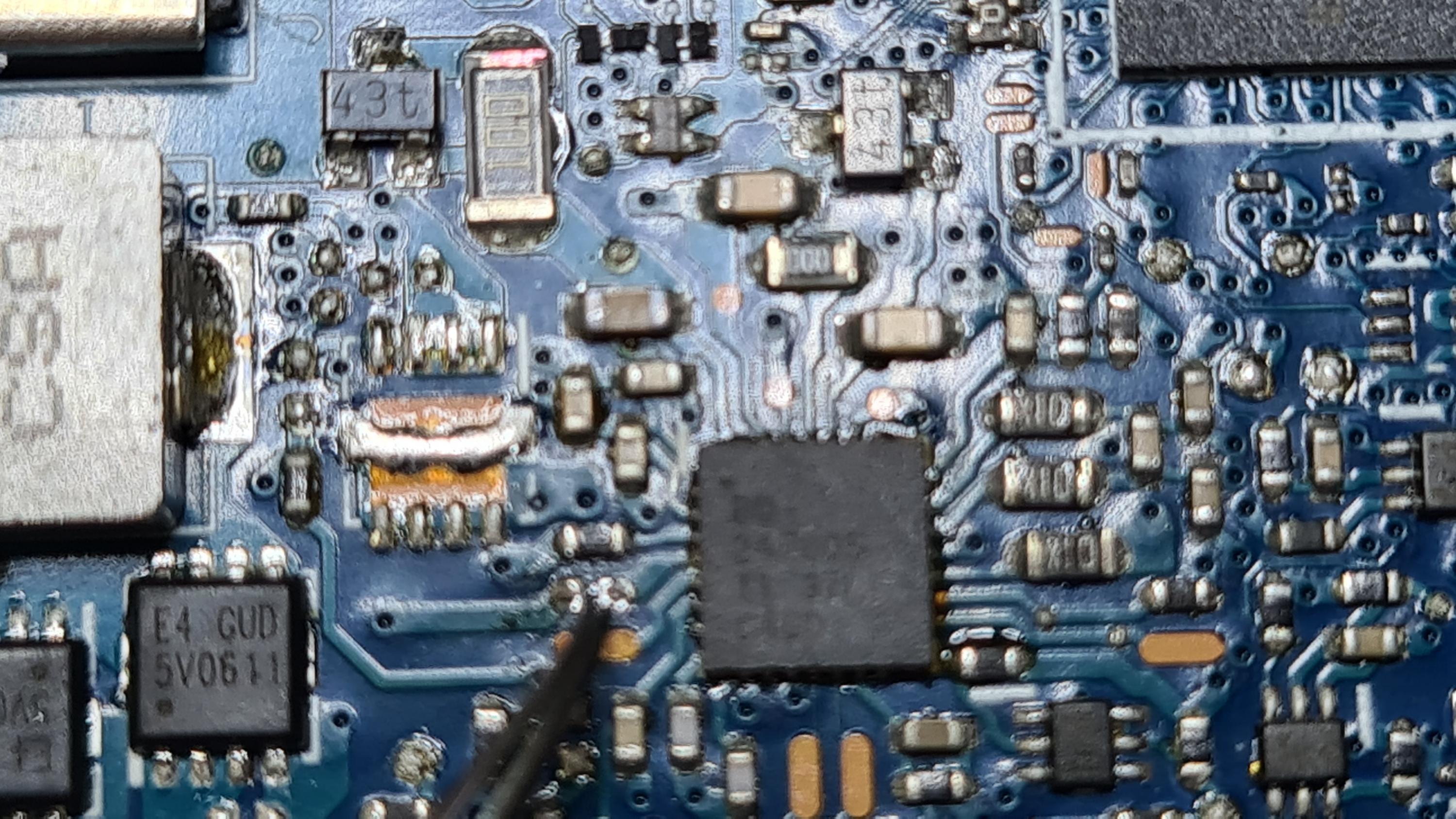

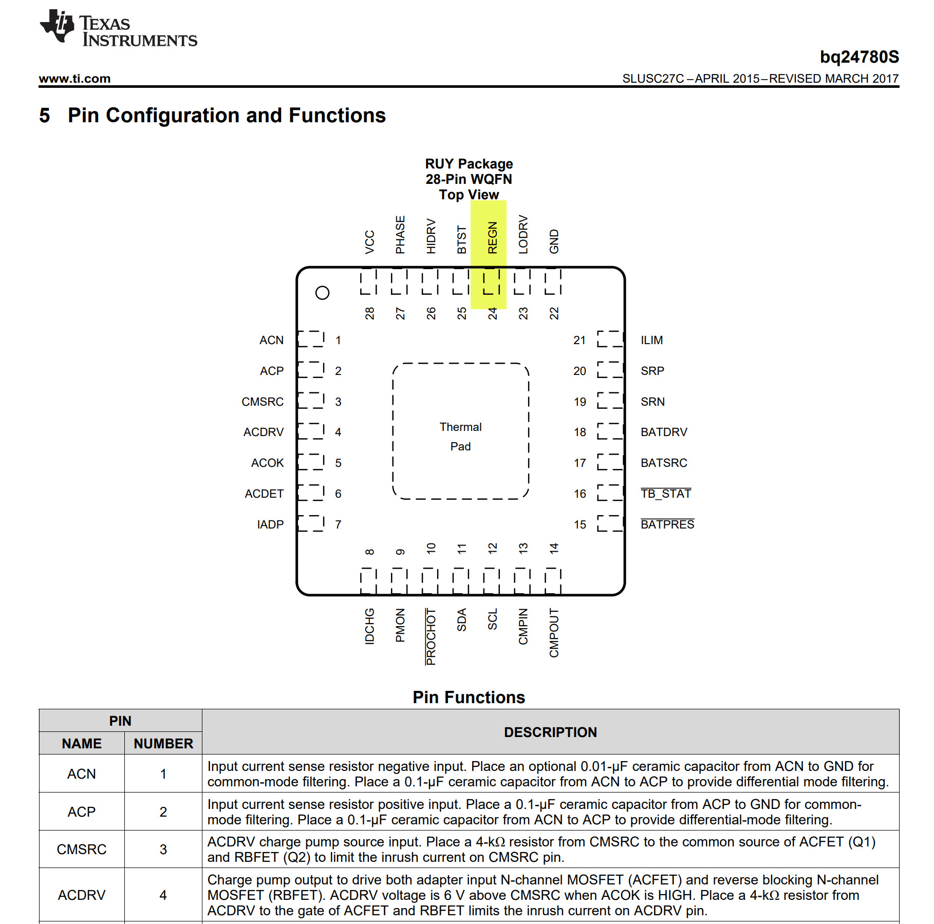

                    See attached. Measure the voltage of REGN to ground.
                    • Ado02
                      • Jul 2021
                      • 100
                      • United Kingdom
                      #30
                      1.19v
                        That is not a good voltage. REGN should be ~6 volts.
                        Then ACDRV = adapter voltage + REGN = ~25 volts.
                        At this time, best to measure each pin voltage on the charger IC to ground.
                        Post the list of values and their respective pin numbers for a review.
                        We need to be sure that the charger IC is being powered, etc.
                        PS: Measure very carefully since the power is active to the logic board.

                          #32
                          1 = 2.1v
                          2 = 2.1v
                          3 to 5 = 0v
                          6 = 2.6v
                          7 to 23 = 0v
                          24 = 1.2v
                          25 = 1.1v
                          26 to 27 = 0v
                          28 = 18.7v
                            Remove all power. Meter in resistance mode.
                            Measure the resistance to ground of the REGN pin # 24. The voltage should be ~6 volts which it is not so there may be a shorted component on this rail which is causing this LDO rail to tank.
                              M3056M
                              123-5678 = 1.3mΩ
                              567 - Gate = 1.3mΩ
                              123-Gate = 1.9mΩ
                              E180AJ
                              123-5678 = 1.8mΩ
                              567 - Gate = 0.73mΩ
                              123-Gate = 1.6mΩ
                              • mon2
                                • Dec 2019
                                • 13868
                                #35
                                These mosfet readings look ok. Based on the posted details, suggest to replace the charger IC. Aliexpress will have these. Recommend to also order spare mosfets that surround the charger IC as these parts are often the ones that fail.
