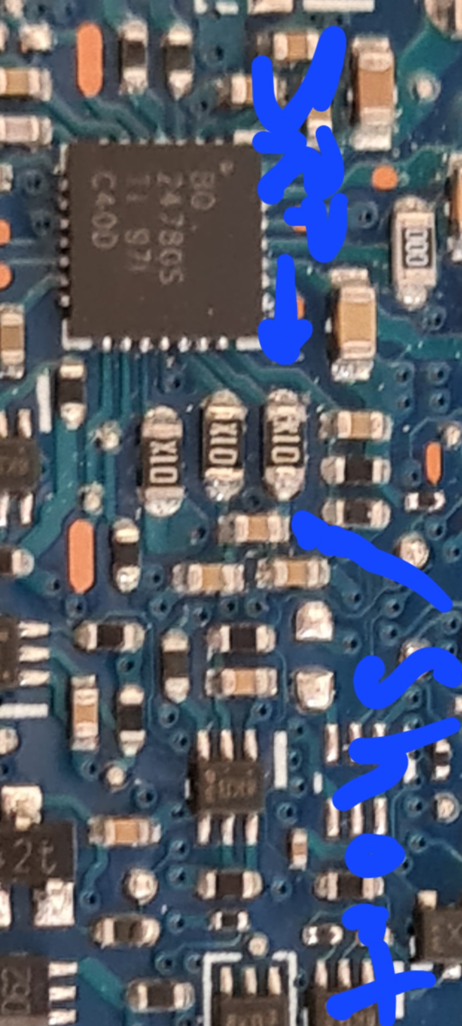

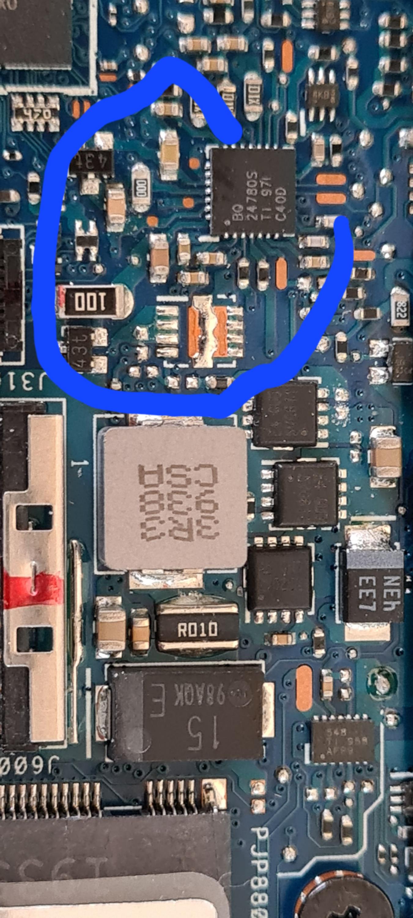

    I am trying to fix a charging problem on an Asus UX334F.
    When the charger is plugged in, the orange light comes on but starts to blink after 10 or so seconds. I replaced the battery, but this didn't resolve the problem.
    On inspecting the charging IC BQ24780S (charger plugged in) - LODRV is not present (with or without the battery) - Phase 11.7v with battery and nothing without / ACOK 6v with or without the battery.
    In the attached image, I circled the area that seems short to ground when the charge is plugged. However, as soon as you plug the charger out, the short go.
    I would be grateful if you could provide me with guidance on where to look next and how to resolve this problem.

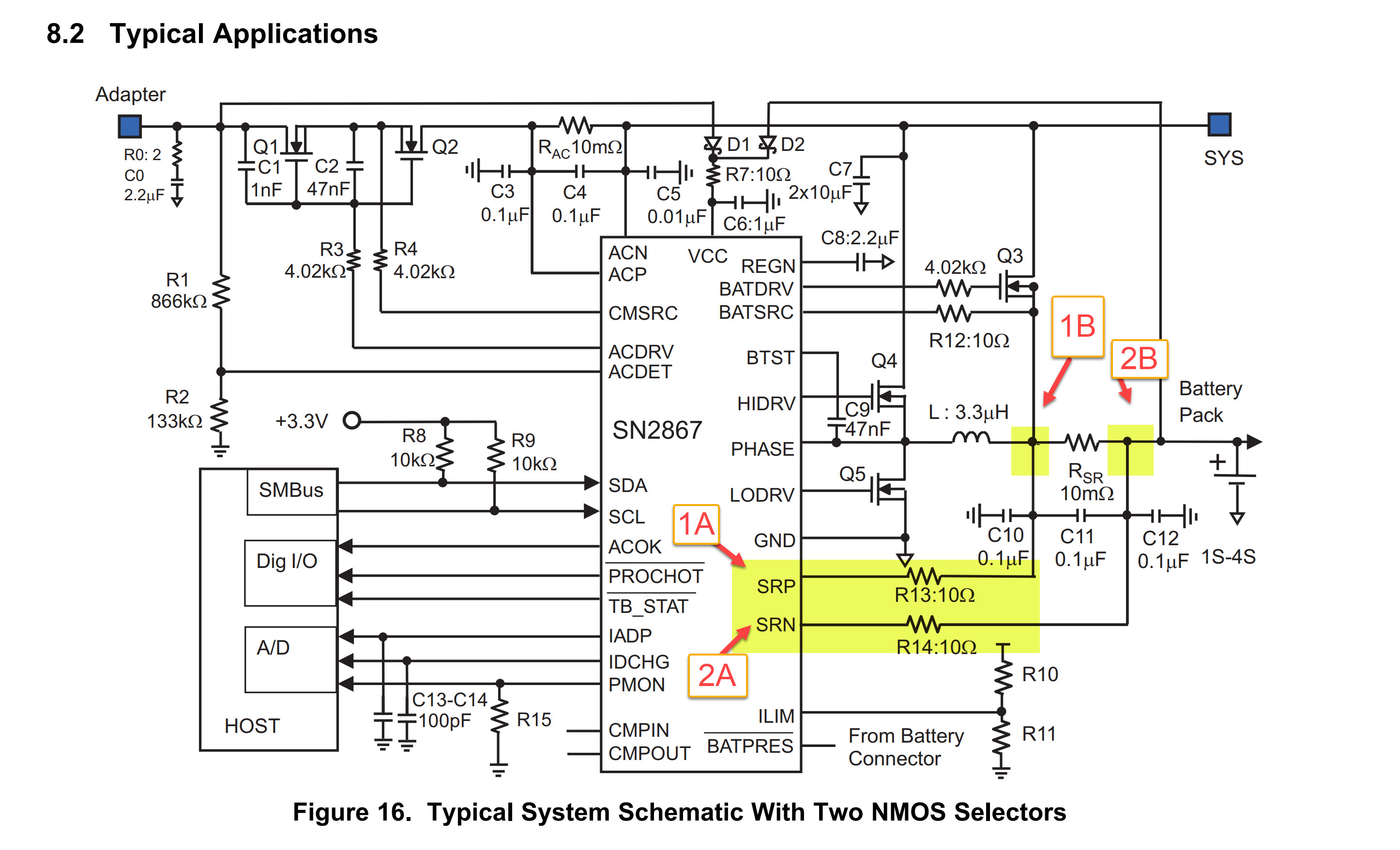

                    1) it is possible the battery is defective. Do you have access to another or is this a new battery?
                    2) it is possible that the current draw on the charging rail is too high so the rail is being shutdown.
                    3) the current draw will be deemed too high if the current sense circuit is not working properly.
                    Review the attached partial reference schematic.
                    Remove all power -> meter in lowest resistance scale.
                    Measure the resistance from the IC pin 1A to 1B - what is the reading ?
                    Measure the resistance from the IC pin 2A to 2B - what is the reading ?
                    The current sense path (above) must be present and similar to the attached schematic - engineers often clone the ref designs so Asus will be the same or very very similar. If one of these legs is broken, the charger IC will not gauge the current sense properly and shut down the charging process.

                      I am sorry, but I can't figure out the test point.
                      Can you point me in the right direction on the attached image?
                      Pin 20 is SRP - the CAP after the resistor is shorted while the caps next to it are fine.

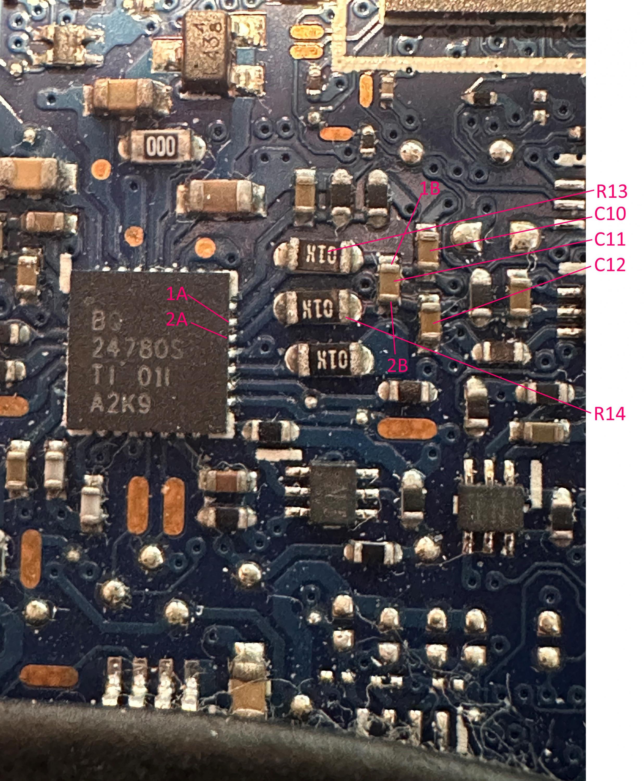

                              Dear Mon2,
                              Thank you for the thorough explanation. With your drawing I have measured the resistances as you recommended. However I did not identify Rsr yet (drawn between 1B and 2B). What I measured:
                              Between 1A - 1B: 10,2 Ohms
                              Between 2A - 2B: 10,2 Ohms
                              Between 1B - 2B: 0,2 Ohms
                              Could I have a shorted C11? It 's actually the same situation as Ado02 discovered on his motherboard.
                              Or do you have another suggestion?
                              I attached a picture of the situation on the MB.
                              Thanks again!

                                The readings look good.
                                You should also check the complete current loop resistance with a meter probe on 1A and other probe on 2A. This will validate the loop is complete. Should be @~20 ohms.
                                If you remove the adapter and mate the pre-charged battery, does the laptop boot like a normal unit?
                                What is the history of this laptop? Any liquid damage? Or just failed to work one day?

                                  1A-2A measures 20,6 Ohms (sum of the 3 measurements in the loop).
                                  The laptop indeed boots like a normal unit with the pre-charged battery.
                                  History of the laptop is that the original battery did not charge anymore and it had grown so big that the keyboard was lifted up. My 15y old son didn't tell me, only after the teachers at school said he needed to have his laptop fixed because it should run on batteries. When I saw the situation I immediately removed the old battery and ordered a new one from Amazon.
                                  No other accidents with the laptop, all seems to work fine except charging which stops after a few seconds.

                                    Now I see that this Rsr in the schema you posted measures 10 milli-Ohm, which explains why C11 looks shorted.
                                    I haven't found it yet on the board, but it will probably be there.
