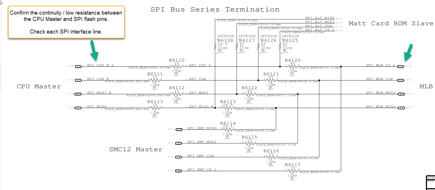

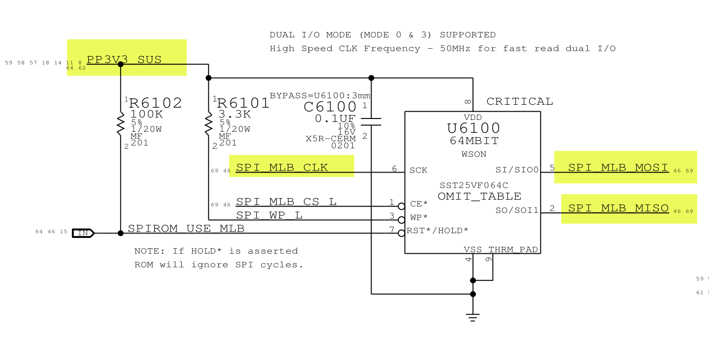

                          Review the voltage to ground of each of the highlighted pins on the SPI flash device @ U6100.
                          • dclass-pro
                            • Dec 2022
                            • 157
                            • Italy
                            #33
                            Re: Macbook A1466 No power
                            all 3,324V

                              Confirm the low resistance paths for each SPI flash interface pin between master and U6100 slave device.
                              • dclass-pro
                                • Dec 2022
                                • 157
                                • Italy
                                #35
                                I already checked all resistors and they are correct
                                • dclass-pro
                                  • Dec 2022
                                  • 157
                                  • Italy
                                  #36
                                  I also checked the lines and there is continuity

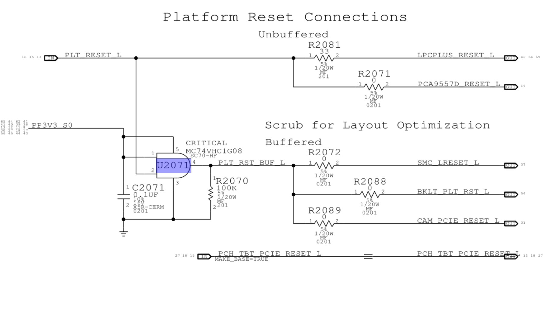

                                        Check if you have U2071 onboard (SC-70 single AND gate).
                                        If yes, measure the voltage to ground of pin 1, 2, 4, 5.
                                        List each measurement.
                                        • dclass-pro
                                          • Dec 2022
                                          • 157
                                          • Italy
                                          #40
                                          not have U2071 onboard
