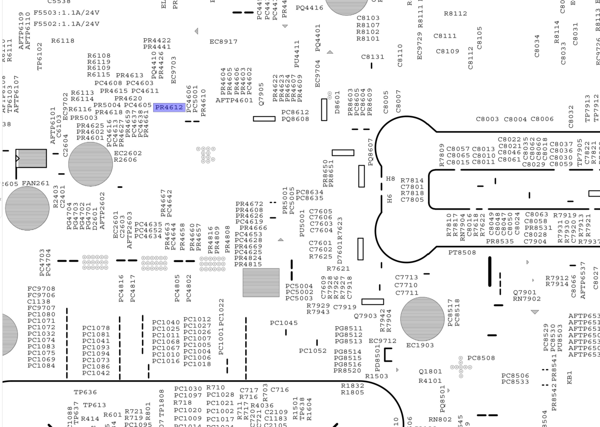

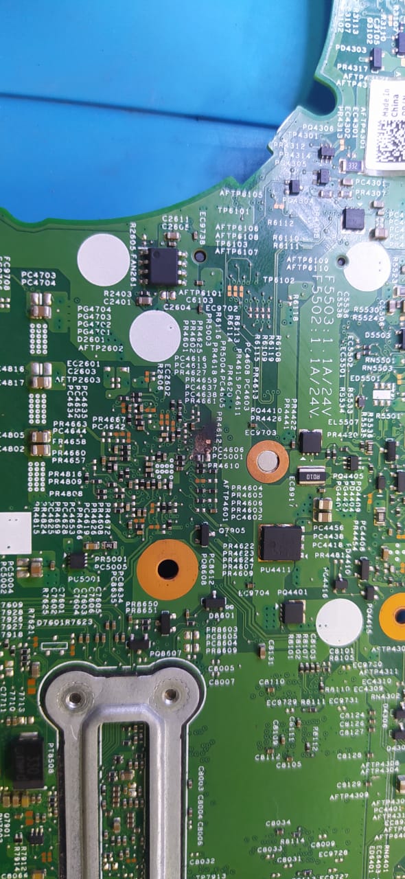

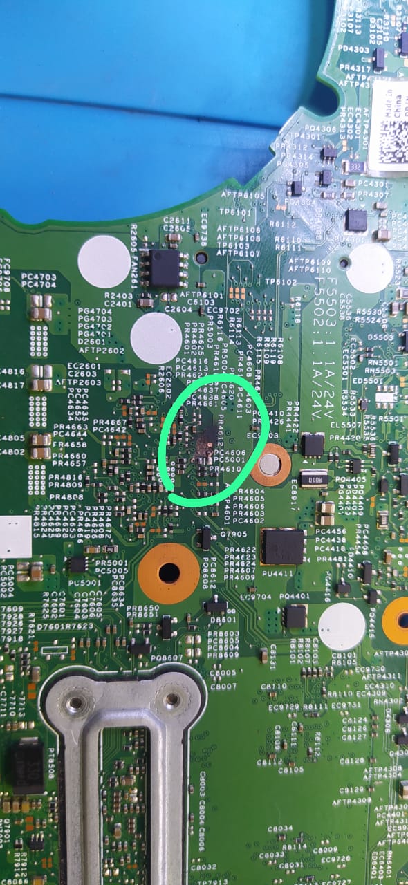

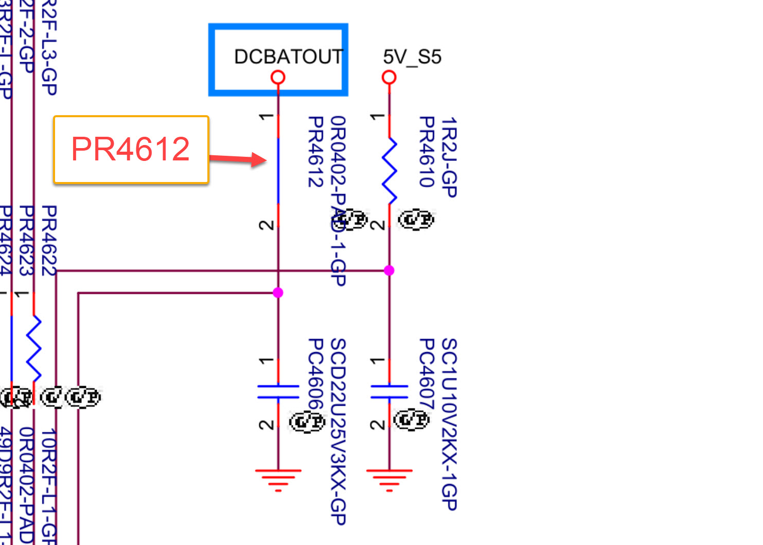

    need Inspiron 15 3576-i7-8g mother board image
    The part of this motherboard shown in the photo is burnt. If anyone has a clear image of the motherboard in this section, please send it. thank you.
  • mon2
    • Dec 2019
    • 14198
    Re: need Inspiron 15 3576-i7-8g mother board image
    Attached.

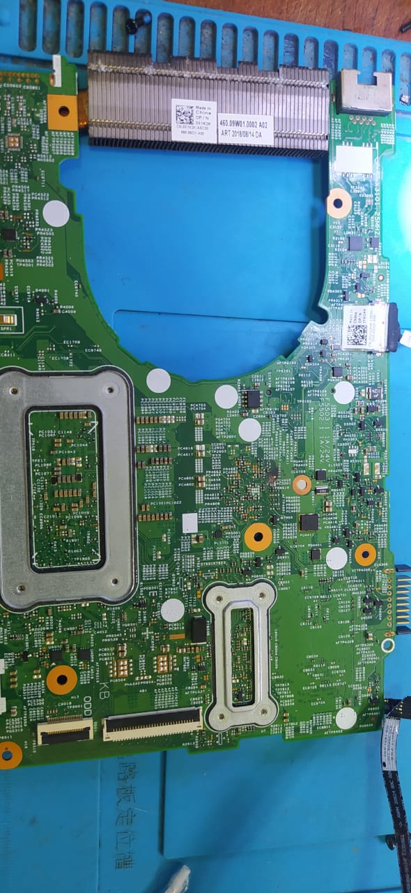

      thank you.can you send motherboad pic.
      • mon2
        • Dec 2019
        • 14198
        Sorry but do not have them. These are screen grabs from my paid sub.
