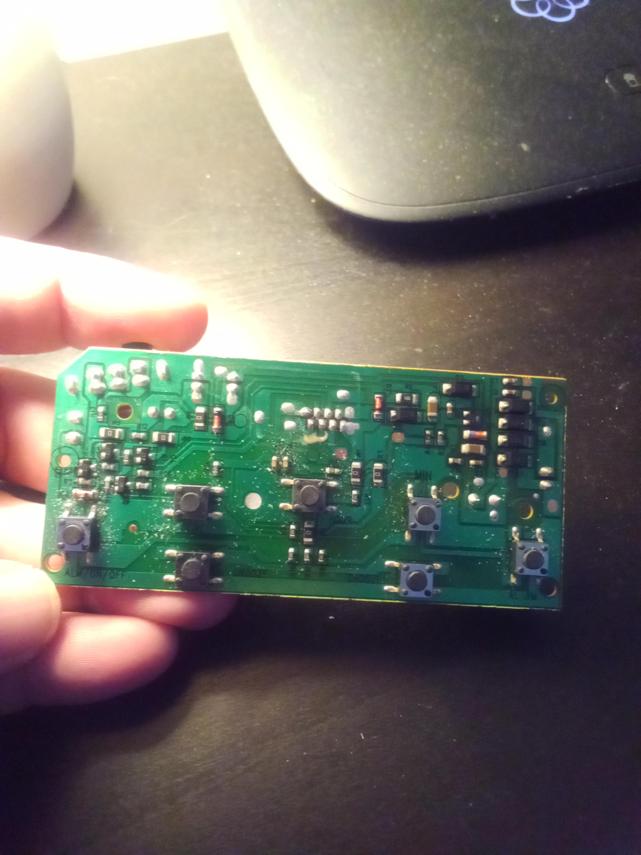

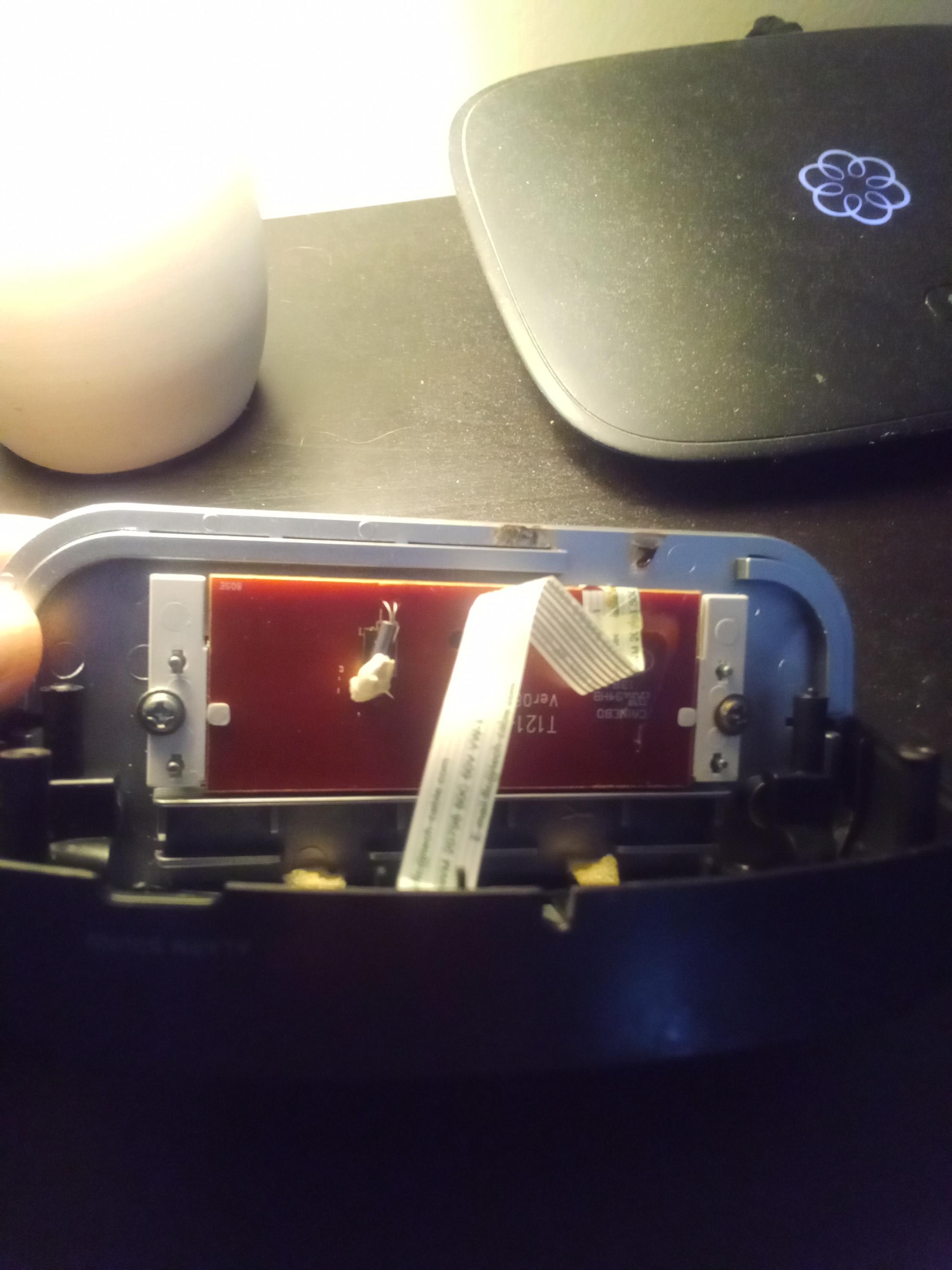

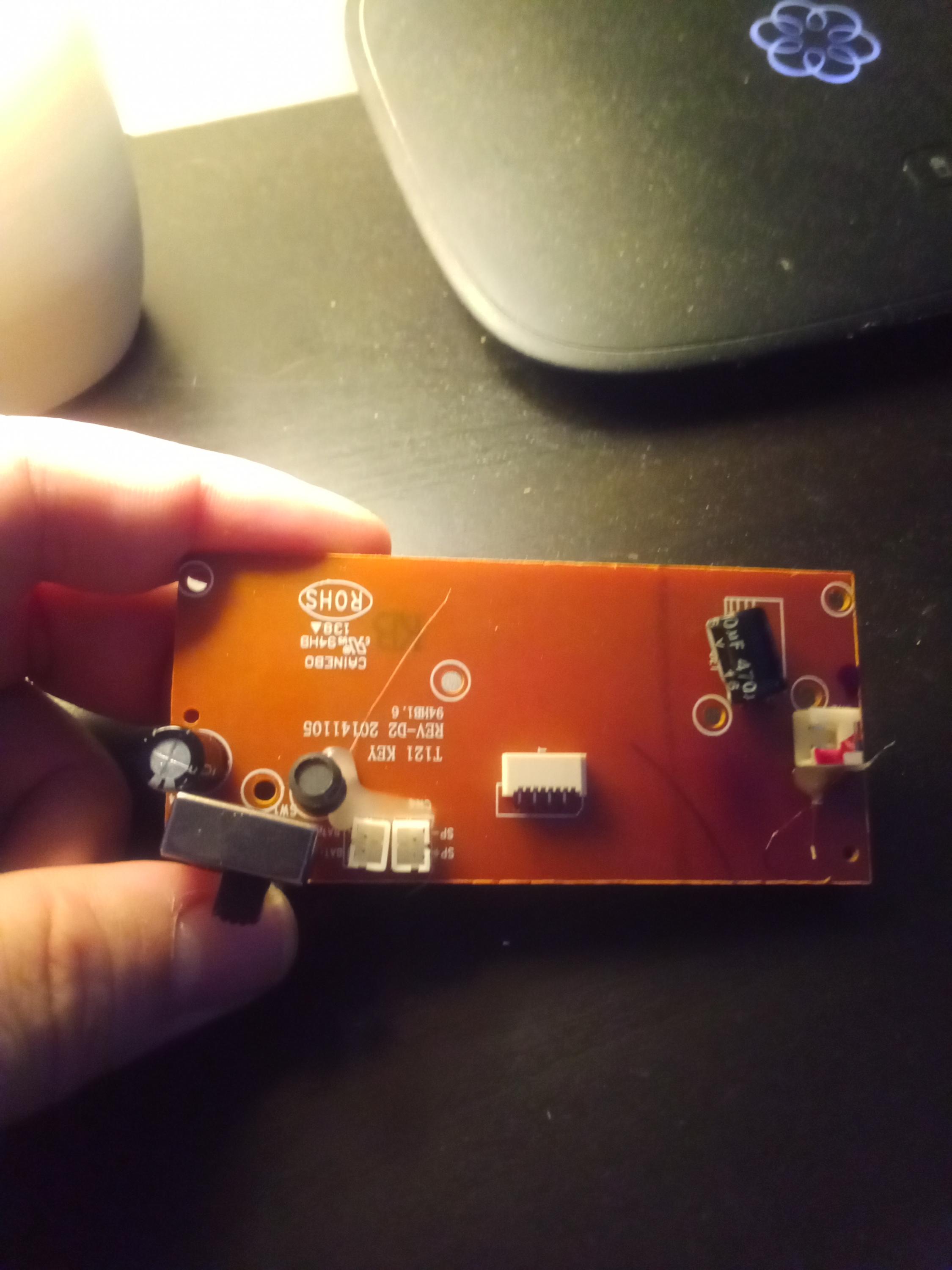

    I picked up an old school Timex T121 desk clock from a garage sale. It runs fast, it picks up about a minute or 2 minutes a week.
    I wanted to see if there was some sort of crystal or something I could replace that would correct that. I opened it up, however I don't see any type of crystal on the board, although truth be told I am not sure what I am looking for. The only thing that looks like a crystal is a small silver cylindrical component, but that is on the LCD board, not the main board, so I don't think that has anything to do with keeping the time.
    I know some old digital clocks ran off counting the signal of your mains voltage vs using a crystal, how can I tell if this is that sort of clock and if so can it be adjusted? And from my understanding those types of clocks there only are off a few seconds a month.
    Pics of both sides of the main board and the back side of the LCD board (still in the housing)

    does the metal cylinder say 32.768 on it?

          Ahh much better pics But this is mains powered? I would check the electrolytic capacitors, I have seen alarm clocks run fast counting extra pulses due to noisy DC power from old caps.
          The other side of the board with the crystal, would have to see a pic for what tuning caps if any are there.

            I checked the caps, they are all fine
            No marking at all unfortunately.
            One thing I realized, the internet tells me some of these older clocks work off the phase of the mains voltage, I had this plugged into a battery powered UPS, maybe that was throwing that off? I unplugged it and plugged it into a wall outlet and it seems fine so far although its only been a day

                The UPS must have been it, ever since it's been plugged into the wall it is keeping accurate time (so far at least)
