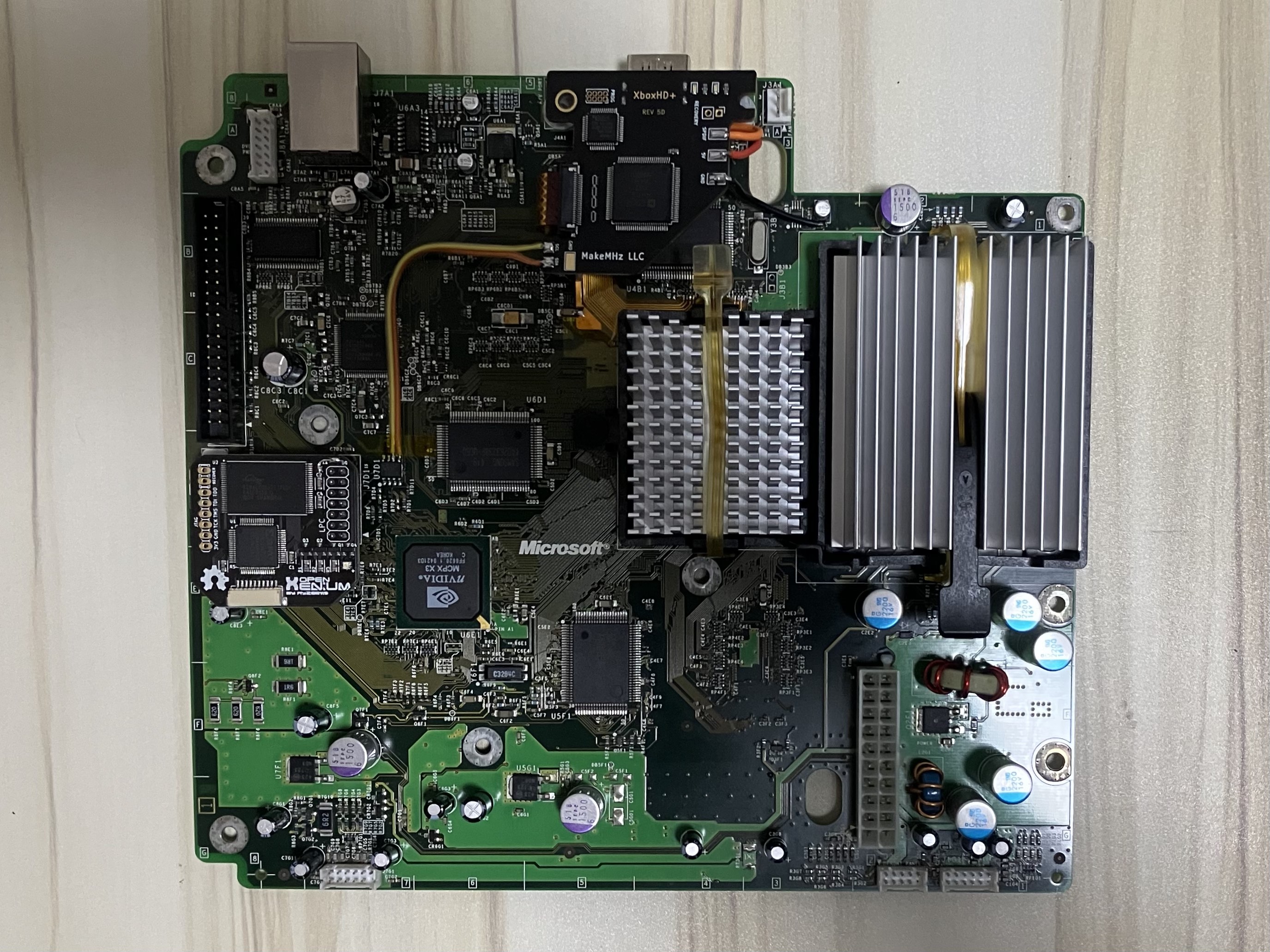

    unless there is a jumper on the board or something, i dont know why you couldnt flash an Aladin
    i will say though, i prefer the 1.0 - 1.5 models for this reason.

      Recent Aladdins come with a different chip on them, so you can't flash them unless you have an external programmer.
      Pain in the arse because it means it's another piece of equipment that I have to buy.
      I don't usually mind buying tools, but an eeprom programmer is not something I'll ever likely use again once I've done the initial flash.
      I'll probably end up buying one though because the Aladdins can be bought for less than $10. The Open Xenium chips are starting at around 40 to 50 not including shipping.

        i dont know how your flashing them, but there are several tools
        i used to install Linux, and then from linux i ran a flasher called "raincoat" or something like that.
        it recognised a hell of a lot of chips and could be updated because the chip details were in a text file i think.

            i'm talking about in the xbox - use xbox-linux
            https://github.com/not404/raincoat
            do you know the chip partnumber?
            https://github.com/not404/raincoat/b...c/flashtypes.h

              I think the new Aladdins contain this chip:
              SST49LF002A
              which, supposedly, can't be flashed without an external programmer.
              I think I read it on this thread:
              https://www.reddit.com/r/originalxbo...less_you_have/
              SST49LF002A does appear in the raincoat file. So does this mean that these chips can be flashed while in the Xbox?
                • 31218
                Re: Xbox 1.6 Motherboards and Polymer Capacitors
                yes, if the id is in the file it can flash it

                                Digikey took so long to deliver the caps (over a month) that when they finally arrived I didn't have the time to fit them.
                                I'll probably do them over Christmas when I get some time off work.

                                    Hello stj and everyone else!
                                    Finally had the time to do some work on one of the Xboxes I accumulated over the year.
                                    Replaced the CPU and PSU caps with the polymers I listed previously, and they work a treat. Also removed the clock cap and replaced it with a normal 16v 470uf electrolytic.
                                    The 20-year-old caps were actually all in decent condition. All showed correct capacitance and the esr was very low - pretty much the same as the new replacement polymers.
                                    Decided to fit an XboxHD+ as well, because the good HDMi adaptors are either out of stock or even more expensive than this board.
                                    Thanks again stj and everyone else who helped me with this. Couldn't have done it without you!
