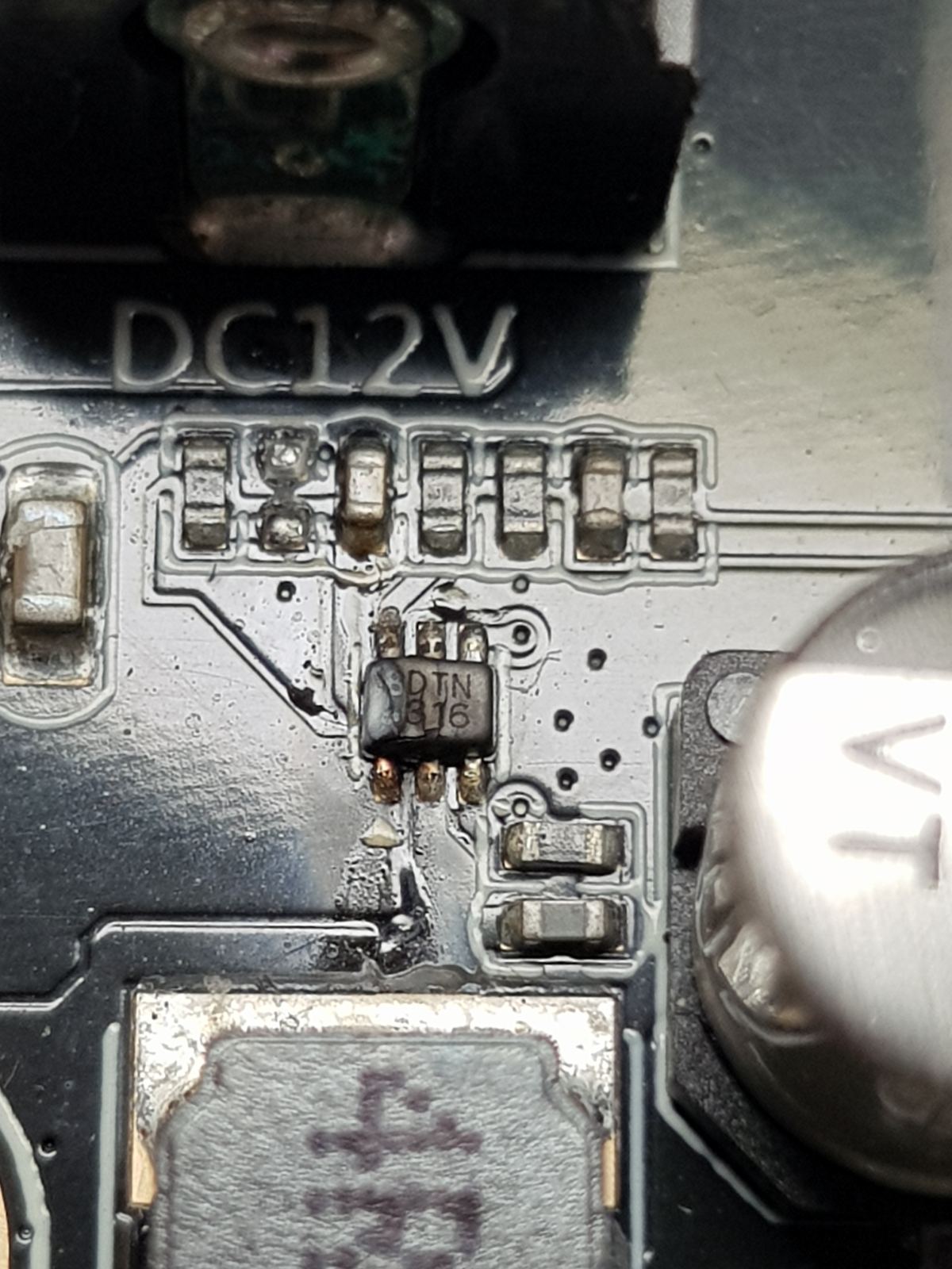

    Greetings!
    Can someone help me identify this burnt component on Bobcat 300 helium miner. Thanks!
  • Opacky
    • Oct 2021
    • 8
    • Serbia
    Re: Bobcat 300 helium miner
    https://www.monolithicpower.com/en/mp1658.html
    I ordered this and it is working ok...so if anyone need this information here you go.
