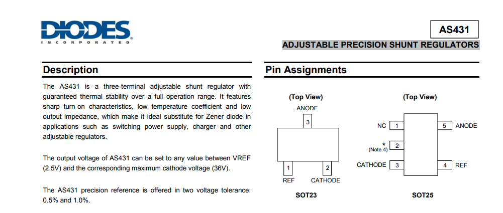

    Hi guys!
    I'm in needing to identify a burnt component on a power supply model ADP- 240AR AA . Photo attached and marked . Any advice on replacing ? Maybe testing something before turning it on ? . Thanks !

    Re: Help identifying PS4 power supply component burnt
    My first guess would be a smd version of a tl341 reference ic
      • 31087
      just a guess - given how close it is to the opto isolators - maybe a TL431 reference.
          This may help as well
            Thank you all guys for your answers . I've found this but idk if it is accurated https://eletronicabr.com/forums/topi...v-em-stand-by/
            He Says that maybe is a lm431
              • 31087
              well there you have it, if 3 people say 431 then it probably is
              but i'll say it again - they shouldnt explode.
              so check for other shorted parts - specially the optocouplers
              btw, the letters TL, LM etc change depending on the make, but all 431's are interchangeable
                They are interchangeable, but may have different pinouts.
                  Hehe sorry I'm a bit dumb , just trying to learn . Tested dnp012a and seems broken , some legs shows continuity with ground, removed and there is just one leg to ground left . Going to purchase required parts to see if power supply comes to life, will post results soon
